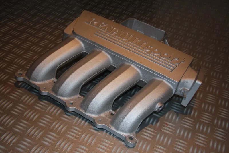

Just wanted to brighten up my engine bay up, going to engine cover painted and was wondering if its possible to paint inlet manifold?

It's just metal mate, well easy to paint, just try not to get paint in any inlets. I polished mine, lots of elbow grease needed to diy it tho! Just find a decent primer and you should be fine to paint it any pretty colour you want
Wire brush on a drill to get rid of most the burrs, then some wet and dry sand paper, just kept using finer and finer untin it's mirror finish, the fuel rail protector thing is the easiest and is best to start on if you wana try yourself, you end up with sore fingers after it all though. There's someone on here though who knows a company in Nottingham thatl polish it, just can't remember who that was.

They look like new/clean parts, a wire brush drill bit will do that if yours is in need of cleaning up
it's high temp paint, no primer needed (done that before, it doesn't go hard LOL) de-greased in the part washer, then a wire brush, blast off with brake cleaner, then a few coats of paint
