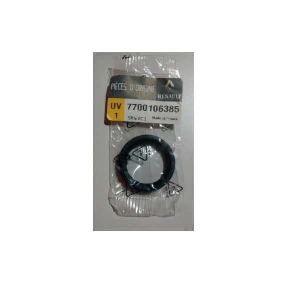

I did the dephaser solenoid seal too.
And wrapped some ptfe tape around the map sensor seal and air inlet temp seal, bit pikey I know but the sensors hadn’t failed they were just letting a bit of air through.
