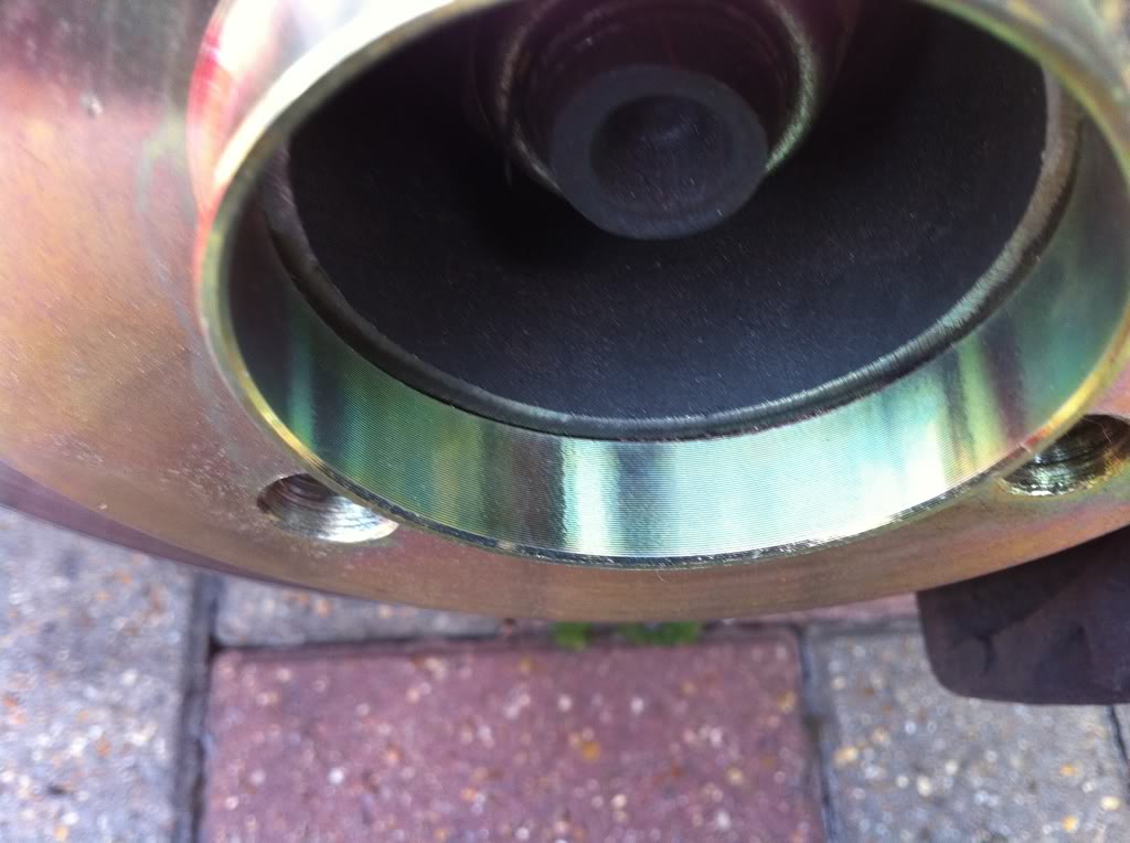

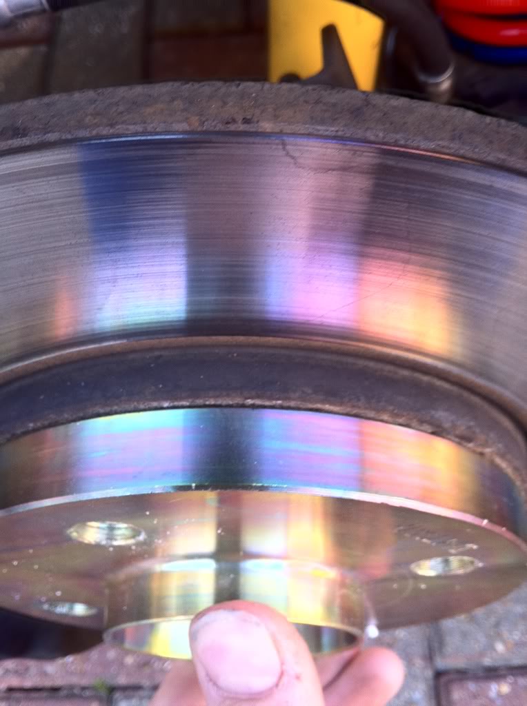

pics

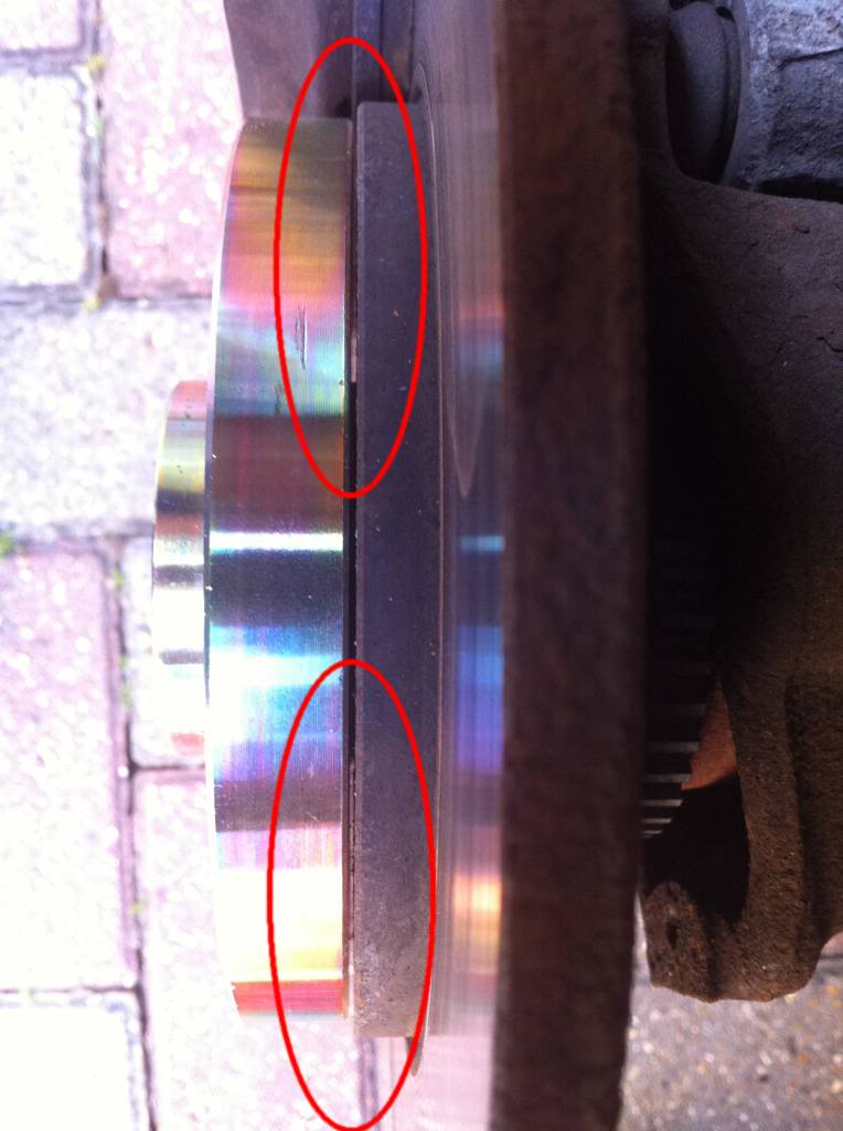

note that there is a small gap between spacer and disc
better pic showing this (air gap-can see the floor between the two)

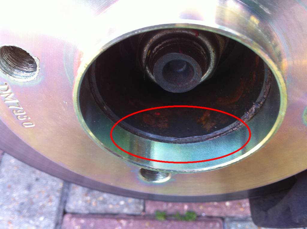

spigot and spacer touching

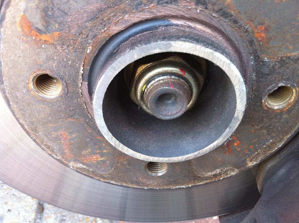

heres what i grinded

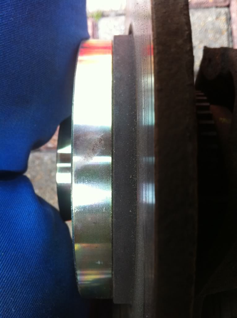

and now how the spacer sits
and the spigot and spacer
