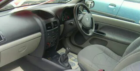

Hi all iv currently got a 1.2 mk2 pov sec dash with no center display
I was wondering would the wiring for the radio display be there if I was to do a dash change?
Iv currently got a aftermarket stereo in but I want to go to stock with a standard stereo however to do that I need the screen/display

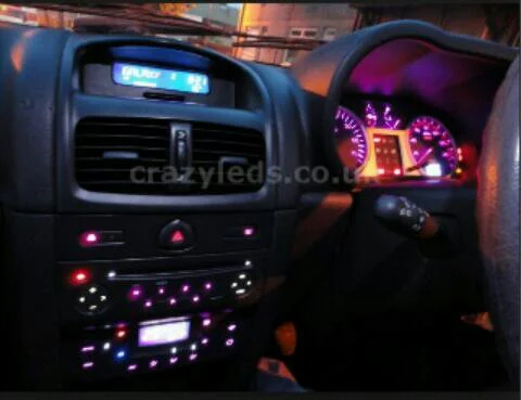

yes you can add in the display, I've done it to our clio. you will need to get hold of a tunerlist radio stalk control loom, display and dash
