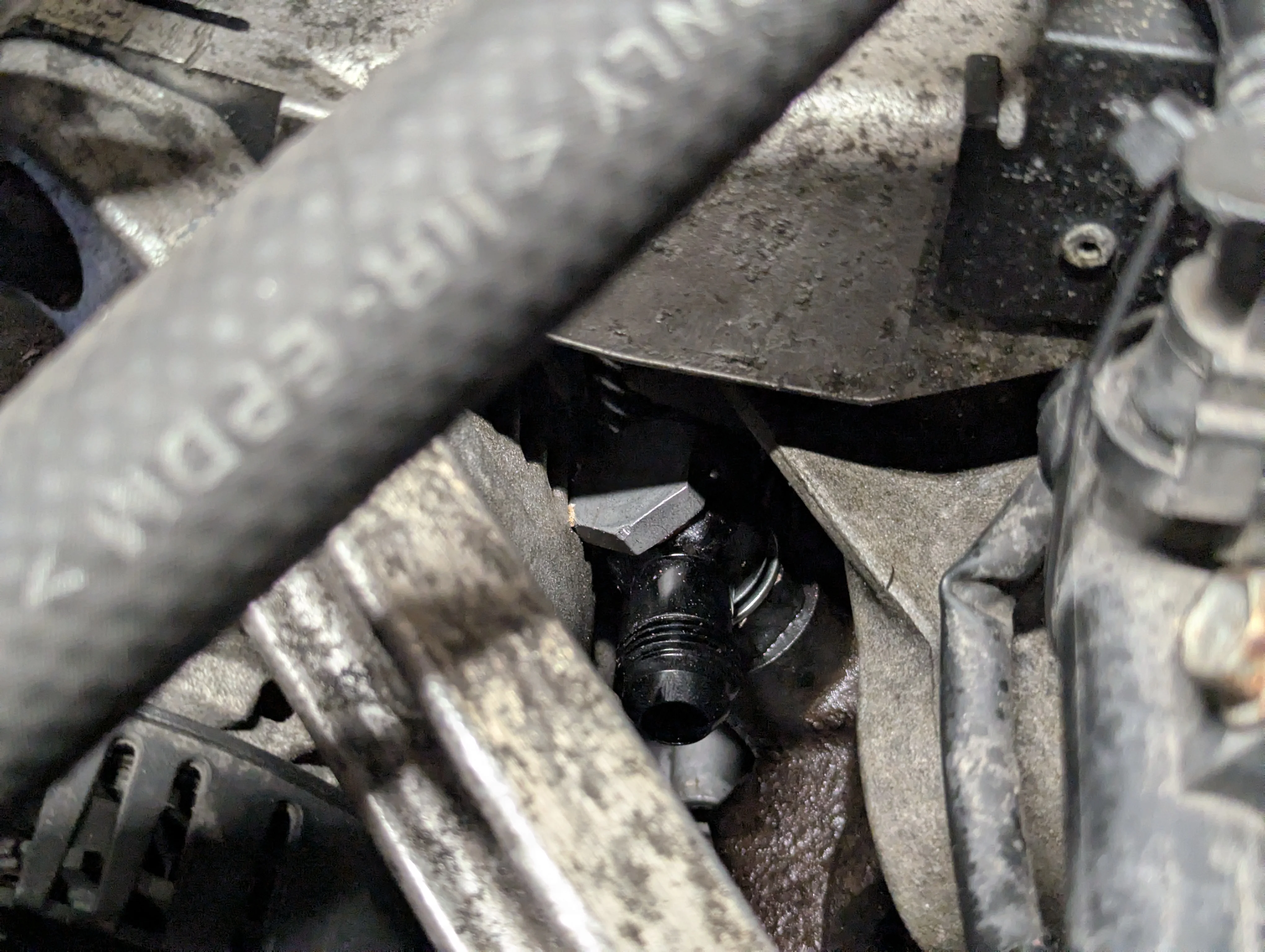

@MrBlonde Kits great, easy to fit if you have the engine out but massive PITA if you are doing it in situ.
The main pains where:
  • I had to undo the two small pipes on the rack to get spanner access to the HP line
  • My HP line union was seized so had to run an angle grinder through it and bend it to spin the union out
  • Alternator has to be moved out of the way to get access to the bango bolt for the kit assuming you still have full PAS/AC setup

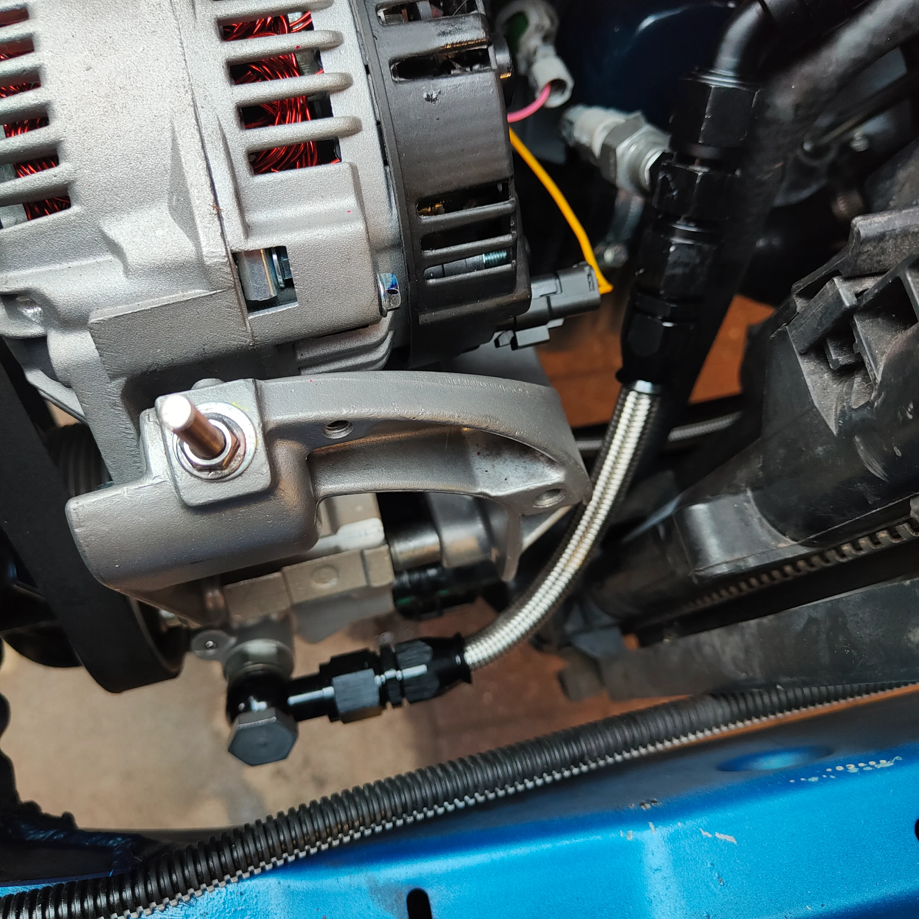

I have the advocult kit fitted, pics in my project thread.

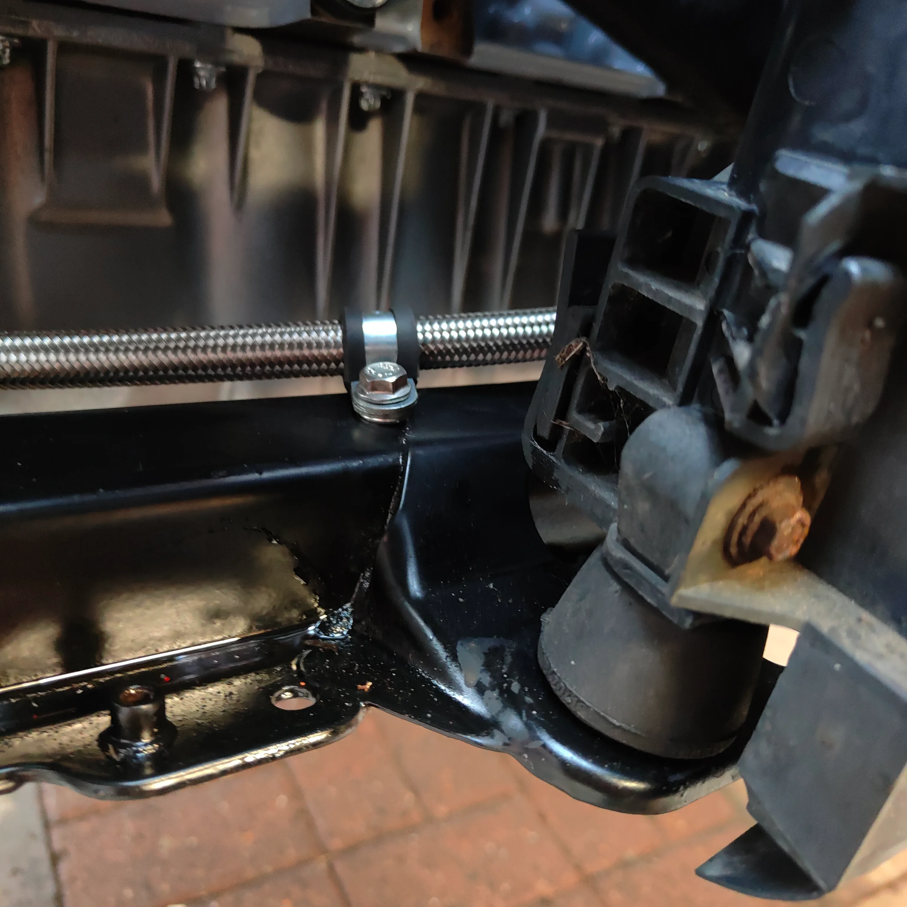

Honest opinion, it's ok. Just that, not amazing. I put a rivnut in my subframe to hold the hose with a P clip as their solution of a big cable tie is a bit s**t.
When I first fitted it it leaked on the PAS pump and only stopped when I changed the supplied copper washer for a Dowty washer.
The kit is intended for a non cup set up so the hose is a bit long leaving a big loop behind the rad but is fine once it's secured.
The AN fittings supplied aren't remotely a premium brand.
I can't remember what it cost, about £200? If so then it's probably a fair price. If I ever have the engine out again I'll re-do it with quality AN fittings and hose,(Aeroquip, speed flow, goodridge etc) and re design it so that it suits a cup set up properly.

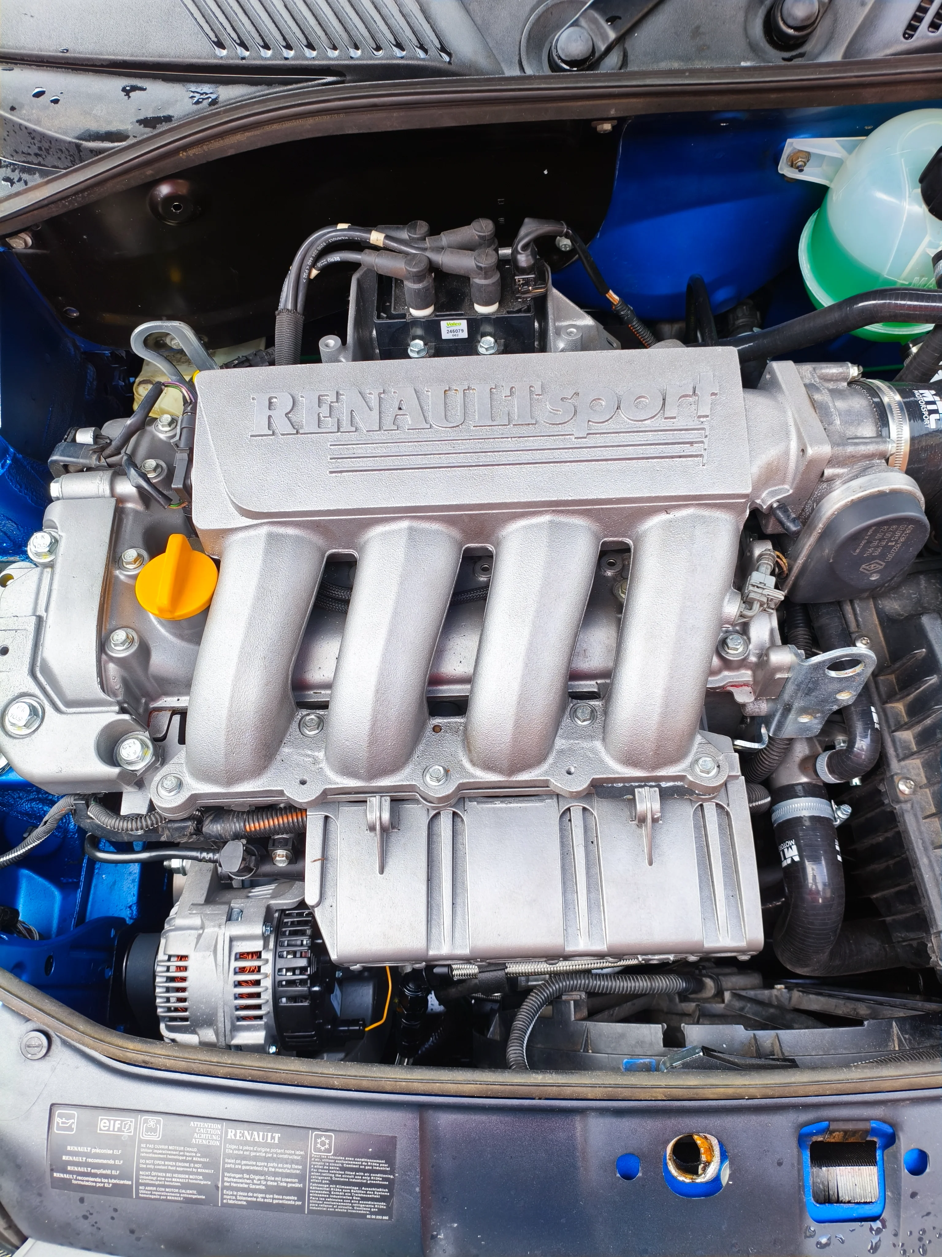

The advocult kit comes out of the rack and runs along the subframe
Then along the front of the subframe where I've secured it properly
Then the unnecessarily long hose loops up behind the rad fan and back down into a Tee piece for the PAS sensor, then into the pump, you can make out the hose Infront of the fuel rail cover here

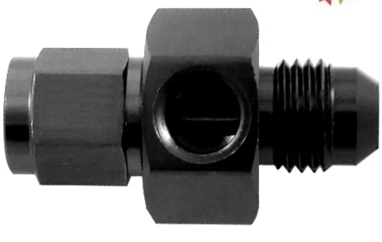

If I was going to do it again I would use a banjo AN in the pump, straight into an inline sensor adaptor like this
Then straight into a 180 degree AN fitting and run it down the subframe to the rack, that would get rid of all of the unnecessary hose and look much neater
