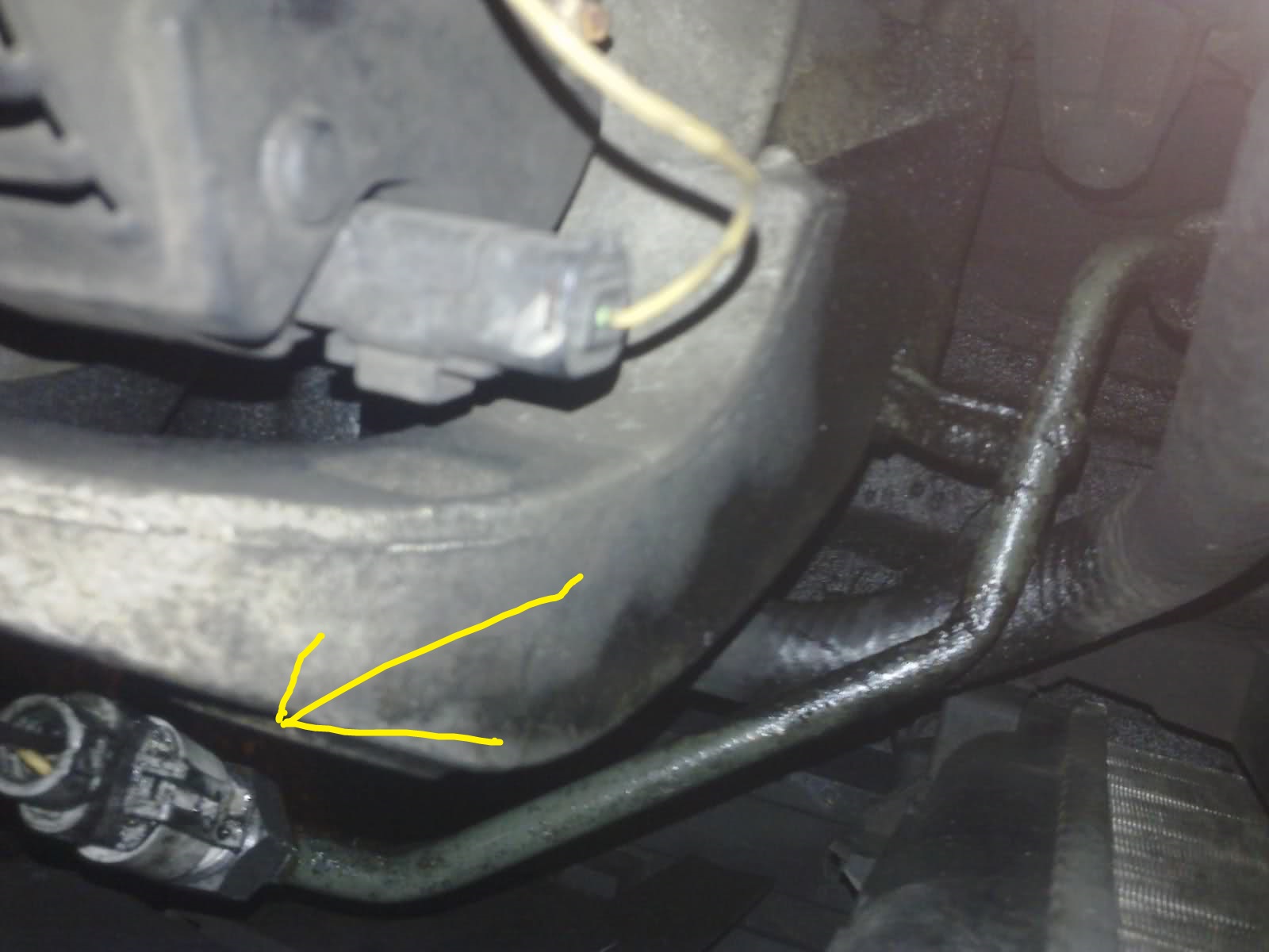

Hi,
I have an issue with a broken off power steering switch connector. The wires came off too close to the plug to solder. So i've been trying to look for a place to buy just the connector or the partnumber to it and it seems impossible to find.
Picture for reference.
  Clio 182
Remove the pin from the plug, take a picture, and join a Facebook group called "Motorsport Wiring Alliance".
There are some incredibly knowledgeable people on there, and they will likely be able to identify what type of pin/socket it uses. You can then buy them for pennies, and crimp the end onto your unbroken wiring and refit it to the plug.
