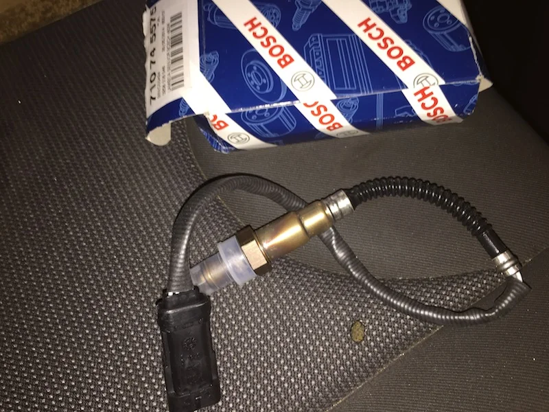

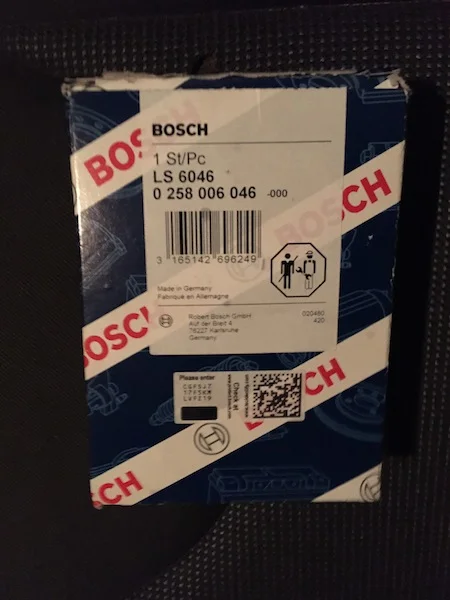

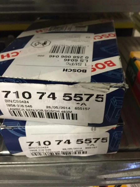

The short storey is I need to replace my pre cat 02 sensor because the exhaust gas emissions light has come on on the dashboard. Renault are asking over £100 for the part and I'm hoping that somebody may know of an alternative?? I'm sure I've read somewhere on here that it is a Bosch item just marked up- can anybody confirm this?
Any help is much appreciated!!
Thanks for the replies chaps! MarkX- do you have a part number? Is that the part the Renault uses just with different stamps?
