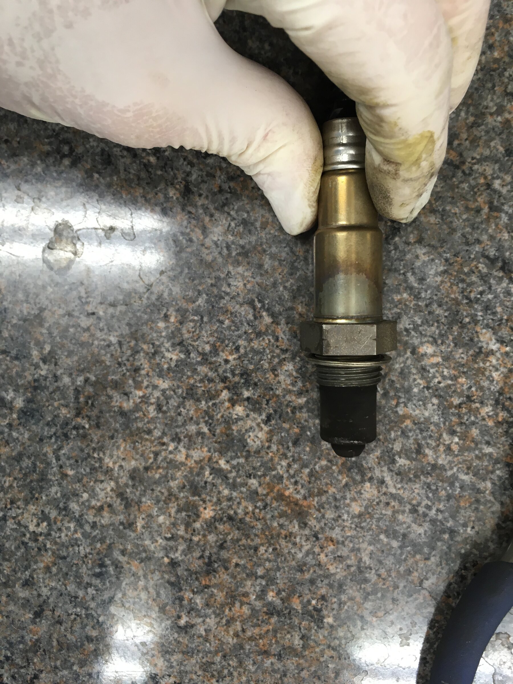

I started the car from cold yesterday and had it running for around 3 mins before I took the faulty upstream sensor out. The sensor probe was very sooty - see photo - but this may have been as a result of the car being 'on choke' after starting, so to speak.

Has it been mapped? Looks like it is running really rich.
