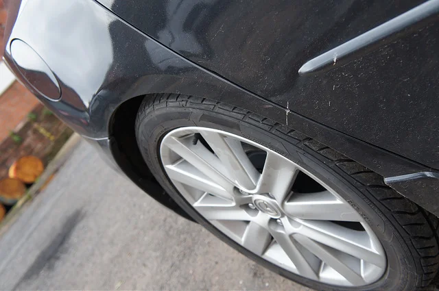

This car is owned by a friend of mine and is being sold soon so I was asked to restore some life into its paintwork ahead of the sale. I also took the opportunity to try out the new Auto Finesse Fusion Wax...

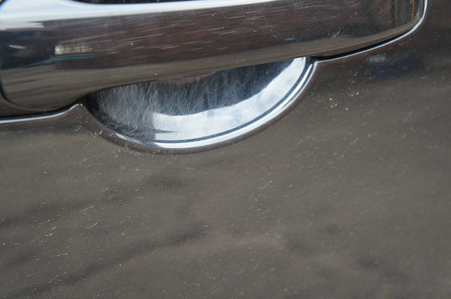

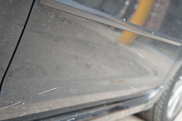

A few befores:
DSC06221 by RussZS, on Flickr
DSC06222 by RussZS, on Flickr
DSC06223 by RussZS, on Flickr
DSC06224 by RussZS, on Flickr
DSC06225 by RussZS, on Flickr

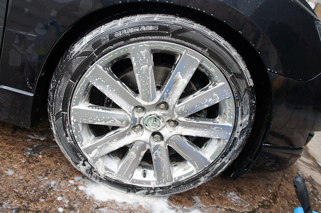

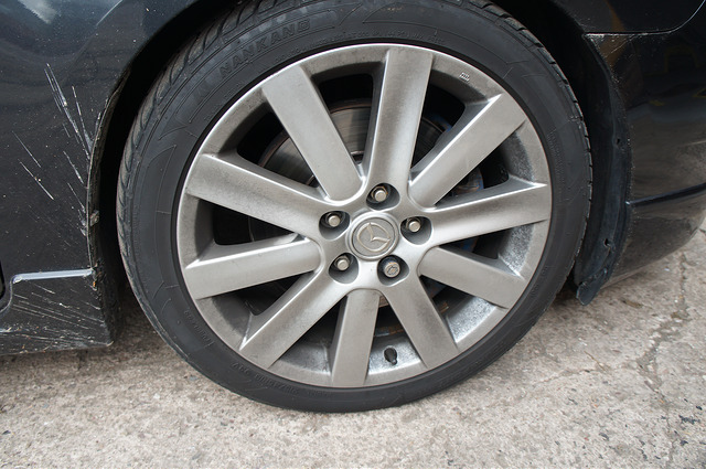

Wheels were up first, so before:
DSC06230 by RussZS, on Flickr

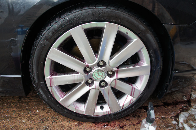

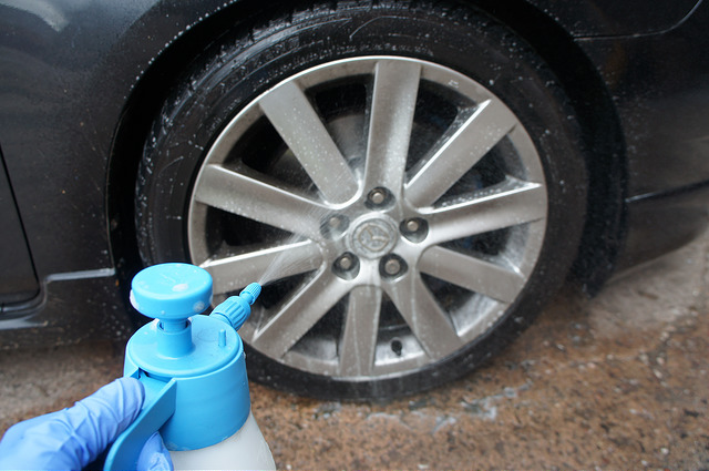

As they were quite soiled, I attacked them firstly with G101 via Pressure Sprayer, left this to work for a few minutes then rinsed to remove as much as the dirt as possible before making physical contact with the wheels!
DSC06231 by RussZS, on Flickr
DSC06233 by RussZS, on Flickr
Rinsed:
DSC06234 by RussZS, on Flickr

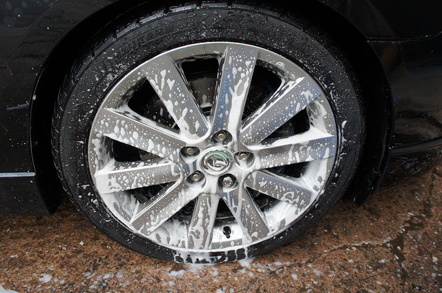

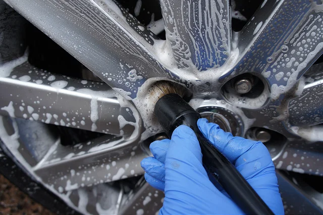

Better, but not good enough, so out came the Smart Wheels and various brushes:
DSC06235 by RussZS, on Flickr
DSC06236 by RussZS, on Flickr
DSC06237 by RussZS, on Flickr
DSC06238 by RussZS, on Flickr
DSC06239 by RussZS, on Flickr
DSC06241 by RussZS, on Flickr
DSC06242 by RussZS, on Flickr

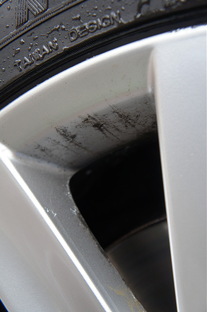

These were then rinsed but were still heavily soiled in places:
DSC06243 by RussZS, on Flickr
IronX was used to attack and remove these stubborn stains, which I assume were brake dust:
DSC06245 by RussZS, on Flickr
DSC06246 by RussZS, on Flickr
DSC06247 by RussZS, on Flickr
Much better!
DSC06248 by RussZS, on Flickr

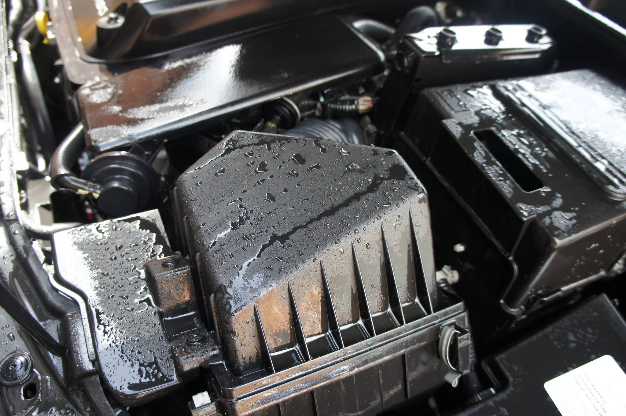

The engine bay was next, dealt with via G101:
DSC06251 by RussZS, on Flickr
DSC06252 by RussZS, on Flickr
After:
DSC06255 by RussZS, on Flickr

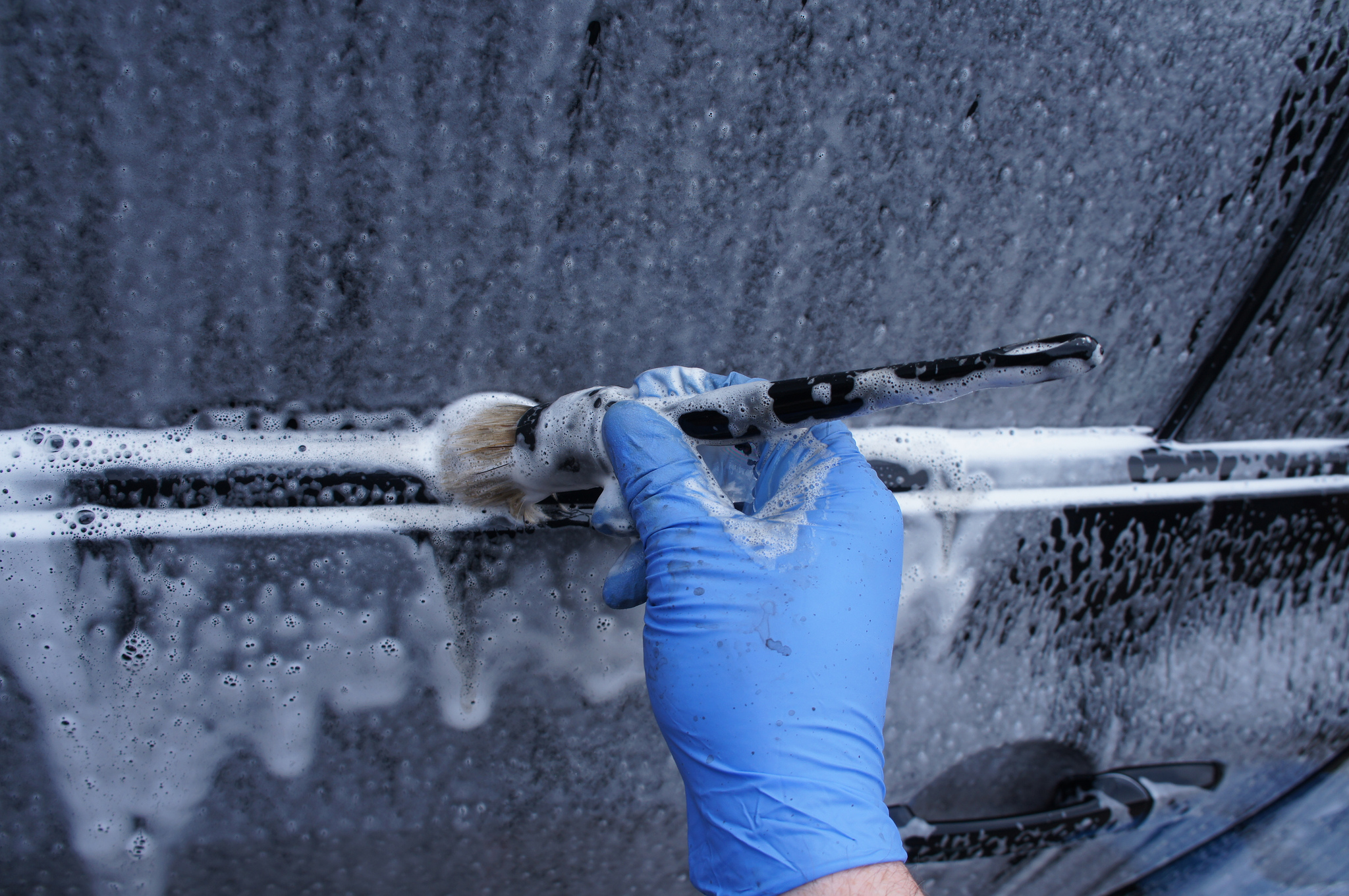

Grime Out was used to foam the car:
DSC06256 by RussZS, on Flickr
DSC06257 by RussZS, on Flickr
DSC06258 by RussZS, on Flickr
DSC06261 by RussZS, on Flickr
DSC06262 by RussZS, on Flickr
DSC06264 by RussZS, on Flickr
Auto Finesse Lather was used to wash the car:

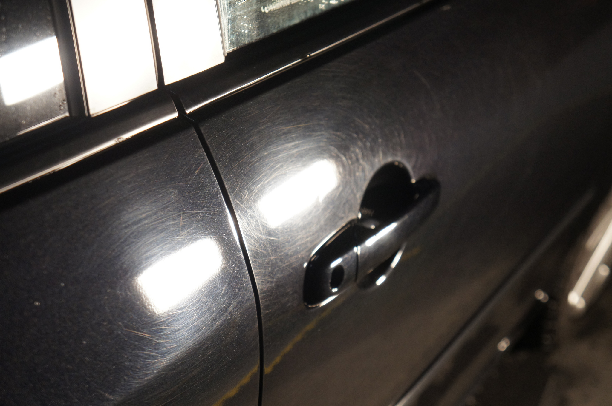

Then the car was dried with a towel and blower (to stop water runs!) then the paintwork was assessed.
The paint on this Mazda was very thin - averaging between 100-110 microns all over...
I was hoping that the paint wasn't too bad, but...
DSC06269 by RussZS, on Flickr

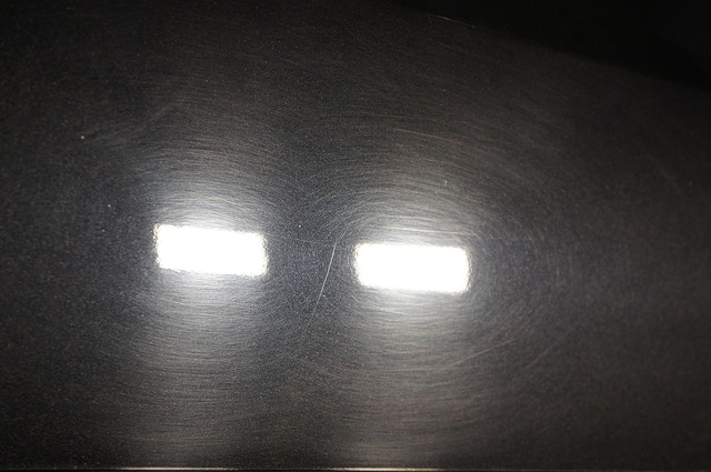

Oh dear... possibly the worst paint I've seen in a while, and given how thin it was, I was to tread carefully...
DSC06271 by RussZS, on Flickr
DSC06272 by RussZS, on Flickr

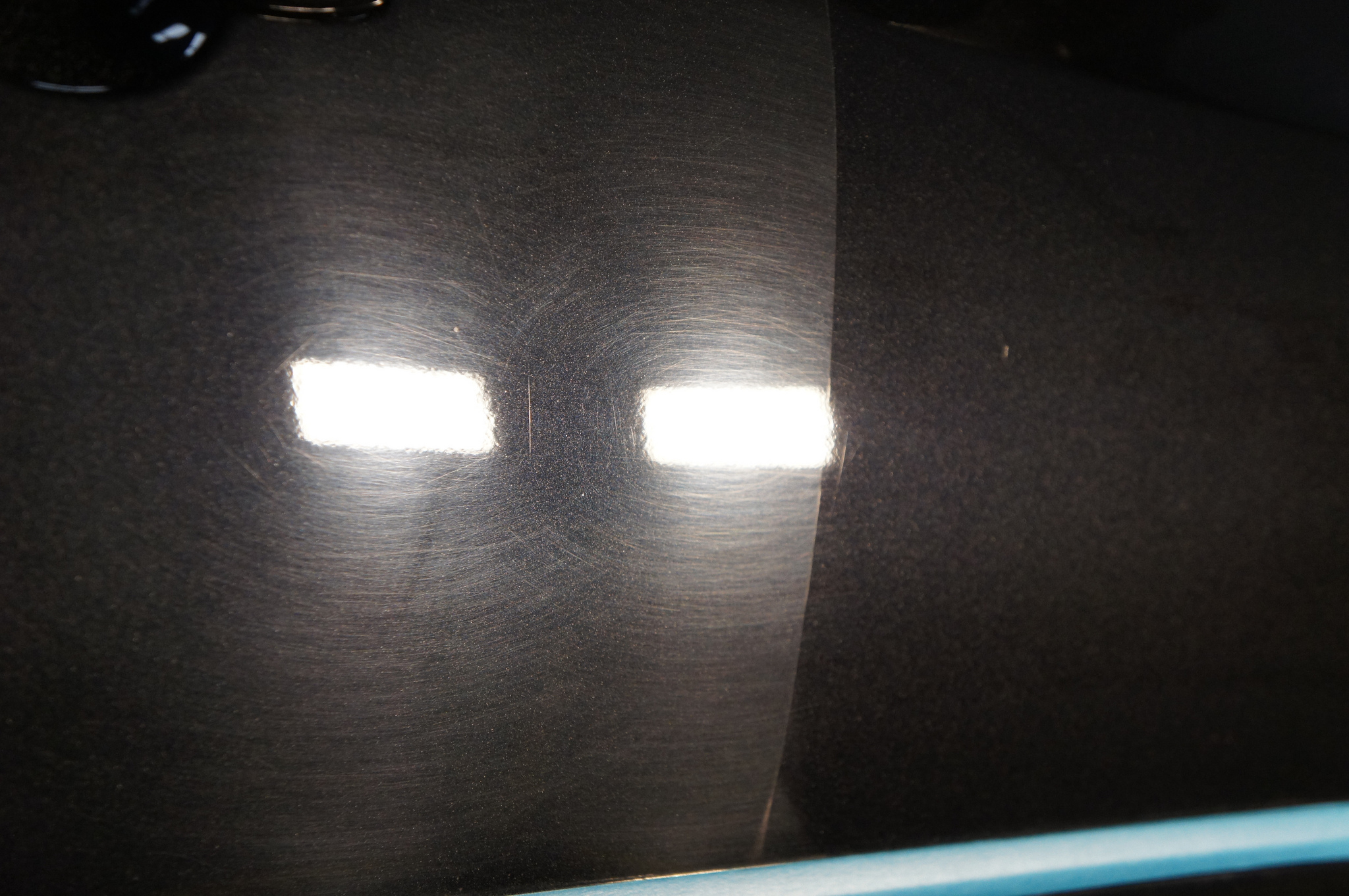

After playing with a few combinations, I was getting the best results from Megs 105 on a polishing pad and following up with Megs 205 on a finishing pad:
DSC06274 by RussZS, on Flickr
DSC06277 by RussZS, on Flickr

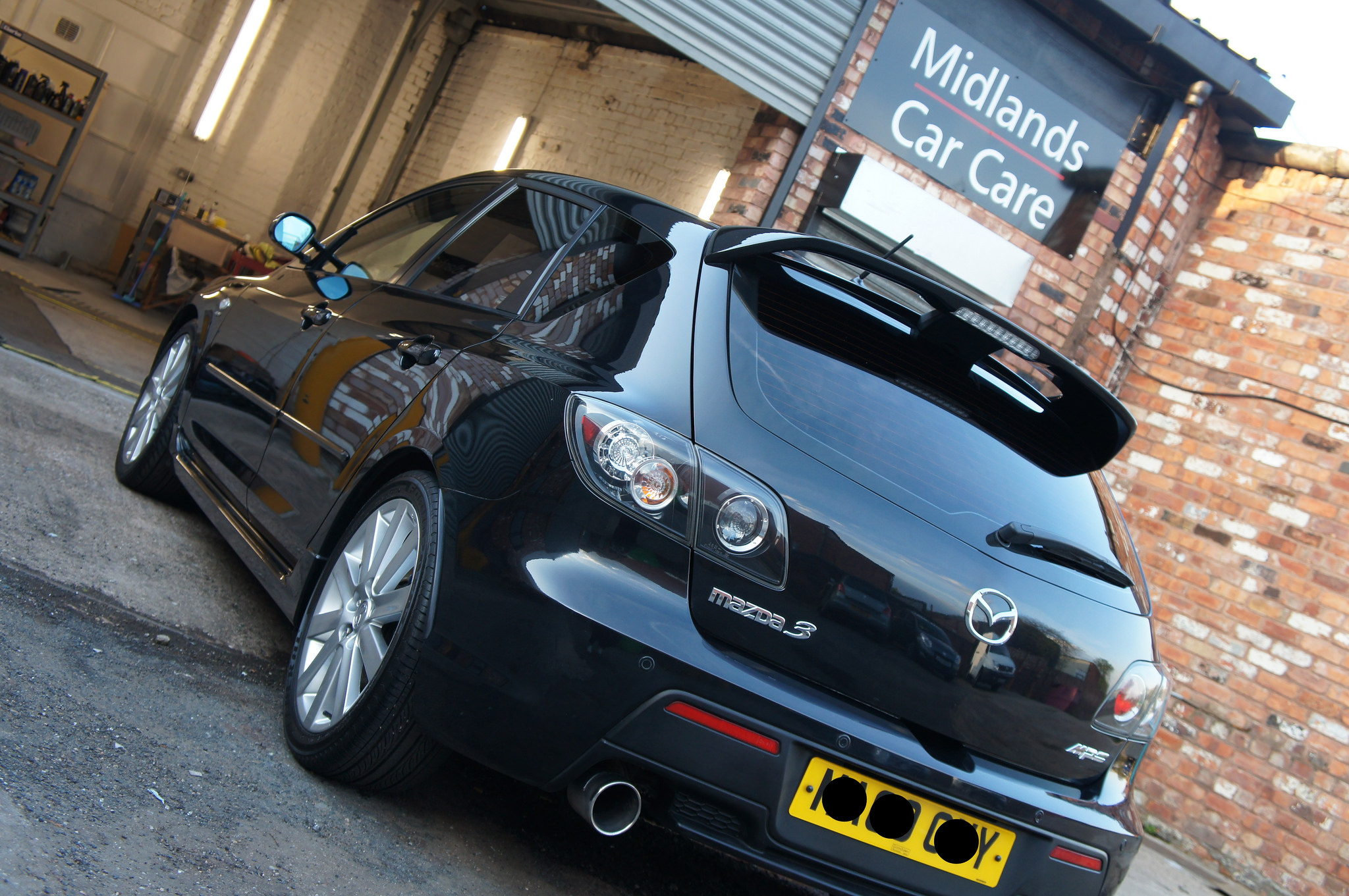

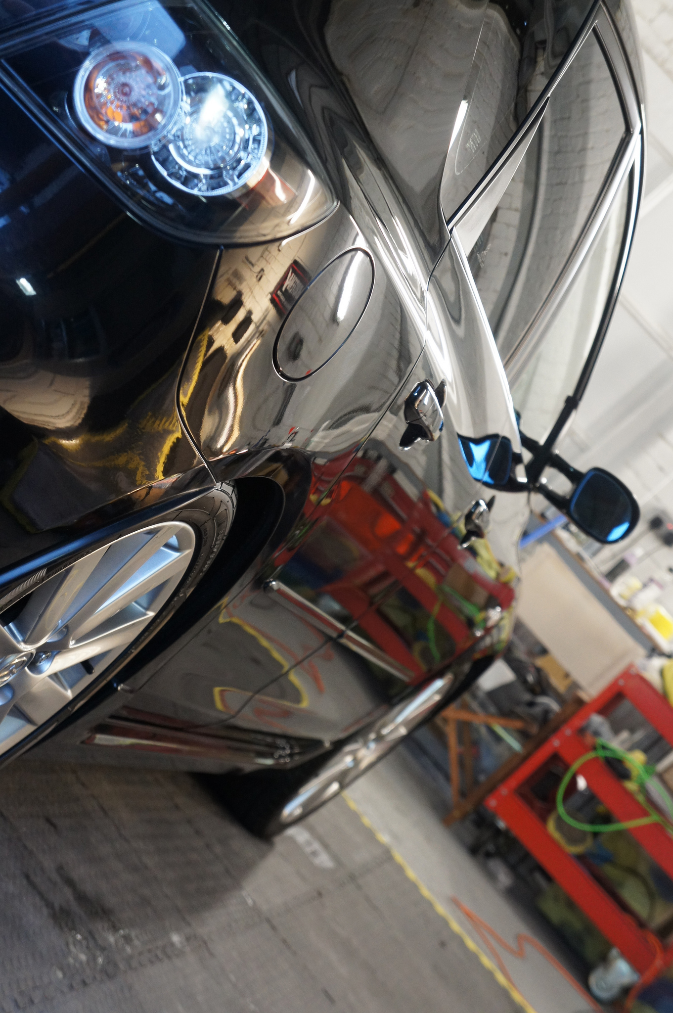

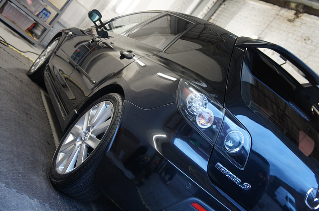

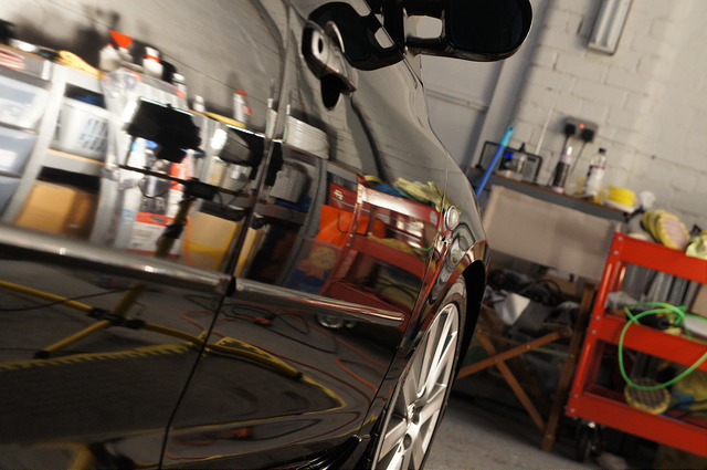

and finally, after 12 hours or so, some afters:
DSC06305 by RussZS, on Flickr
DSC06307 by RussZS, on Flickr
DSC06309 by RussZS, on Flickr
DSC06310 by RussZS, on Flickr
DSC06311 by RussZS, on Flickr
DSC06312 by RussZS, on Flickr
DSC06313 by RussZS, on Flickr
DSC06315 by RussZS, on Flickr
DSC06320 by RussZS, on Flickr
DSC06325 by RussZS, on Flickr
DSC06326 by RussZS, on Flickr
DSC06327 by RussZS, on Flickr
DSC06328 by RussZS, on Flickr
