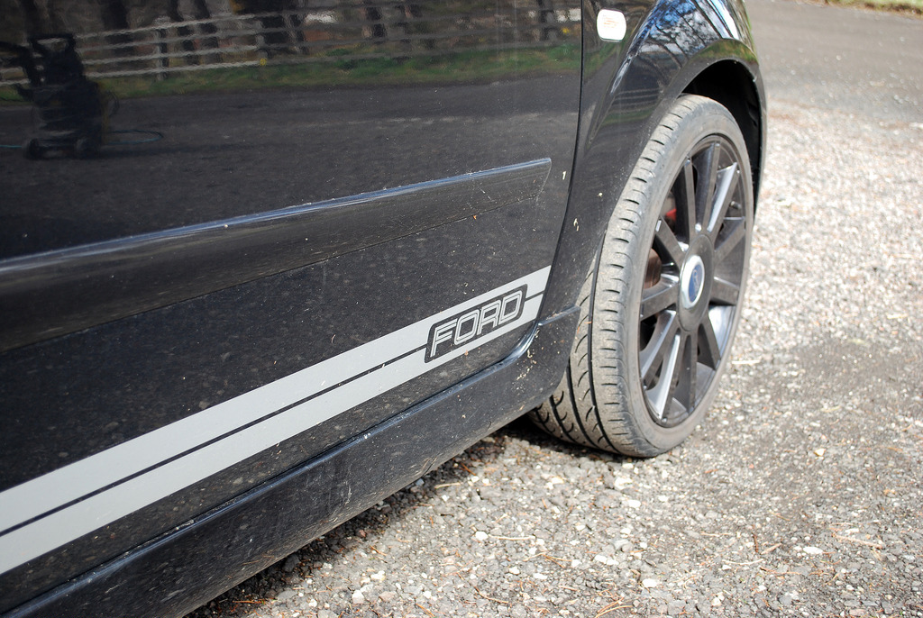

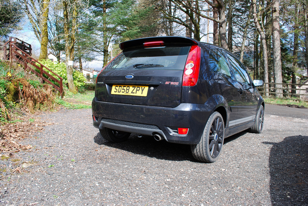

So, Car arrived at 9am this morning looking sorry for its self:
DSC_0882
by Jamie_Atkinson, on Flickr
DSC_0883
DSC_0884
DSC_0885
DSC_0886
DSC_0887
DSC_0888

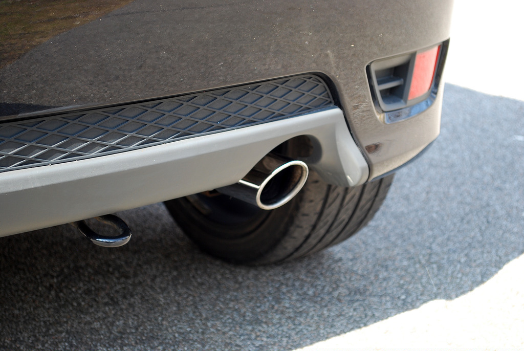

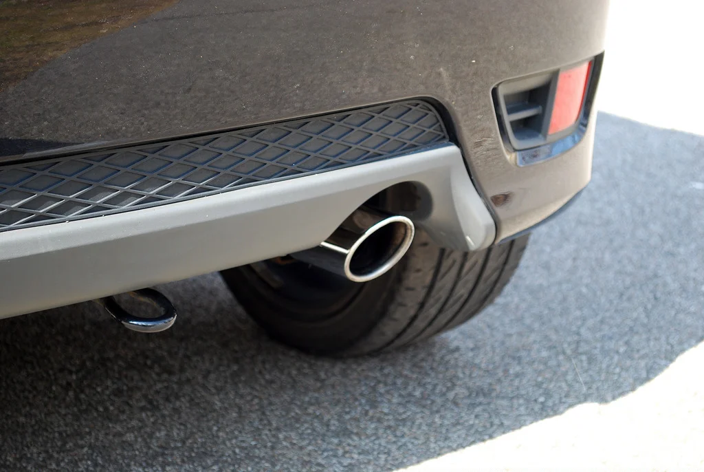

Car was then clayed, Paint felt so so rough before hand
DSC_0894
Excuse the amount of tar that was lifted, Black cars are very hard to see tar so i missed some before
Rinsed and Dryed, Not looking too bad
DSC_0895

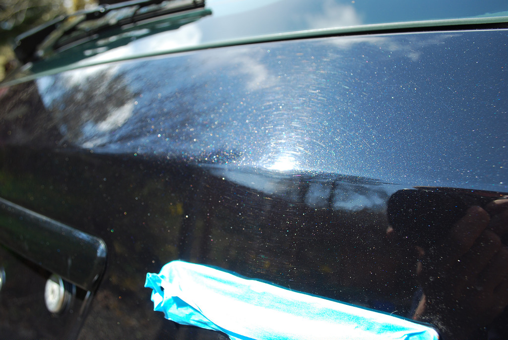

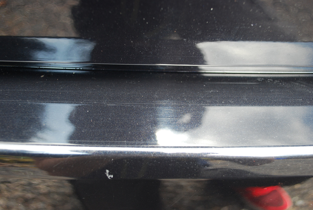

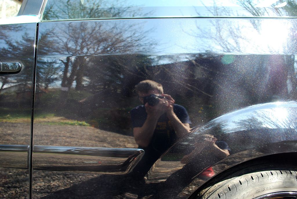

Car was covered in Swirls and RDS
DSC_0897
DSC_0900
DSC_0901
DSC_0902
DSC_0903

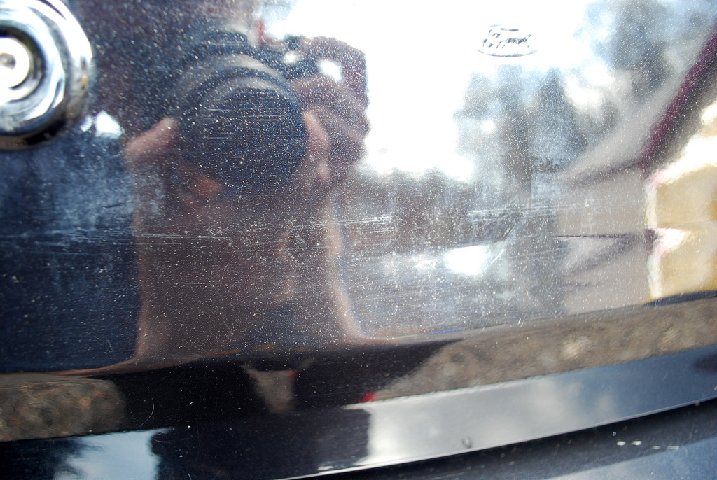

Bootlid
DSC_0908 2

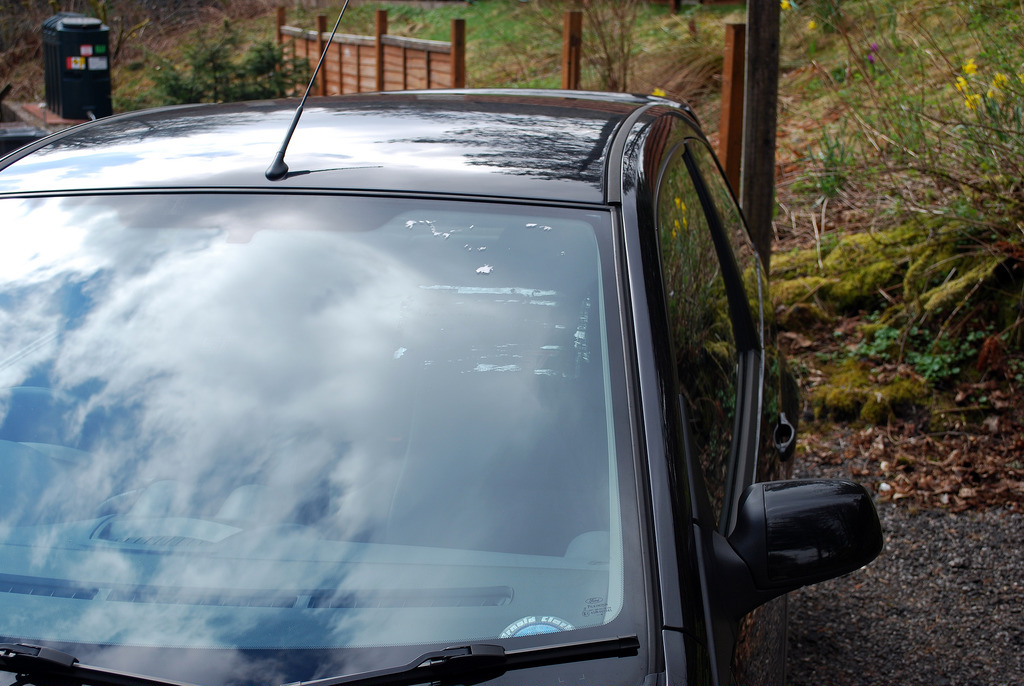

Car was also covered in water spots even after being washed and dried properly
DSC_0904

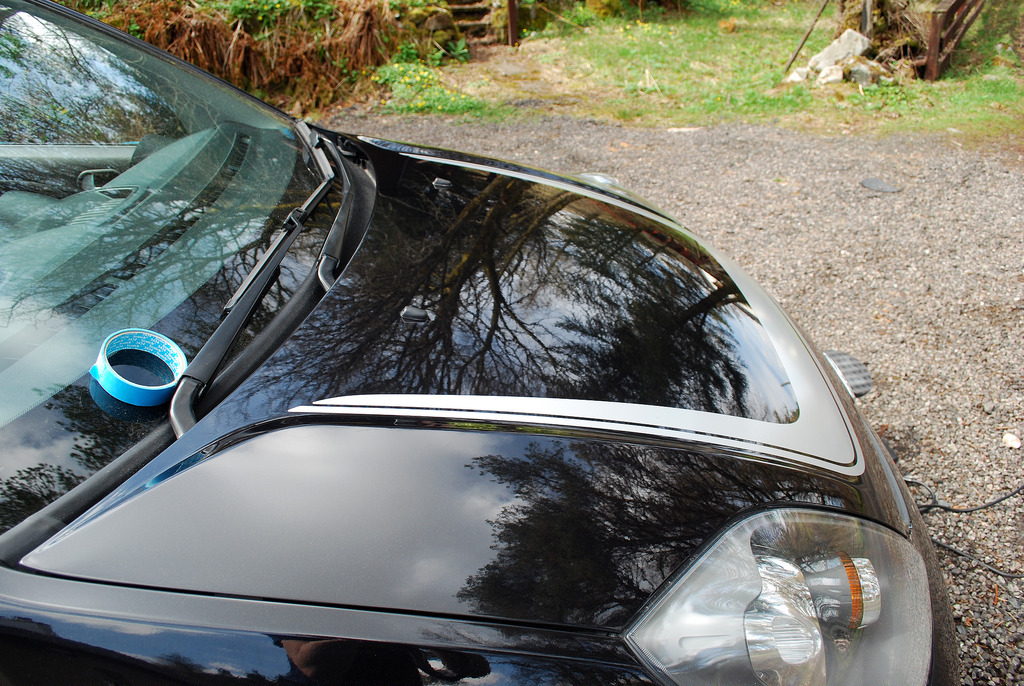

Bonnet 50/50
DSC_0905
Bonnet Finished
DSC_0907

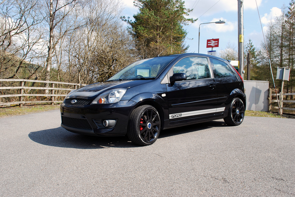

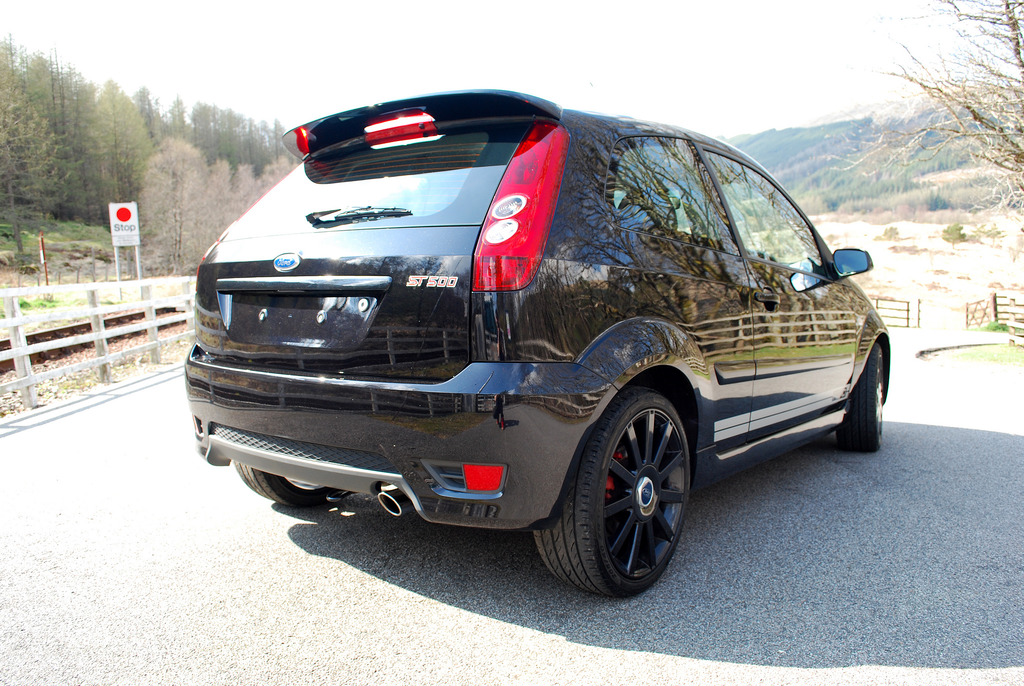

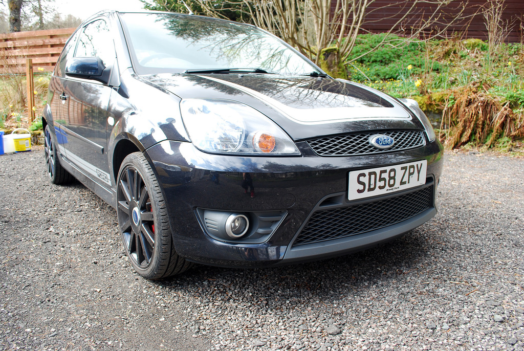

FINISHED
DSC_0911
DSC_0912
DSC_0913
DSC_0914

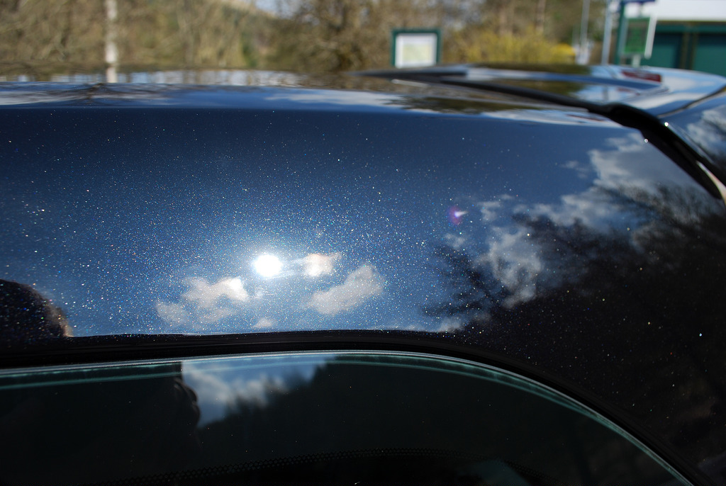

The flake pop on Panther black is amazing, Blue/Gold/Silver
DSC_0915
DSC_0916
Used various Mezerna pads and polishes and was sealed up with FK#2180
Good God man, please don't tell me you're offering friends and family detailing services, let alone anyone further removed?! I got about half way through...
Snow foaming does not equal washing. Especially with the car in that state. You needed a two bucket method wash, probably changing the buckets half way through to get it anywhere near clean enough to de-tar and touch with a clay bar. Did you not think it was strange that your clay looks like a piece of coal after a few passes on a panel?!? And those small dull patches of grey as you've mentioned, clearly apparent in your "swirls and RDS" photo - these are the result of a piece of clay either being to coarse for the application or resulting marks from too much pressure. So you've effectively trippled your polishing work to remove these.
Finally, reflection does not equal correction. Every "after" shot does not show that you've corrected the paint properly. The only one with a marked difference shows after marks from dried claying lube/water spotting no longer present on the side of the bonnet you've polished. I could wipe with some quick detailer one side of a similar bonnet and achieve the same "corrected" shot.
All in all mate, and sorry to be coarse, pretty piss poor.
