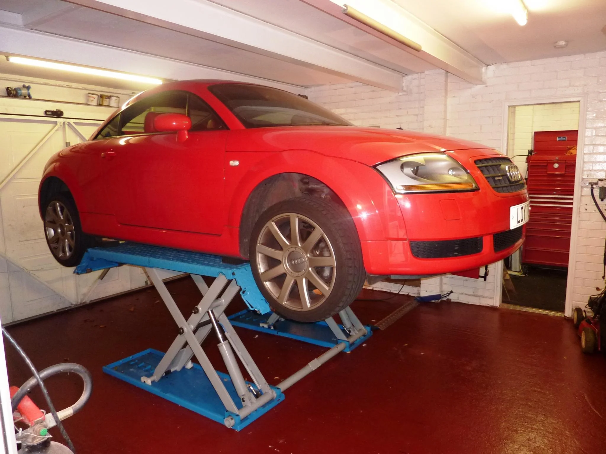

Its been so easy doing this on my new hoist, no more scrabbling around on the floor!

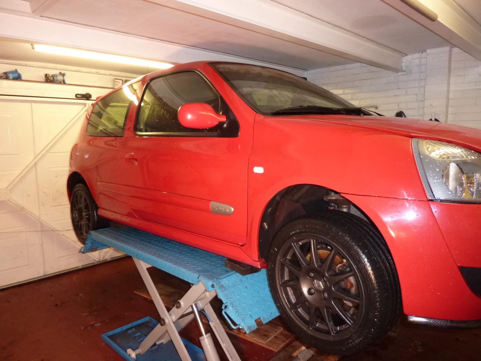

Preventative maintenance would have been changing the dephaser, water pump and pas pump surely since if they go your still going to have to change the cambelt or aux belt again!

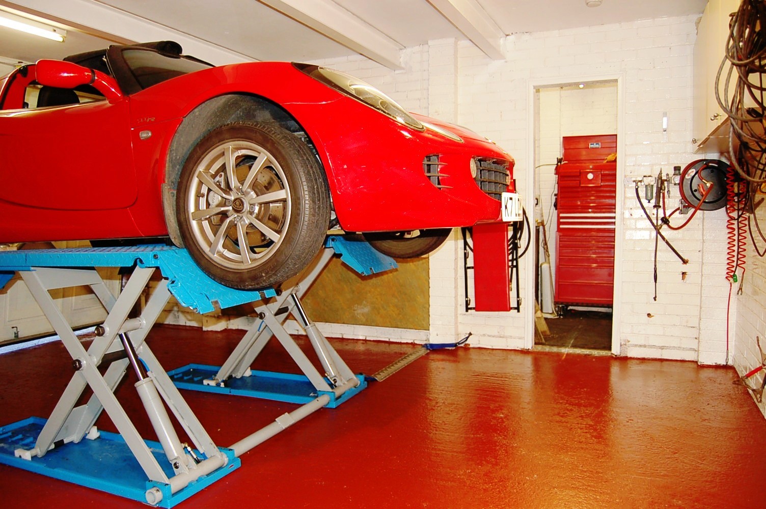

The hoist was £1500. It lifts over a meter high which is enough to comfortably do brakes and suspension standing up, but also I can work comfortably underneath. It lifts up to 3000KG (lifts my BMW 7 series easily...) and it goes down low enough to drive over so I can still get 2 cars in the garage. here is a bit better photo with my Elise on.
I want one of those.

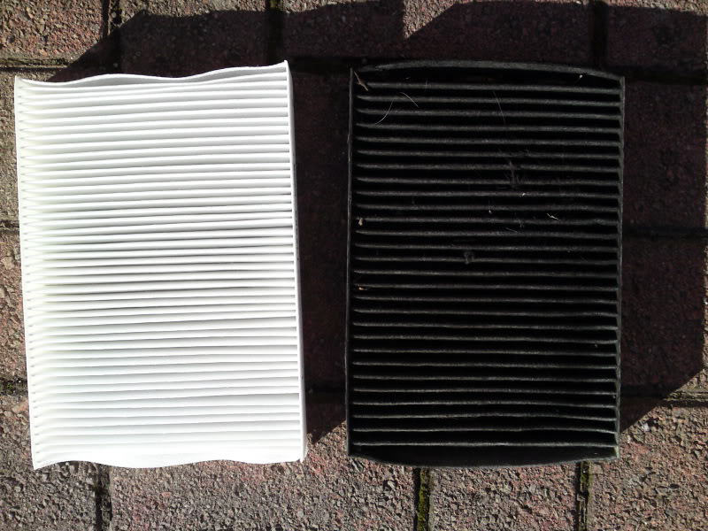

My pollen filter was rank! Easy enough to get to, well overdue tho... ;) Dont think it had ever been done!
And yes - it was originally white....

I have changed the pollen filter although it was not too bad - cheap to change though
