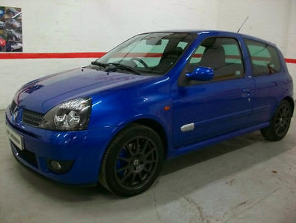

Blue calipers and black wheel aren't great as I like the standard cars look but it looks presentable in the flesh!
