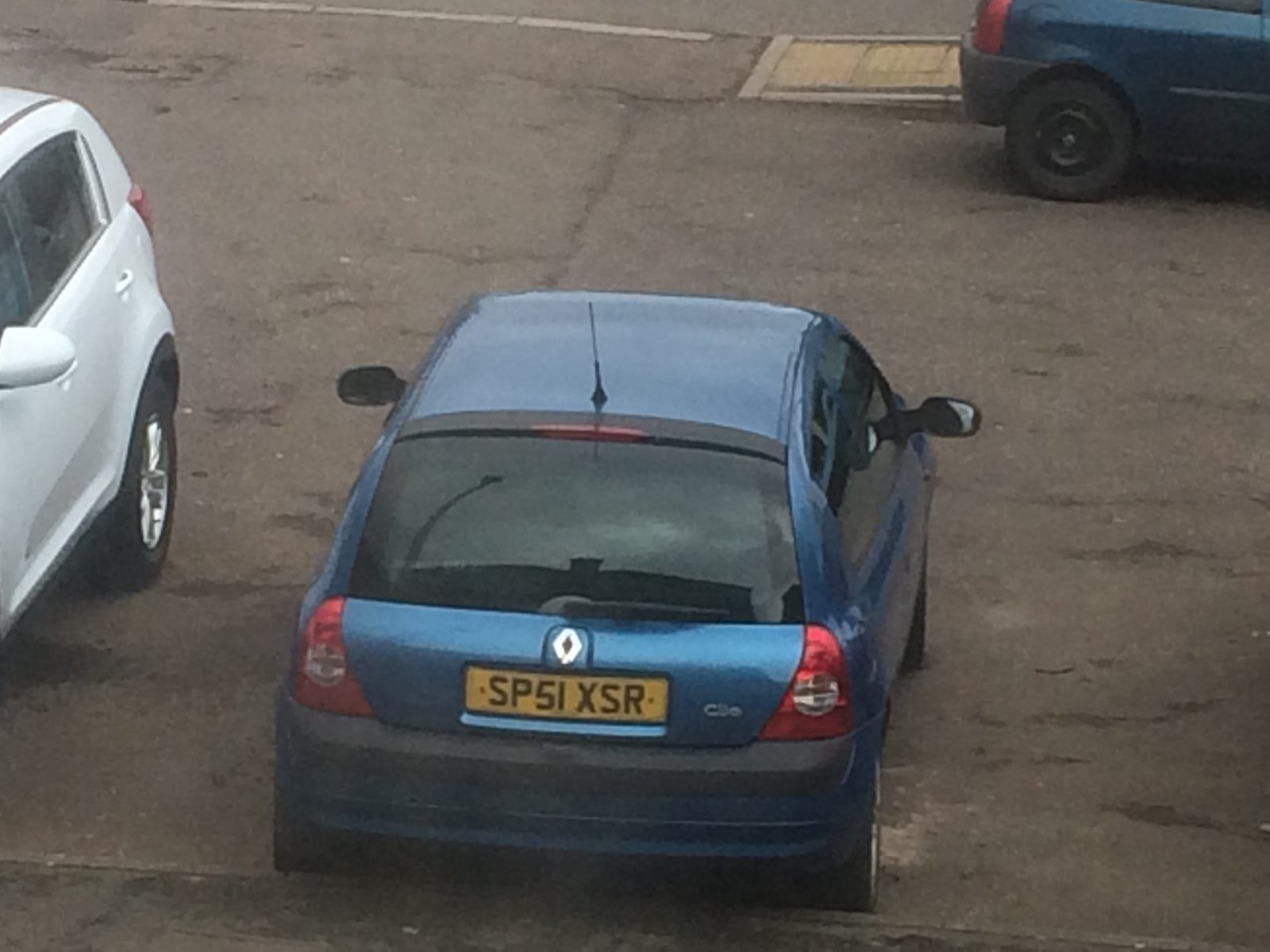

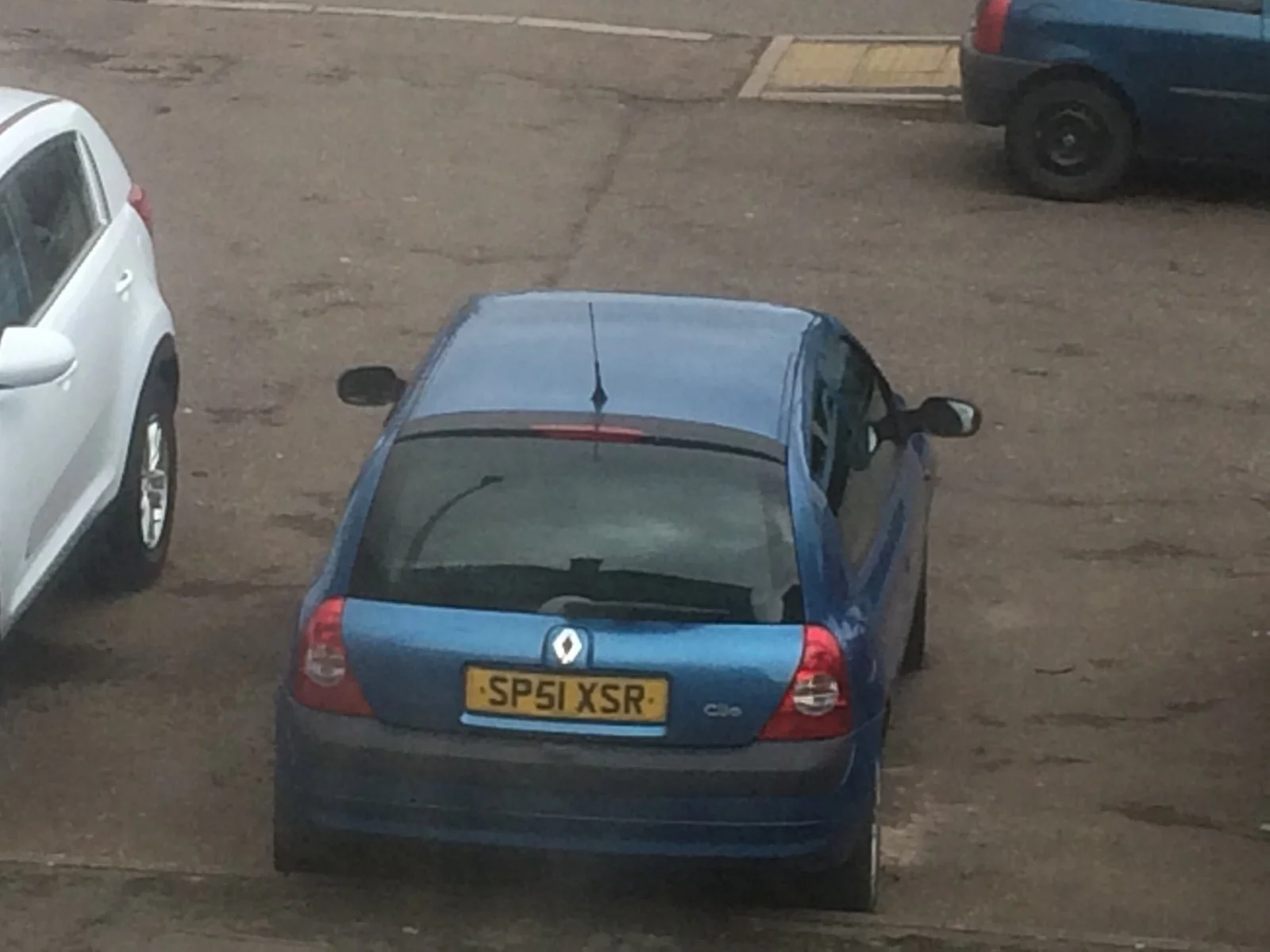

It's the haste of finding a car the same colour though around my area haha, every other Clio is black, green or silver! Mine is blue
