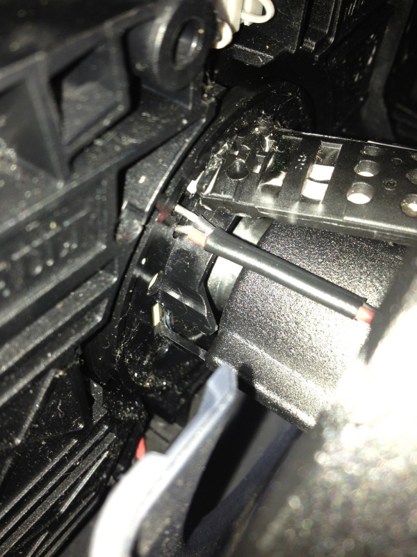

So i've bought a Sabelt steering wheel and boss kit from K-tec, went to fit it and it all went well, then went for a drive and noticed some tension on nearly full lock and the occasional click, or perhaps crack. When I got home I take the wheel off again and notice that the boss kit doesn't actually fit fully into the slots for the circular plastic thing (the bit that cancels the indicators and holds the airbag and horn cables in place), so what had happened was that the wheel was turning around and the plastic thing didn't always turn with it - the result was that it pulled on the airbag connector and yanked it out of the plastic holder thing.
Here's a pic of what I mean:
Should the boss be going the full way down so that it fits between the plastic slots?
Seems like such a simple thing and it all would've been simple, apart from this annoying problem.
I've noticed on the picture for K-tec of the boss that there's a plastic bit sticking out of the bottom of it - should my boss have that? (presumably that bit of plastic is the bit that slots into the circular plastic bit to make sure it turns with the wheel).
Any thoughts?
