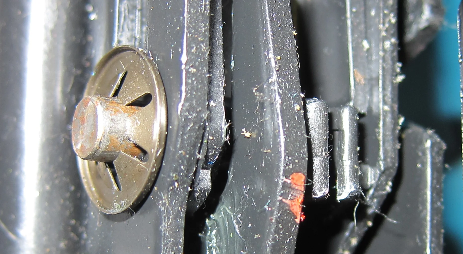

I've got a small problem with the driver seat. A small rod (arrow A)in the machanism that allows the seat to move forwards and backwards won't stay in place (it fell out and I found it under the seat). I wonder if there should be some kind of clip fixing this rod in position (arrow B).

Could someone please take a picture of a proper working seat mechanism. The only thing you have to do to get to the machanism is remove one bold with a torx 20 and remove the small plastic fairing.

Heres what you need.

Wow,
Thanx MaintenceMan!
My brother even suggested to use one of these to fix the problem. I've got some spare toothed lock washers so I'll try to put one on the rod tonight.
