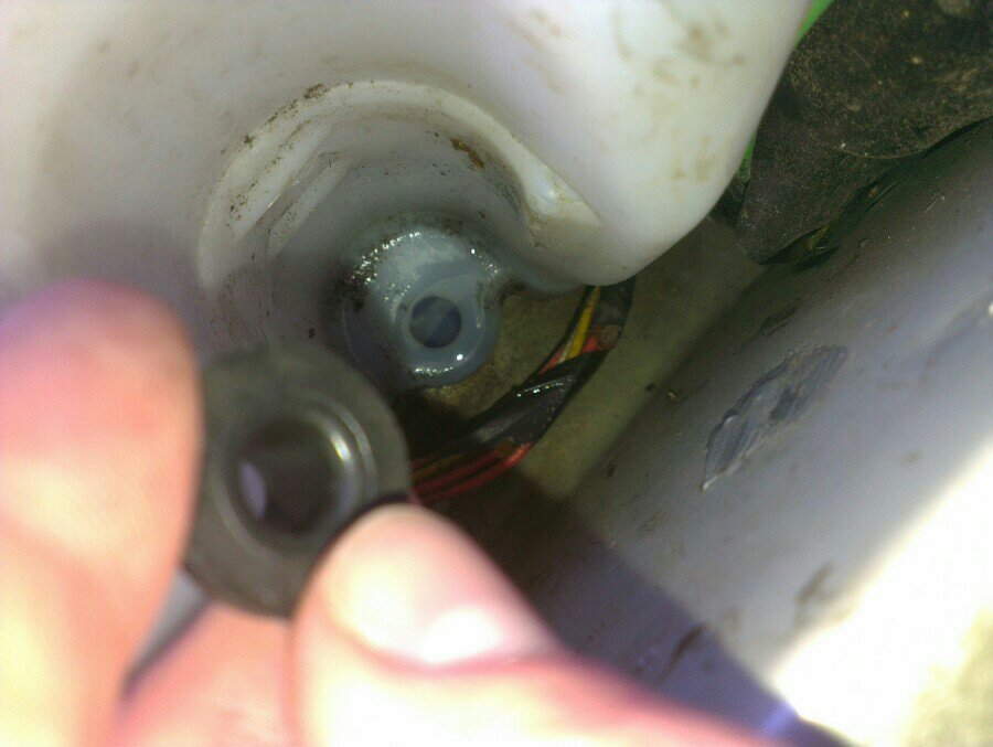

Is the bung in the washer bottle (where the pump sits into) clear? It might be full of crap which would cause a slight blockage
Dan...
Just checked that too...
