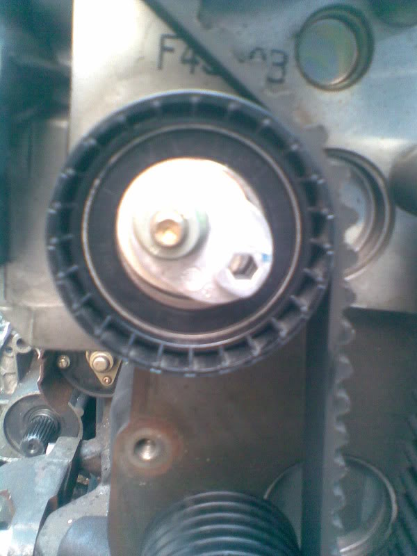

You say that, we are in the process of fitting a secondanh engine to a 172 at the min!
Was swapping the belt on the floor, tipex everywhere, lol, blatantly hadn't had the correct timing tools!
Tensioner was miiiiiiiiles away.

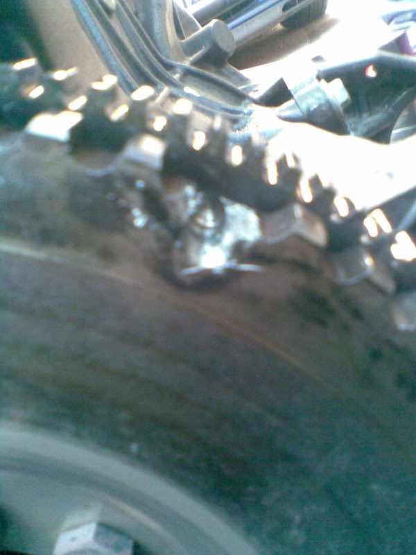

I corrected one like that done by a "specialist". Owner was effectively told to f**k off when he called to say it was wrong.
How NOT to fit a cambelt tensioner
  ITB'd MK1
yeah, well kind of. it's obscuring the marks you have to align. God knows how many they've cocked up :(.
They claimed it "can't be wrong, we have the right tools". Makes no difference if you dont know how to use them.

Probably not that different from the state of mine, Sideways can confirm someone fucked it up when they did it!!
  ITB'd MK1
Jay, engine was out to fix this ;)
Callis, yeah yours was tip top. Crank pin was put in a balancing drilling when they timed it from what i can work out. (I align the cams first if possible, then see how far the crank is out)
