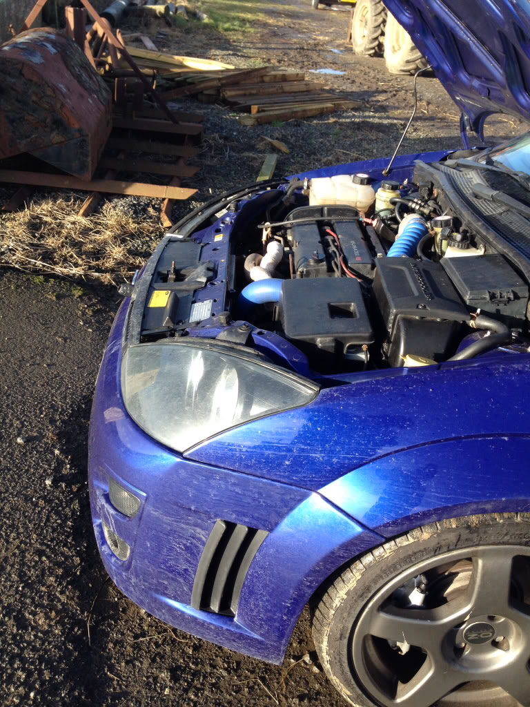

Your thinking of the o ring that is removable, i have no leaks there, im on about the part where the plastic piece with three holes screws onto the housing, and also when the housing is bolted onto the block i can see the rubber seal around the thermostat poking out the top, i cant remember how it looked when i took it apart such an amateur! Haha
The thermostat housing is made up of 2 bits with 2 seals.
1 - Housing to block with seal
2 - Front part of housing to main housing (held by 3 bolts) which is sealed by the thermostat
Which part is leaking?
I got it sorted i was being an unreal nugget and had the thermostat against the head! Idiot i know, its sorted now no leaks and running sweet!
Huge relief! There is the tiniest droplet comes out the thermostat housing but i will put a run of sealant along the join at the weekend!
