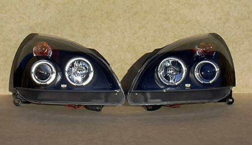

I mean the ones that have the lense instead of the reflectors. (the actual headlight unit) Like these:
I need them before I get HID/Xenons to keep them from blinding everyone.
Ok m8 I know what you mean now no sure what they will look like never seen any in the flesh, but like I said not that hard to fit just remove both arch liners to give you acsess to the bolts on either of the bumper undo them and then there's two pop pins in your engine bay holding you grill in the top two corners of the plastic bit take them out and I think That's its the bumber should lower to give you acsess to the two lower bolts on both lights, each light has three bolts one is very easy to get to like I said the other two are under the bumper, it easy m8 if I can do it anyone can believe me
