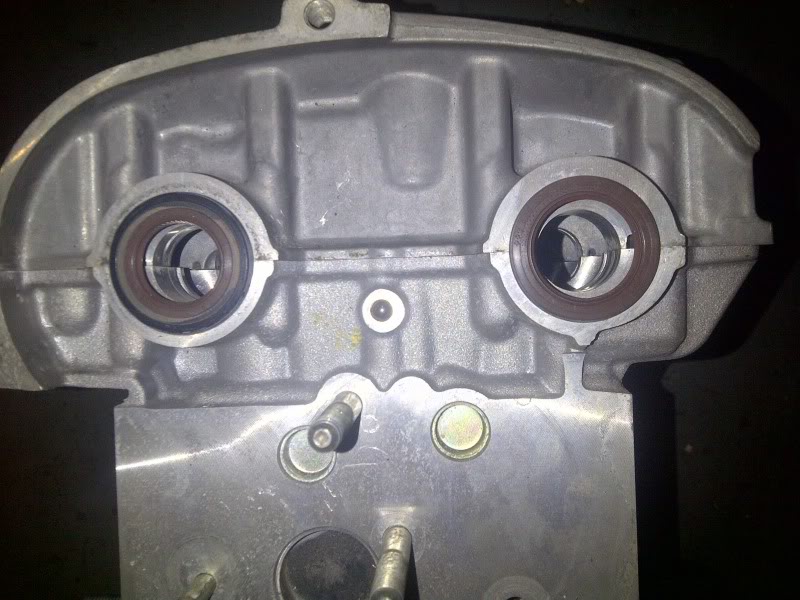

why? seriously! I may seem like a know it all arrogant sod on here sometimes, but for f***s sake how can other mechanics be this dumb?

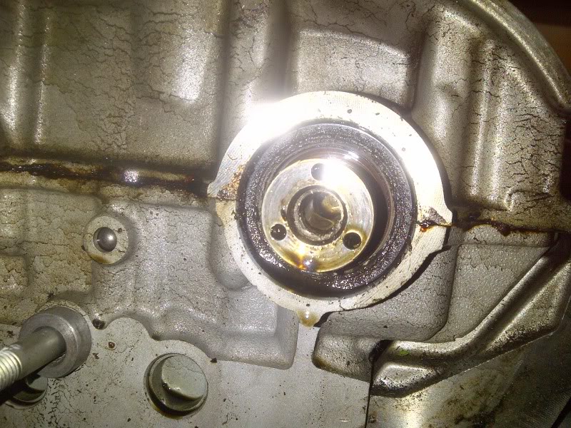

for those of you that don't know what the picture shows, its an exhaust camshaft seal in the inlet camshaft (wrong size) and the dephaser has worn through it causing a huge oil leak all over the cambelt = £700 bill
the last one i did like this was a £2K bill because the pulley had span and blew the engine to hell
choose your mechainc wisely PLEASE FOR THE LOVE OF GOD (or allah, rhianna, eva - whoever you worship)

I guess its another mechanics lack of knowledge on the F4R :(
Its suprising how much lack of knowledge folk have on these engines for the amount thats on the road.
Hows the dephaser looking ?
  Golf GTD Mk7
you meant inlet cam seal right ;) It is shocking that they would do that. It's not even close to looking sealed. Fooking cowboys.

How long has it been like that? must have been sounding bad :( I ripped one open last night where the dephaser went and all the inlet valves are f**ked. Lucky boy ;)

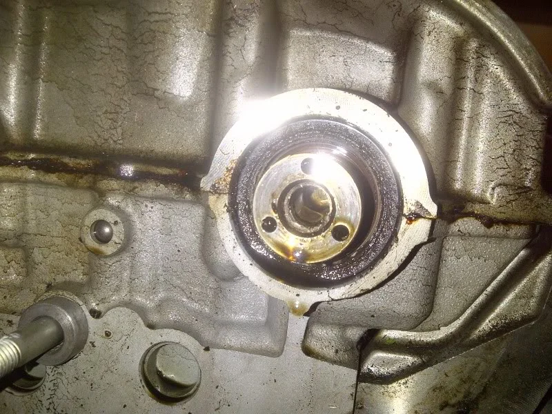

just rang Fred and the cam journals are lightly scored as well where it was down on oil pressure.
oh well!

Recondition customers own cylinder head as NES, supply gaskets and head bolts to suit - total inc. VAT - £566
Now, i dont know if they just reconditioned the head, or fitted it.
A week earlire Renault Croydon supplied 'Protector Belt - Part no. 7700113619 £33.75 inc VAT - is this an Aux belt?!
So, either the owner tried to sort it himself, or above company did it. EIther way, it was a f**k up.
However... my sticker on the inner arch states that the belts were changed at 55k. Either this is b****cks, or someone has re-used the belts when the head was changed. I believe both... I cannot find a receipt for any belts, or belts being changed, however, there is a lack of history before 60k miles anyway. ALthough i do have the mobile number of 3 of the previous 10 owners!
one year later Renault health check for another different owner noted oil leak.... at 71k miles (8k miles ago)
Cars owner changed again 2 months later (or there abouts), it then changed again 5 months later.
So a word of warning, research these before buying (hard as most of us own them already) and when the seller says, its a bit tappety on warm up, either walk away, or knock him down the £600+ its gonna cost you to sort it.
Dont buy a multiple ownered car with massive oil leaks.....
Like i did :rolleyes:
At least it will be sorted correctly this time!

I have a head the same as this... can it be reused?
Its scored the cam and the head..

its not the lobes that are scored, its the journals
fred said it will be fine

This is the same but its rather bad.. Im gonna get a pic see what fred thinks...
