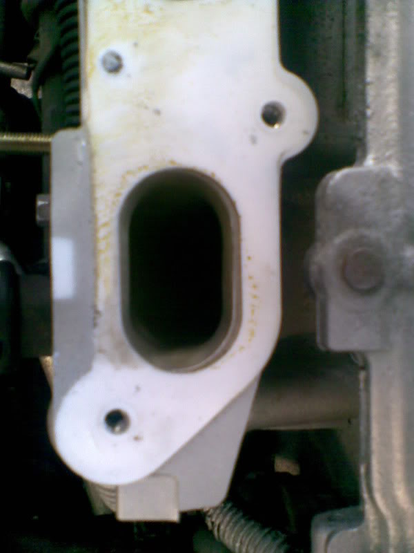

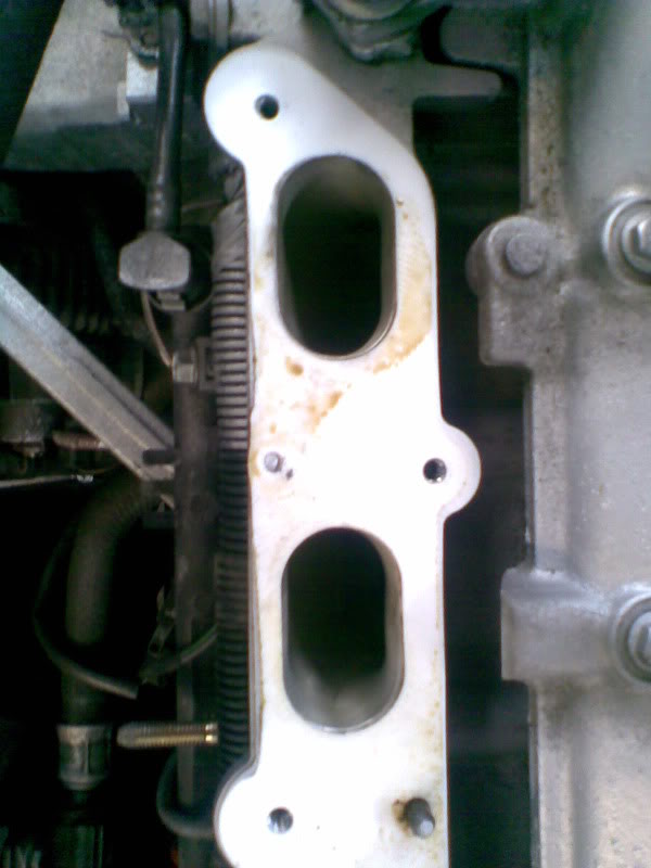

They were gaskets already fitted to cars and they just dont fit. I've modded them whenever i've seen them. They dont even match a standard gasket, they certainly dont fit a "matched" inlet
you saying they're not worth it danny? the ones in the pics don't look well made though, edges not cut straight etc. They a home made jobby by a customer?
Not worth it for the hastle IMO. Probably make a tiny difference to temps so they "work", but they dont fit. Gaskets pictured were supplied and fitted so they're not a DIY effort
