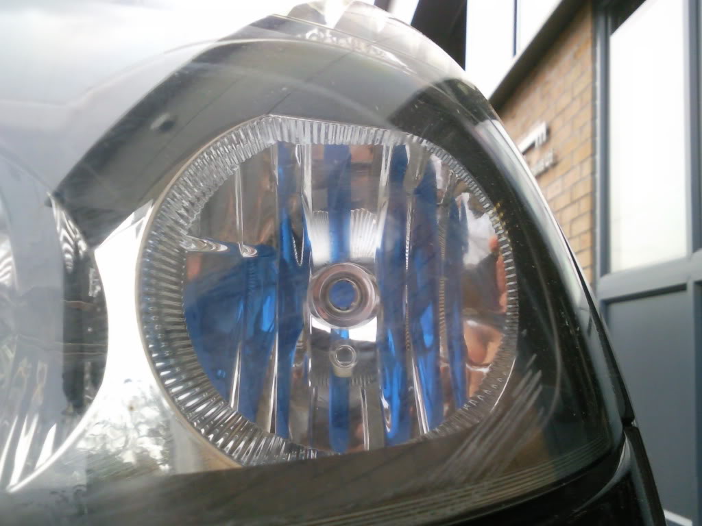

Hi guys anyone been pulled over for h.i.d's??
im on the urge of buying them after pretty much everyone seems to have them??
i have standard reflector headlamps, but this doest seem to bother most of people i have seen with them..
just want to get rid of this...vv
I wouldn't do it, purely for the reason they look crap with those lenses. Some people with replicas have the halo-projector headlights, but don't use the halo obviously.
My brother knows a couple of people that have been told to remove them, and have a garage check them, but not points. Trouble is, those reflectors aren't designed to have them in, and reflect/refract the light in a blinding pattern.
If you don't have projector type lights, you shouldn't install them, quite often they do cause issues with being far too bright.

looks like im sticking with halogen bulbs then :( and going with white ones :(
