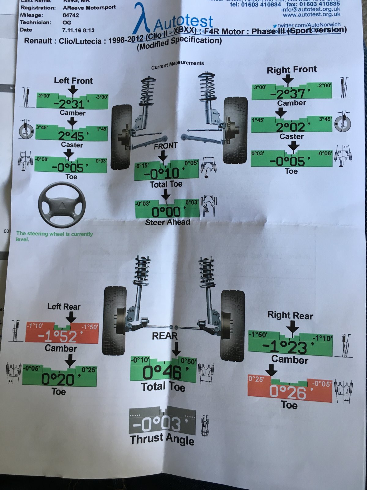

So this is the alignment set up After slight adjustment to right camber and toe.
  Clio 172
However from the looks of it, need to get some camber/toe shims to bring the rear toe from 20mins in/either side to more like 10mins or zero
  Clio 172
caliper off, disc off, stub axle off and then refit but with shims in place.
