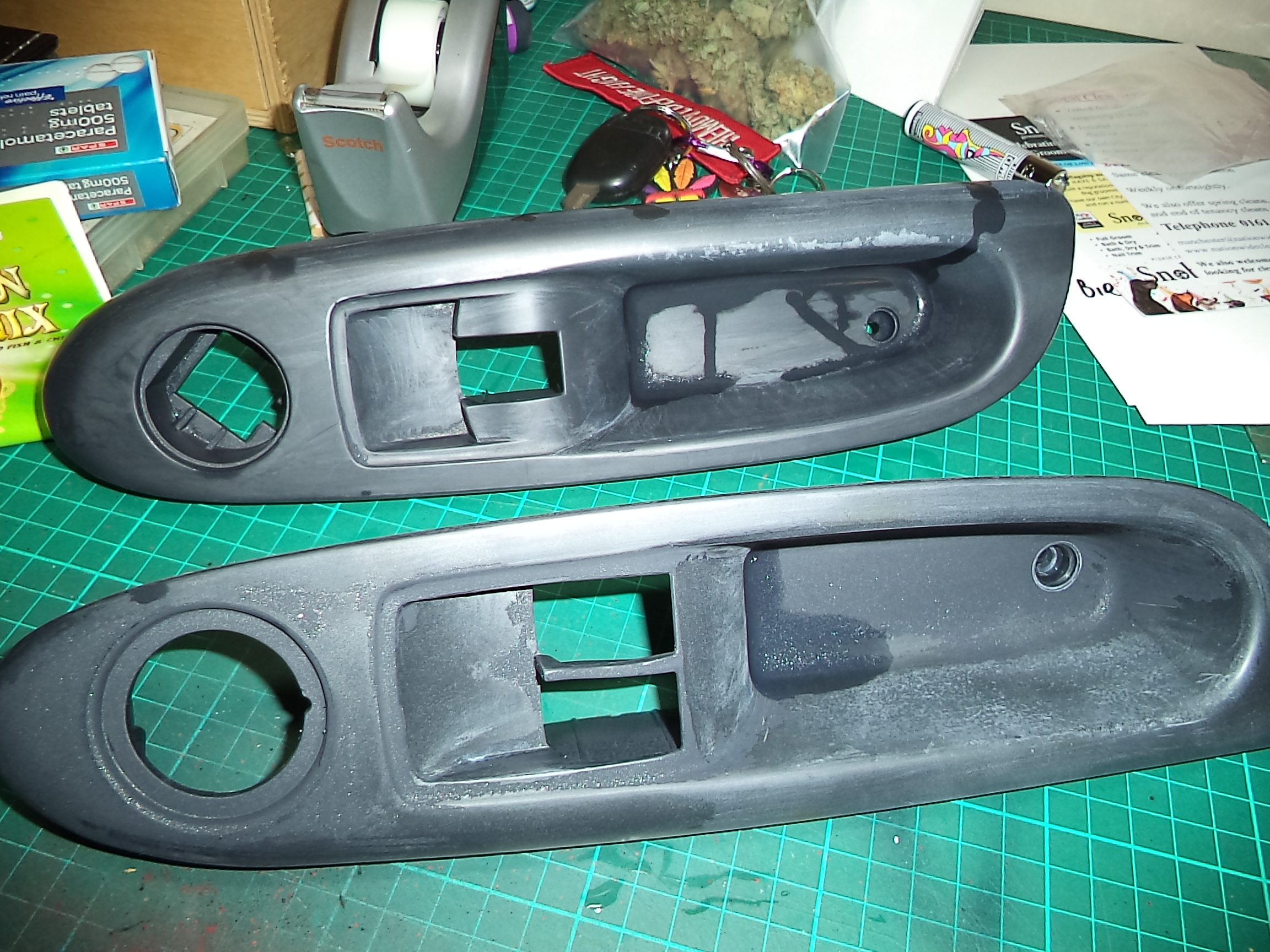

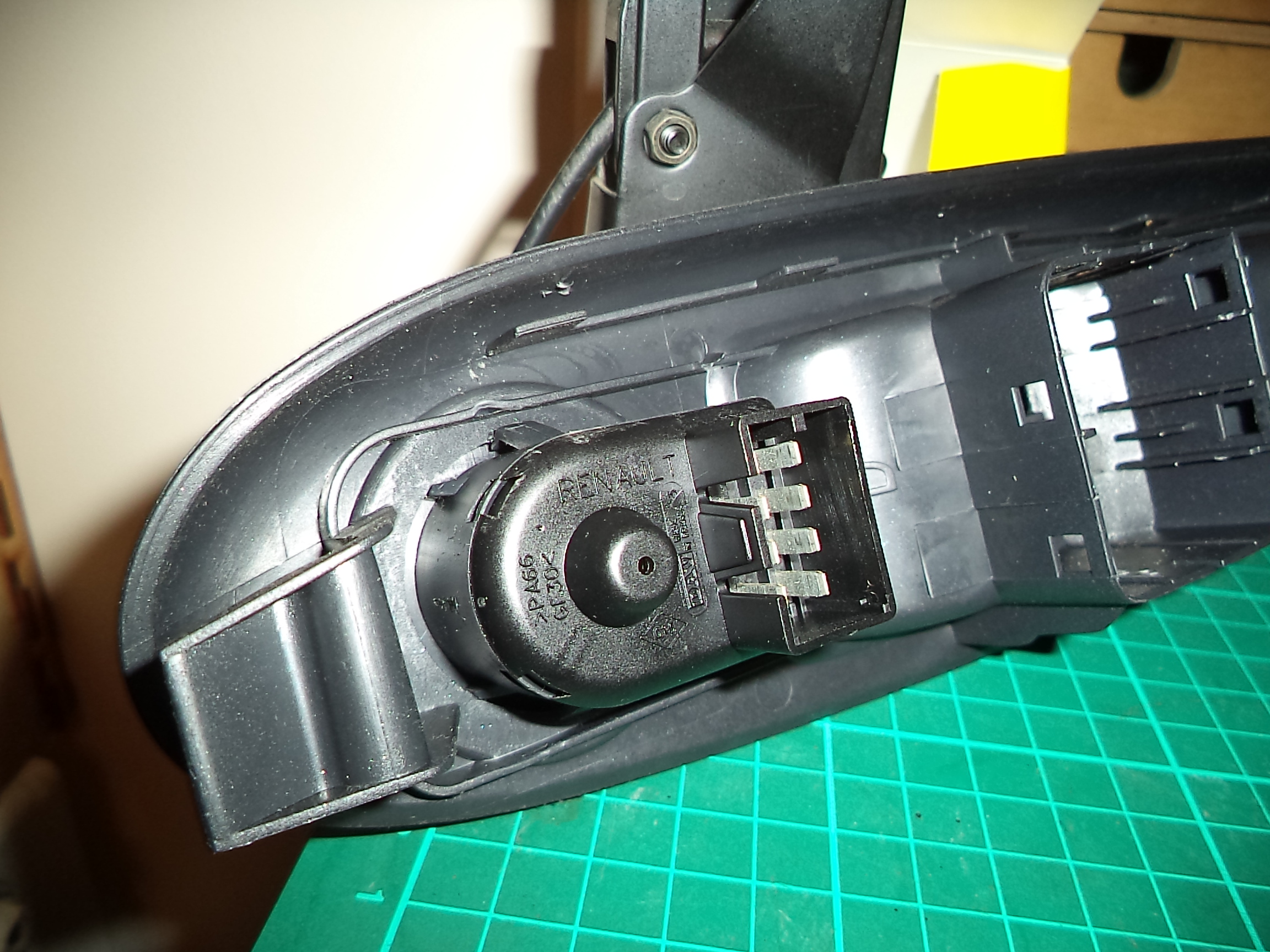

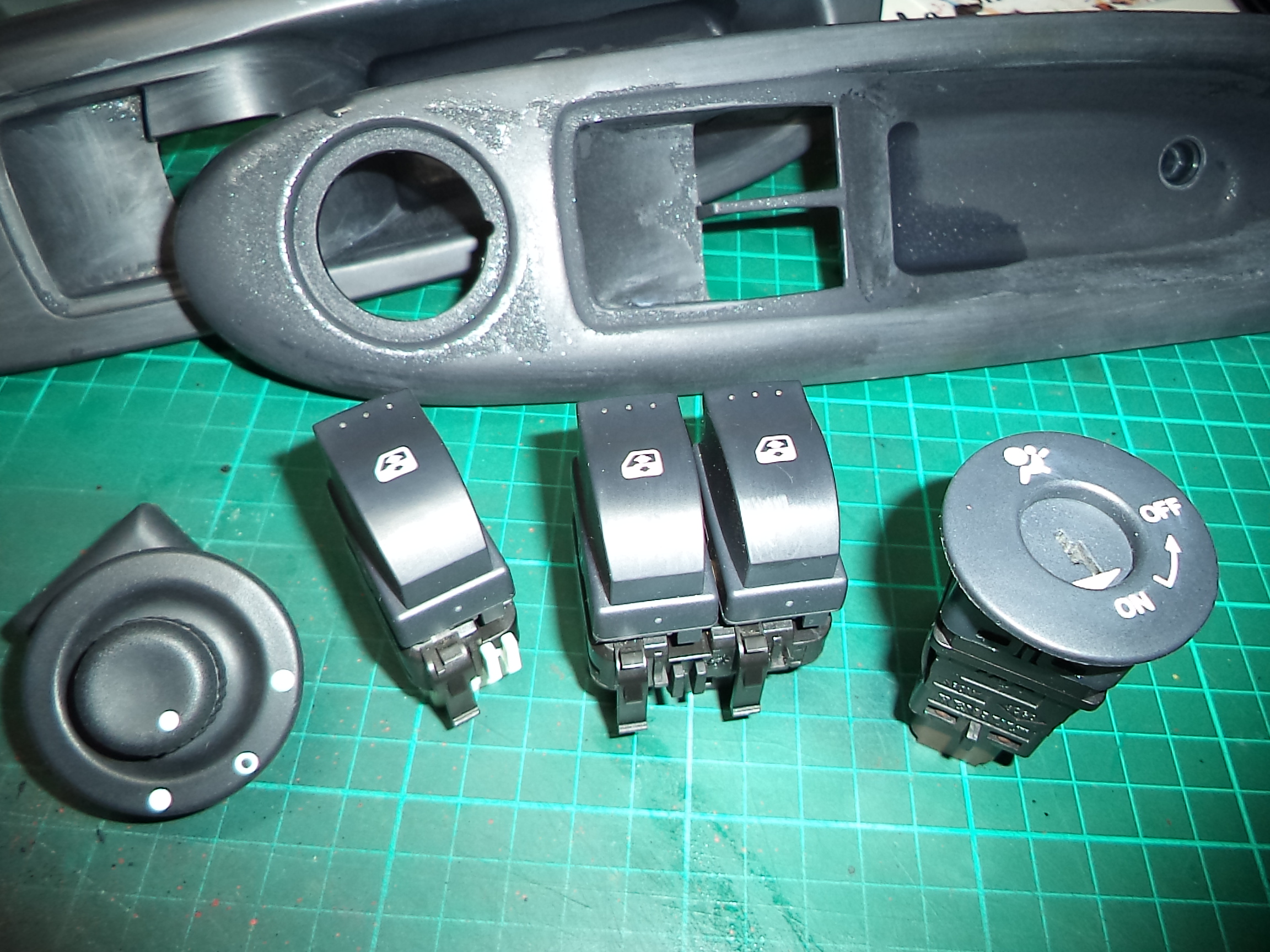

Seriously, been at it for 20 minutes! I'm trying to get all the nasty coating off and this switch is holding me up. Looks like there is two bits to squeeze at the sides but they hardly go in at all. Car trim is the work of the devil!

I remember having a similar fight with mine. When it did eventually pop out I was convinced I must have broken it.
It's horrible stuff to try and get off! Like a sprayed on glue / rubber coating. I've soaked in 'elbow grease' and given it a lot of my own elbow grease and a lot of scratching with my thumb nail. Hands are like prunes. Some of it is stubborn AF. Probably should have just bought new. The centre dash will be a nightmare. I might just have all of that flocked. I was looking and found these - https://www.flock-speed.co.uk/

I did the center dash with IPA (not the beer).
It takes some scrubbing, and you need to be careful you dont use anything too abrasive as the blue sparkly paint underneath is not that hard.
Also mask off the rest of the dash as the IPA will take the shine off the plastics.
Very hot water and a degreaser (dishwasher tablet) will also work on the handles
But i found this stuff did the job.

Scrape the sticky crap off with an old bank card or similar then take whats left off with elbow grease spray cleaner on a microfibre cloth. Its a bit tedious but much better than soaking in water etc.
Better just going to the scrappy and getting a pair of non rs door handles, cost you about £3
Looks like the best option for sure. I managed to get most of it off, and I'm going to try and get the rest off with Iso, but even then they will probably need keying, priming and painting. Would rather some hard plastic factory ones, were they all the same in all mk.2's?
