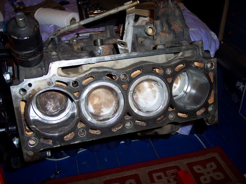

D Djw Dave Car Rb 182 Mar 4, 2006 #1 Been doing work on the engine and came across a wee problem. The surface between the head and the bottom end is dirty. I have cleaned it but it really needs like sanded off. see pic. Any one any idea on what would be best to use?? Cheers
D Djw Dave Car Rb 182 Mar 4, 2006 #5 Will a brillo pad work along with say some brake cleaner?? Cheers Fred-o
D Djw Dave Car Rb 182 Mar 4, 2006 #8 Fred2001Dynamic said: no i was joking!!! how stuck on is the crap? Click to expand... very! lol Ill give it another try with the blade and see what i can get sorted.
BenR Mar 5, 2006 #9 You can get gasket material spray to clean it off. Then check with a precision edge to see if its flat. If its not, a precision edge with 1200 wet&dry, be gentle and stop & check often, you dont have to do too much. Low points will be evident withing seconds, and if its flat, it will be aswell. But you have to be careful not to bow the surface.
