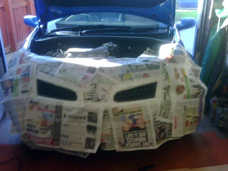

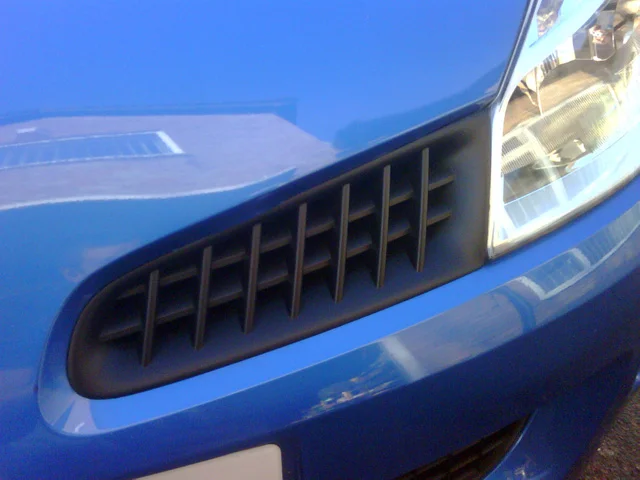

I currently have my 197 in my garage masked off all the front apart from the front top grille... it has had a weird watermark stain all over it for months, apparently a common thing with the grills.
Just a quick question, im spraying it matt black now.... should I laquer it?
Reason I ask because, they grills themself are flat in apperance and not shiny, but now if I just leave it matt black with no laquer will it mark over time? i.e. does it need laquer protection?
Thanks,
here are some pictures to make it more clearer:

did you prep the plastic in anyway so the paint sticks to it and doesnt start flaking of in a few weeks ?
Hi,
I used de-greasing stuff to make sure they were completely clean.
Yea its a mission to get the grilles out, jack car up, take wheels off, arch liners out, numerous screws, take front bumper off etc...
Just a general question wondering do they need lacquer as a "protection" ?
Cheers :)
  Astra GSI, 172, Golf
no they dont need lacquer. but you would be alot better prepping the plastic before painting as when it starts flaking its gonna look a real mess and take 10x longer to prep then respray again
Yea, was just something was going to try to see if it works mate, if it doesnt im going to buy the grills... but wanted to try this first !
Ok welll ill give a few layers... and then wont lacquer it and see what happens over next few weeks
it might last longer it all depends on how you treat it .. dont blast it with a jetwash etc
  Track 172cup
im sure you can get a sort of matt type laquer but it's not really needed imo, just mke sure you sand it down first and get some primer on there and you should be fine
  Punto/Clio GTT
doesnt need laquering, but definatly needs prepping or the paint will just flake off at the first sight of water.
good prep= good finish
