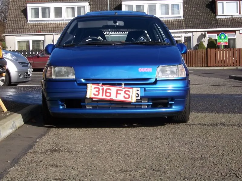

wow a clio on cliosport. nice one.
i like the ouch sticker.
whats the red plates about, u see them on new cars!

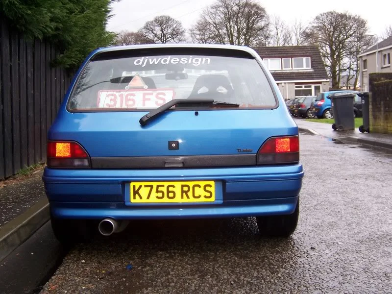

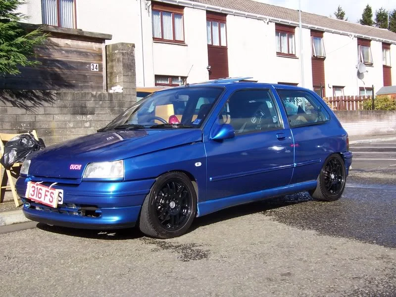

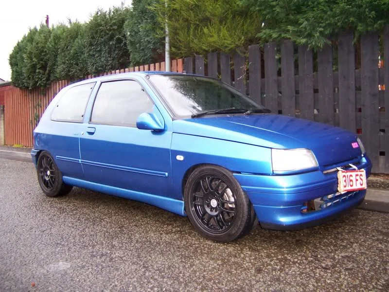

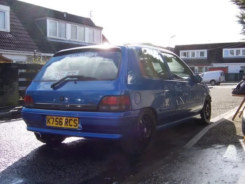

Engine:
1.7 B18ft Volvo turbo unit – rsi engine mounts – Forge actuator – blue silicone vacuum pipe – Forge intercooler – custom pipe work – Bosch re-circ valve – green air filter – Pipercross breather – 16v Fuel pump – Custom Down pipe – De-cat – 3.5” Inwardly rolled Piper back box
Transmission:
Clio Rsi gear box – rsi drive shafts – strengthened dog bone mount
Suspension:

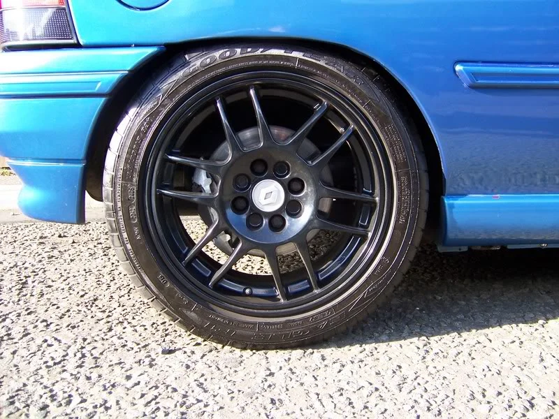

Fk Konigsport adjustable coilovers (front) lowered approx 70mm – Torsion beam lowered to match – Koni adjustable shocks (rear)
Wheels and tyres:
15” Oz F1 Cups powder coated in black - Goodyear Eagle F1’s 195/50
Brakes:
1.8 16v front brake conversion 260mm discs – Rsi rear disc conversion – DOT 5.1 brake fluid
Exterior:
Clear side repeaters – Rsi skirts – Phase 2 front grill – DTM mirrors – 16v spoiler – Phase 2 rear boot panel – debadged all round – colour coded – Volvo 940 turbo badge painted black
Interior:
16v black carpet – 16v rear bench – Corbrau Targa front seats – Willians 3 point harnesses – phase 2 heater controls – 16v steering wheel – Push button start – Greddy turbo timer – 16v top dash – 16v oil gauges – boost gauge – Sparco gear knob – re-trimmed door card inserts – Williams F1 team mats – A pillar gauge pod – Alloy tax disc holder – Stainless Steel ‘Clio’ sill plates – Manual fan switch
Ice:
Alpine 9807RB CD head unit – 13cm Vibe SE-K50 comps – Alpine 250w amp – Pioneer 760w amp – 2*12” Pioneer subs – Colour coded power cap – Fully sound deadened – Autoleads wiring throughout
^^ Spec list (from what i can remember)

Car looks nice, love the black wheels. I'd take the turbo badge off the back though tbh, let it shock a few people:)
  Rb 182
Its funny when people turn around after the slight tish not looking for a clio. lol
"The what the f**k?!!??" look so funny.
That's looking good Dave :)
I think the badge is subtle enough that most people wouldn't notice it anyway - keep it!
  Civic Vtec y0
Very nice mate, would have looked better with a single wiper conversion tho lol ;)
Looks good that mate. I was thinking of saying go for a valver front end but thinking about it dont think you should. Looks more subtle like that.
However i would lose the turbo and ouch sticker.
