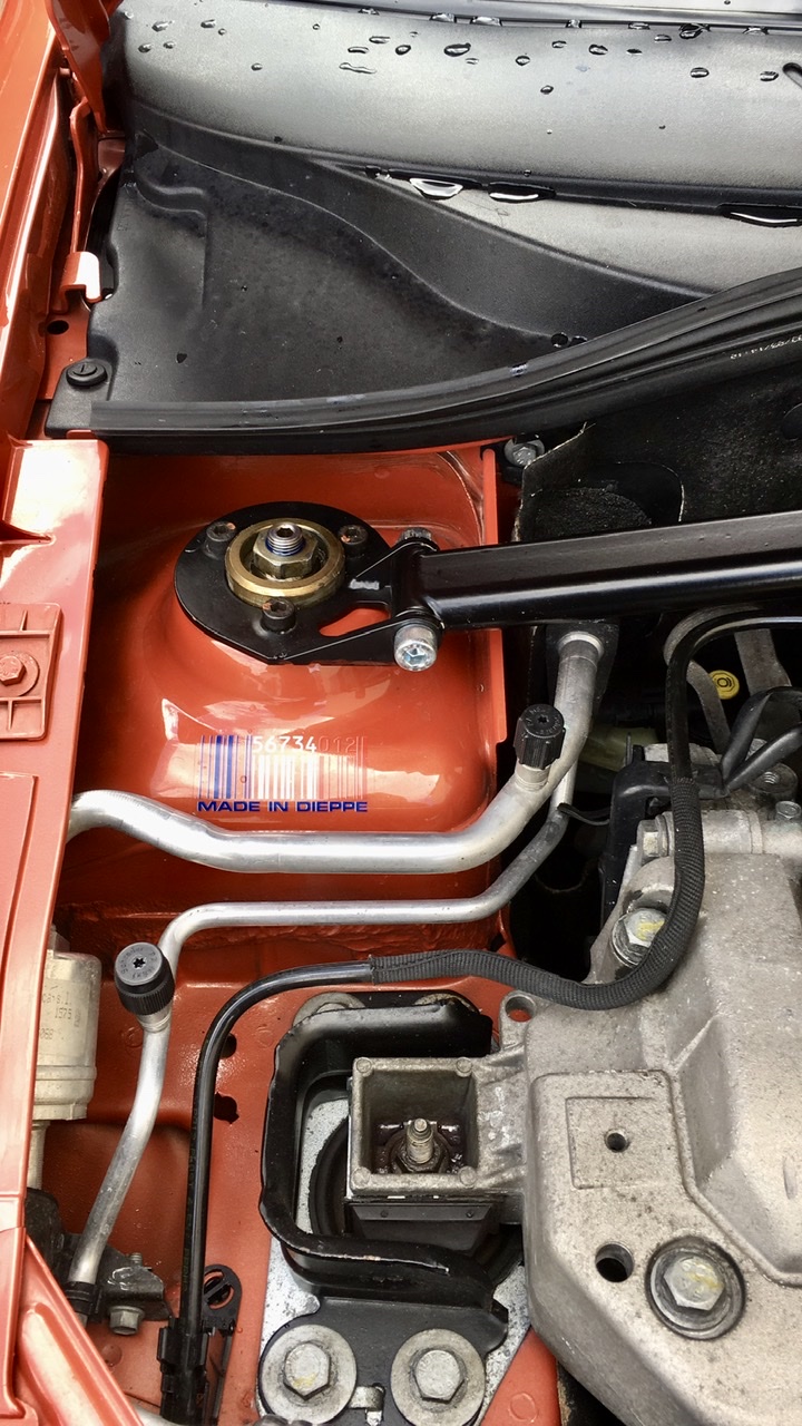

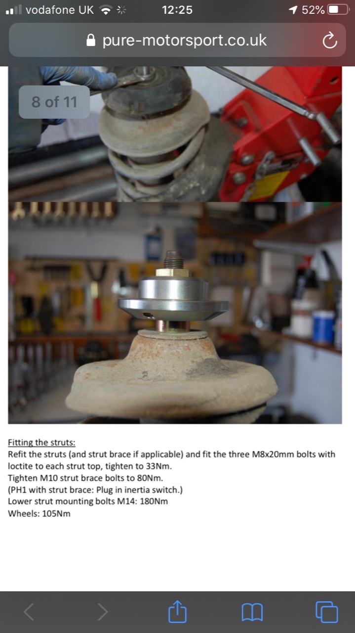

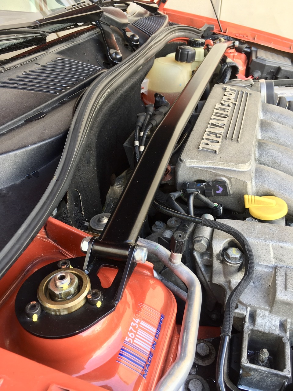

Guys,
Can anyone quickly tell me the nut torque for the strut top? The large 24mm strut securing nut
Not on the PMS site from what I can see.
Thanks.
I know this is not the answer youre looking for but, as tight as you can. Ive had this nut start to come loose a bit ago on ast top mounts. Im on bc top mounts now not sure if theres any difference but I check them every so often and they havnt budged since.
frayz
Thanks Zach.
I did just do them as tight as I thought with loctite 243. Paint marked them and see how I go.
