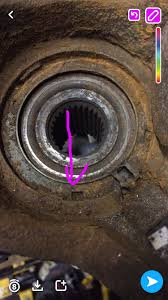

They just clip in to a metal ring behind the wheel bearing mate.
They may be retained by a screw i can't remember, but it's easy enough.
Then just unclip from the behind the arch liner.
Very poor image off the web, but you can see where it clips to here.
Not where the arrow is pointing to, just to the right.
