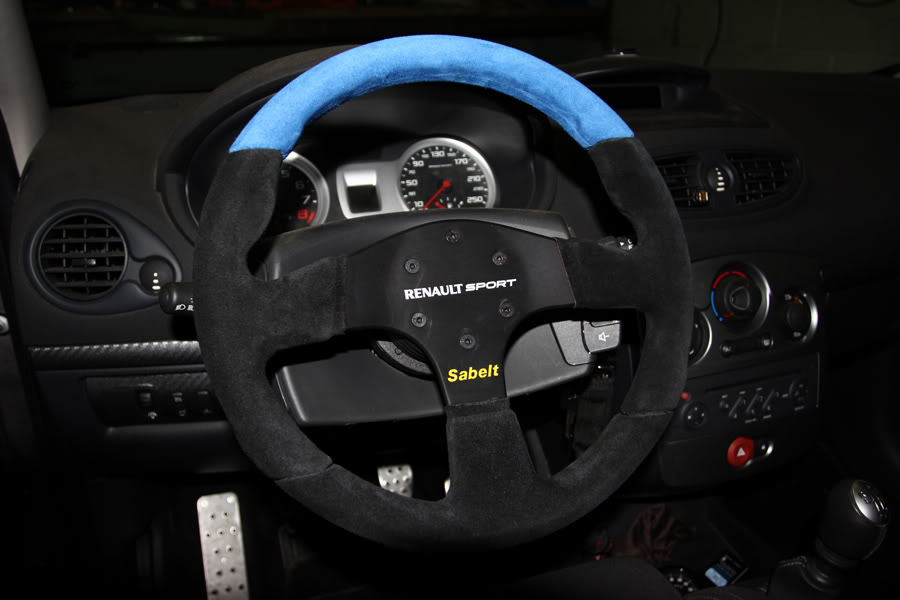

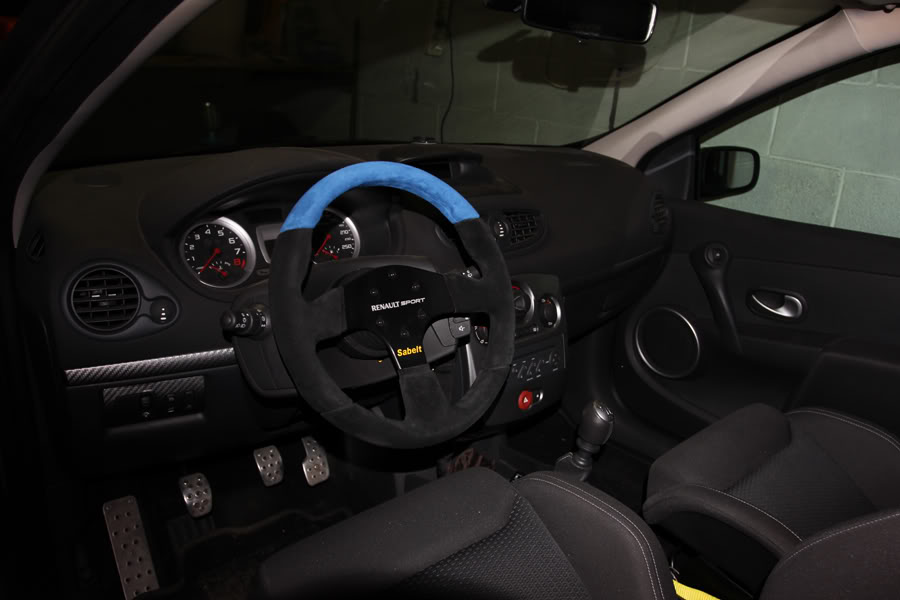

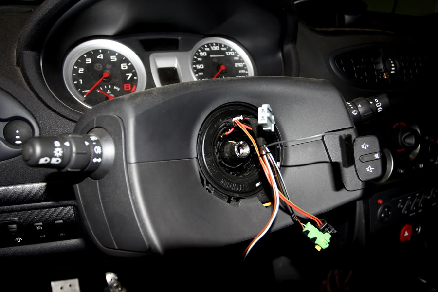

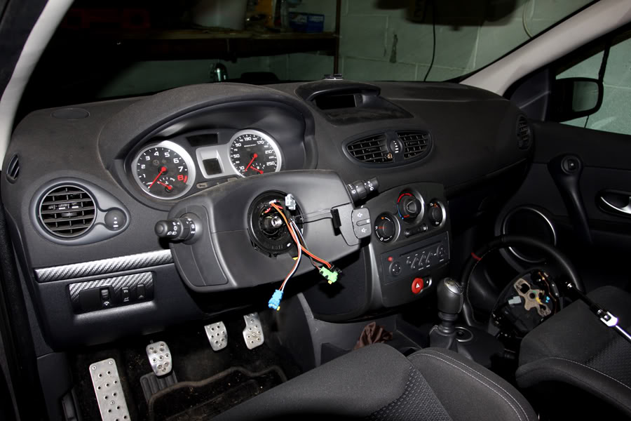

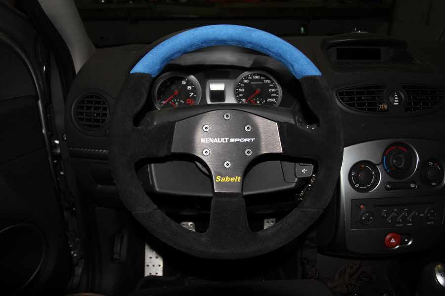

r27 + 'ring stickers and new steering wheel....
Car  rs r27
r27 + 'ring stickers and new steering wheel....and others mods....

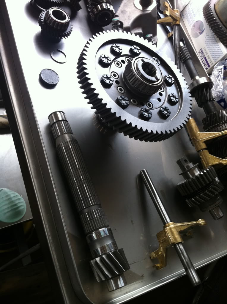

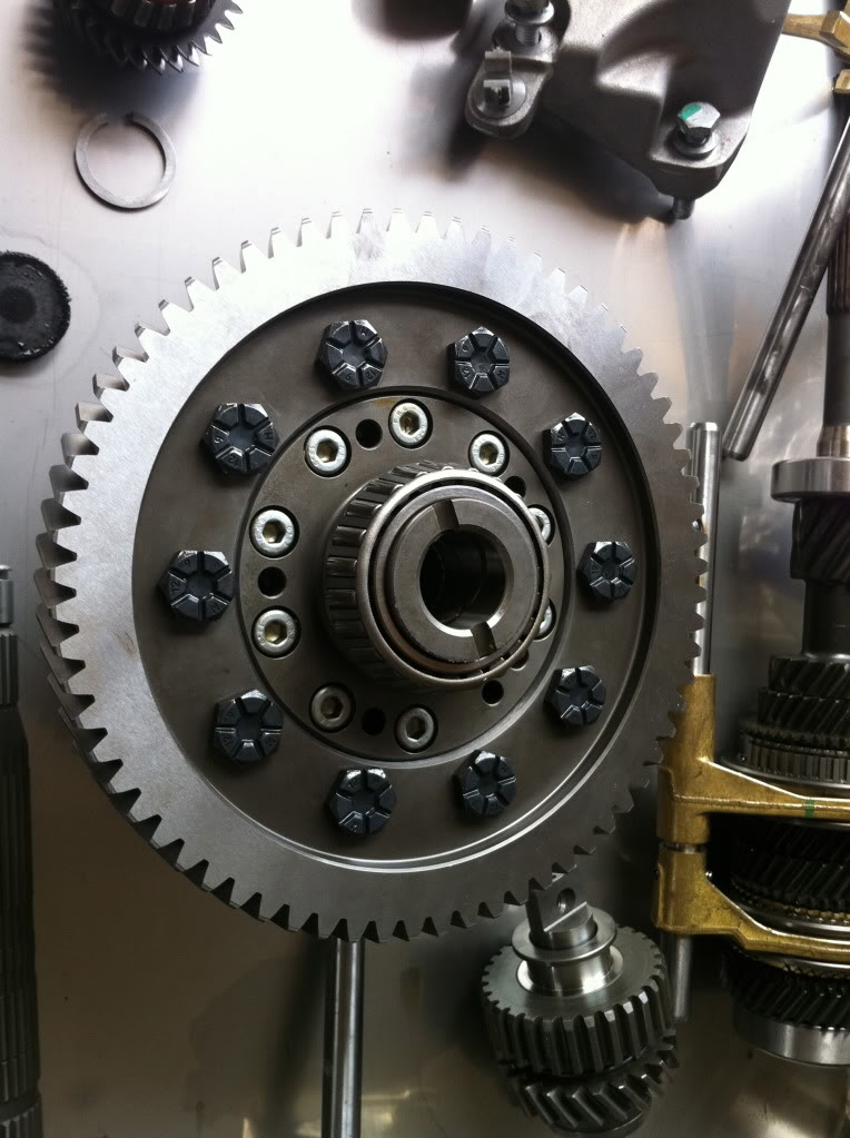

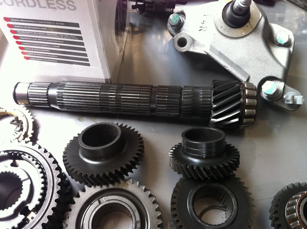

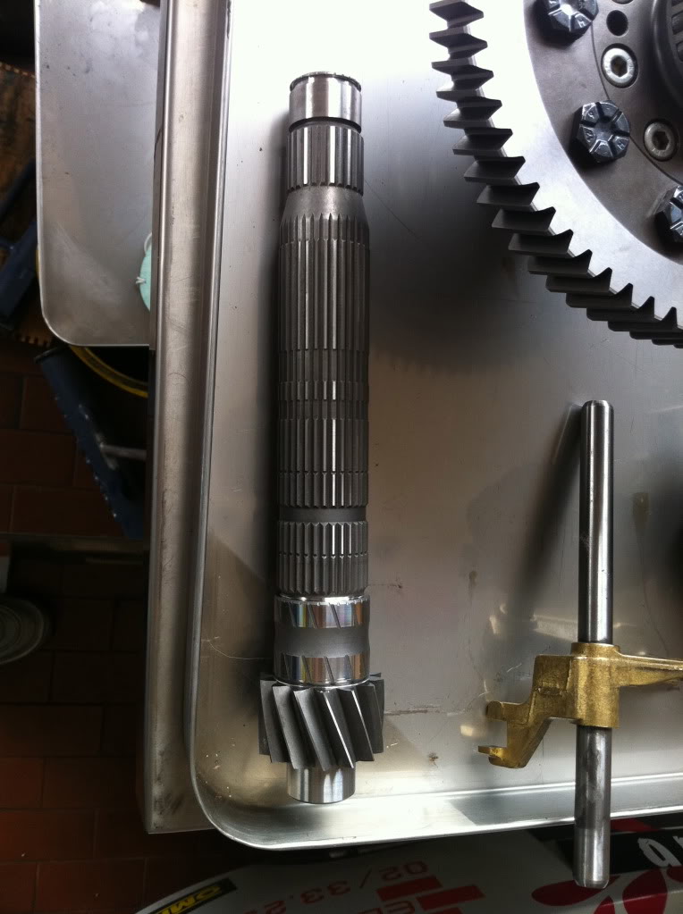

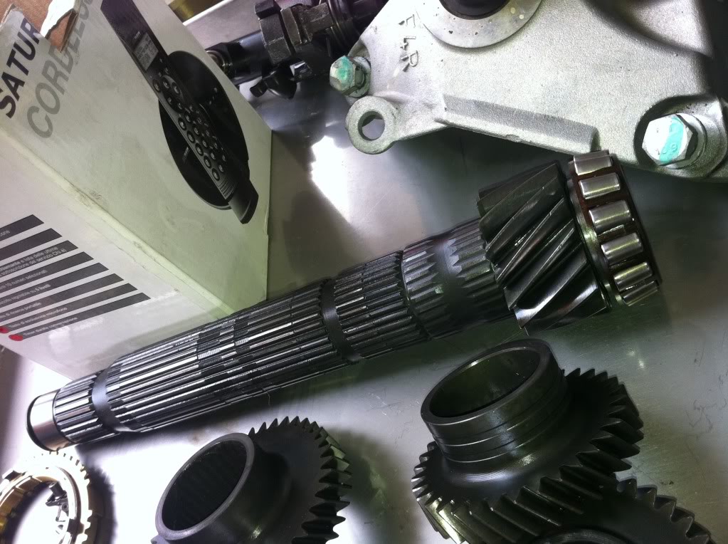

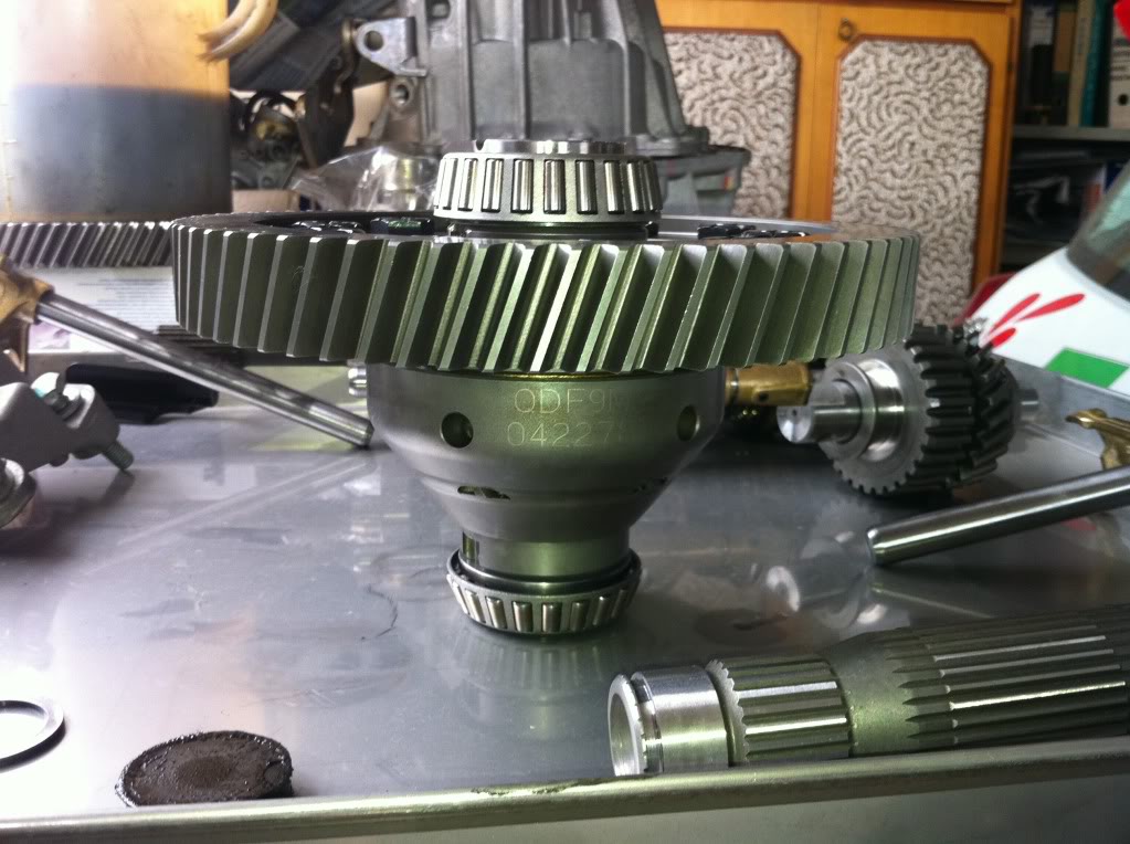

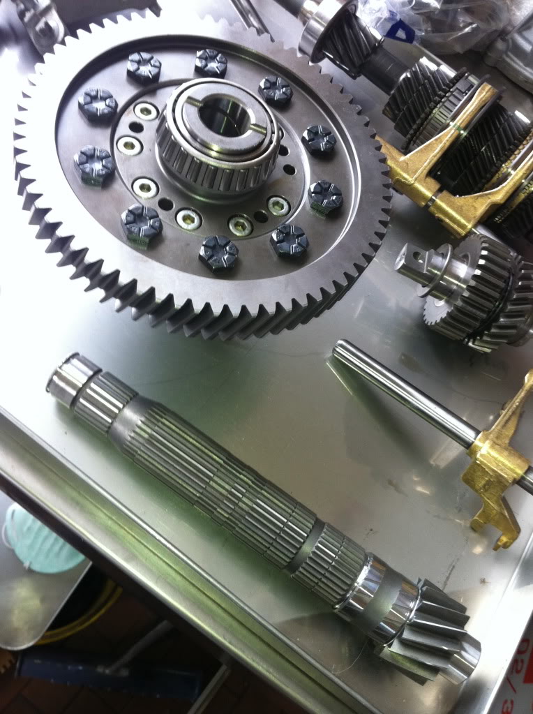

New couple 14x69 and the differential
The original couple

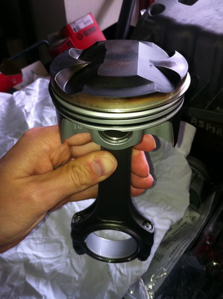

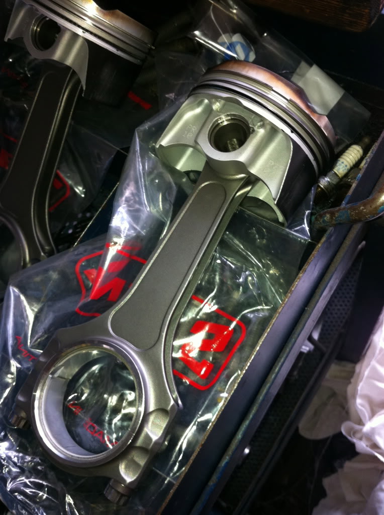

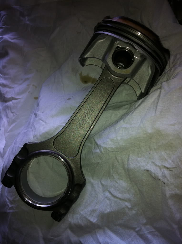

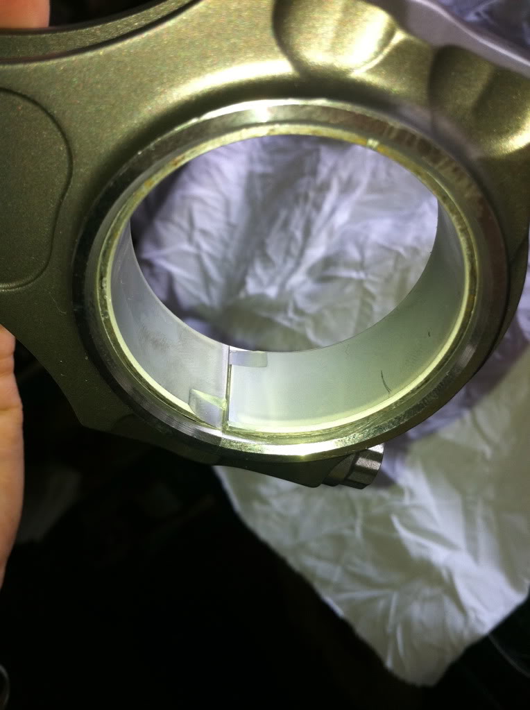

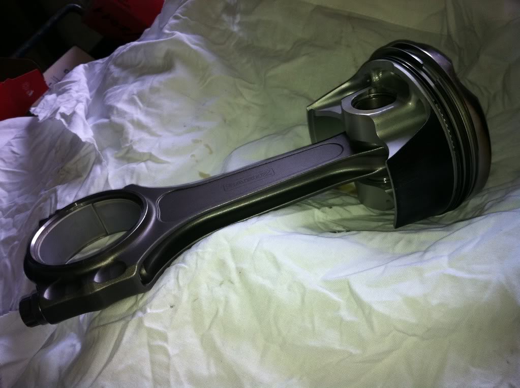

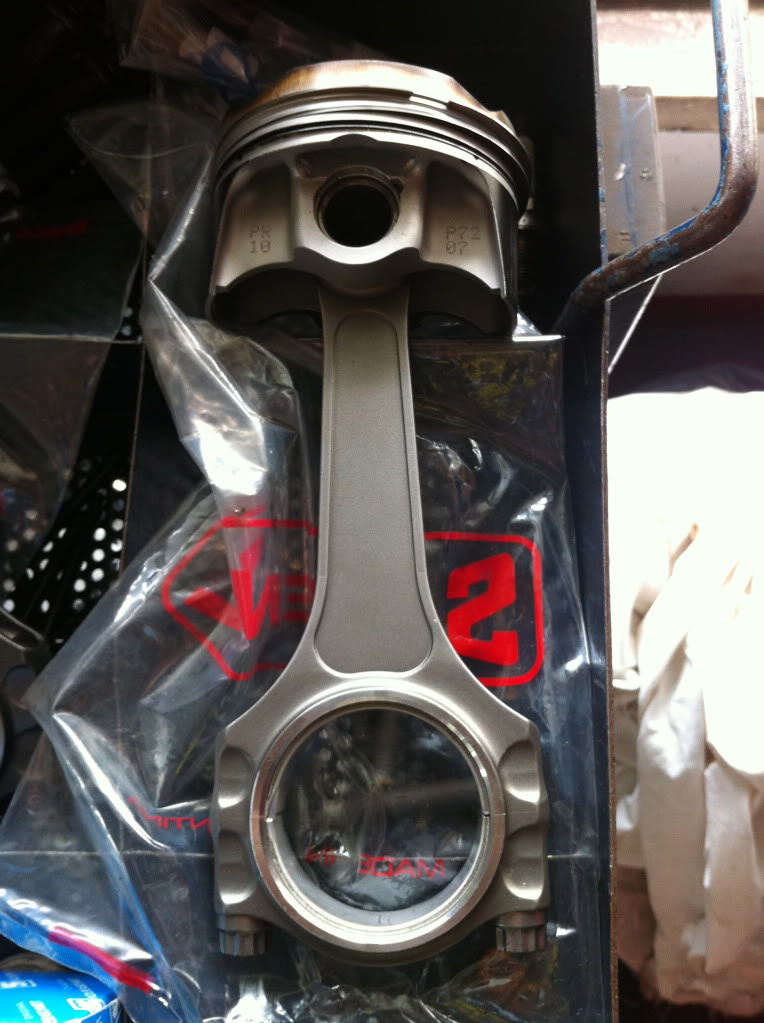

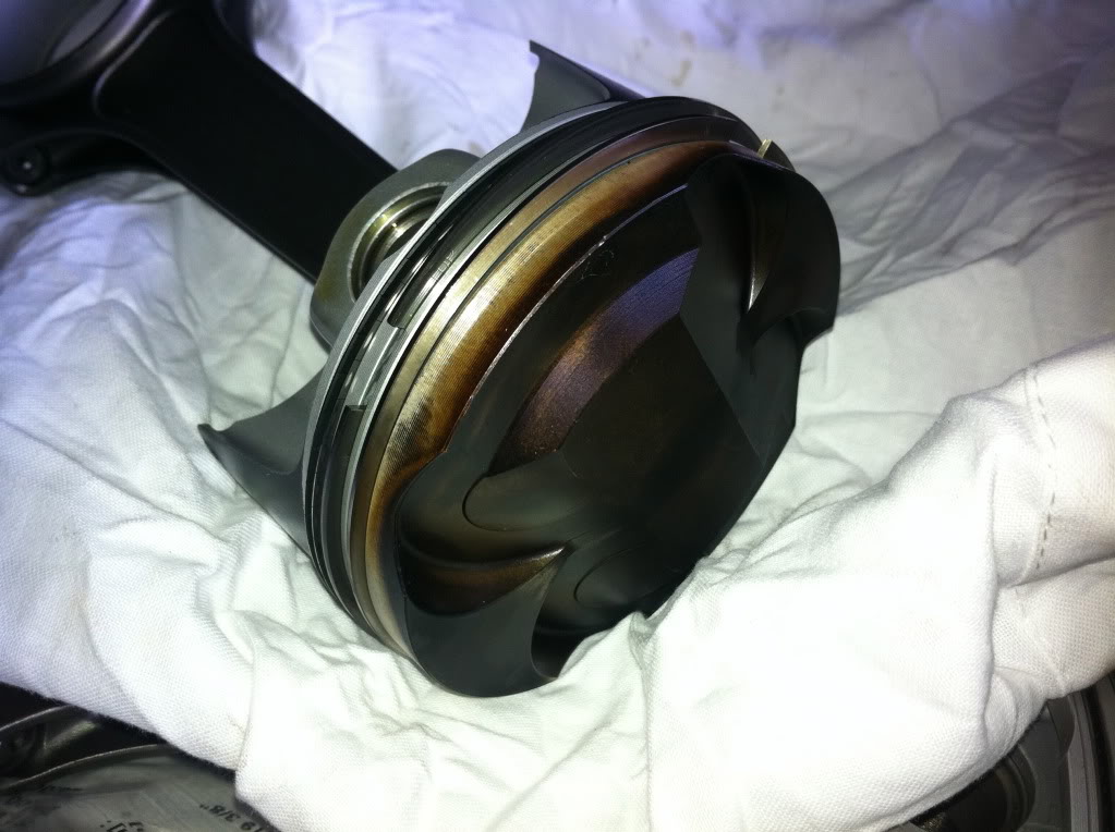

New connected rods

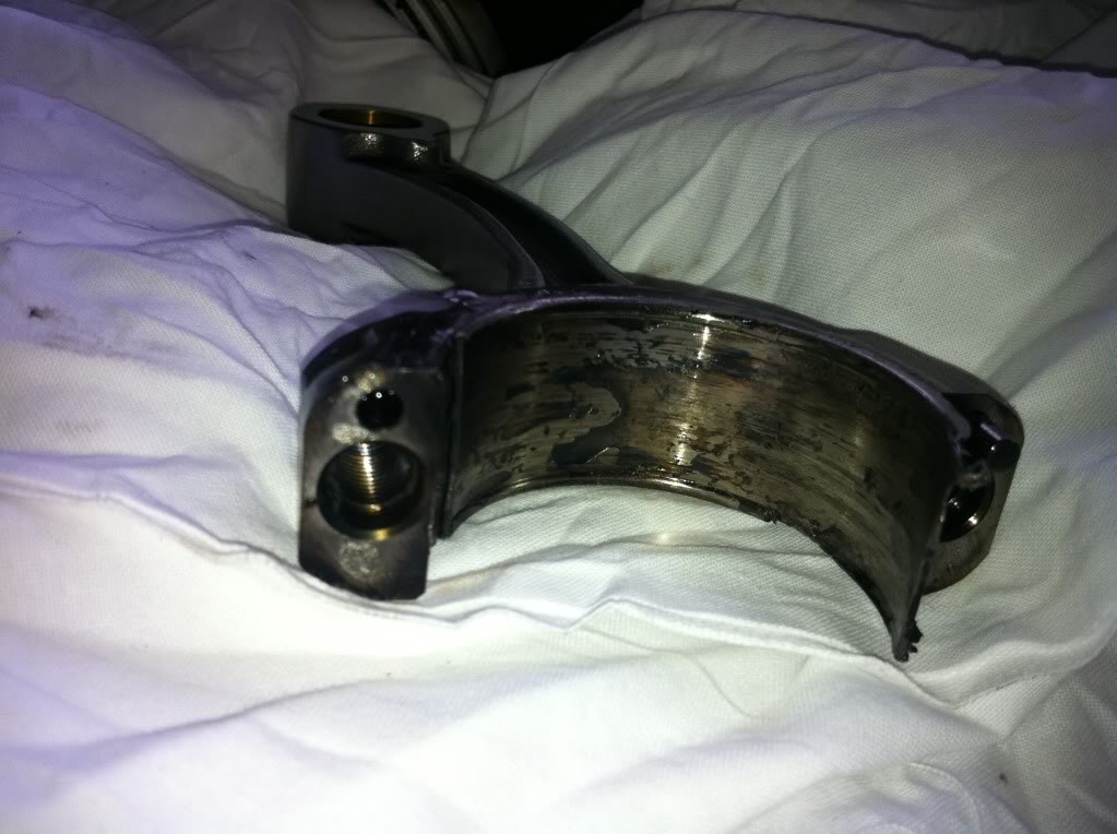

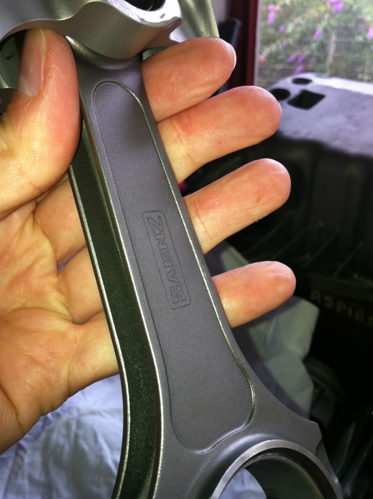

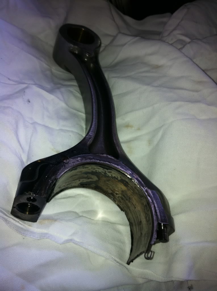

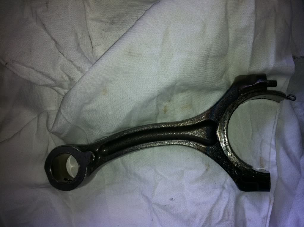

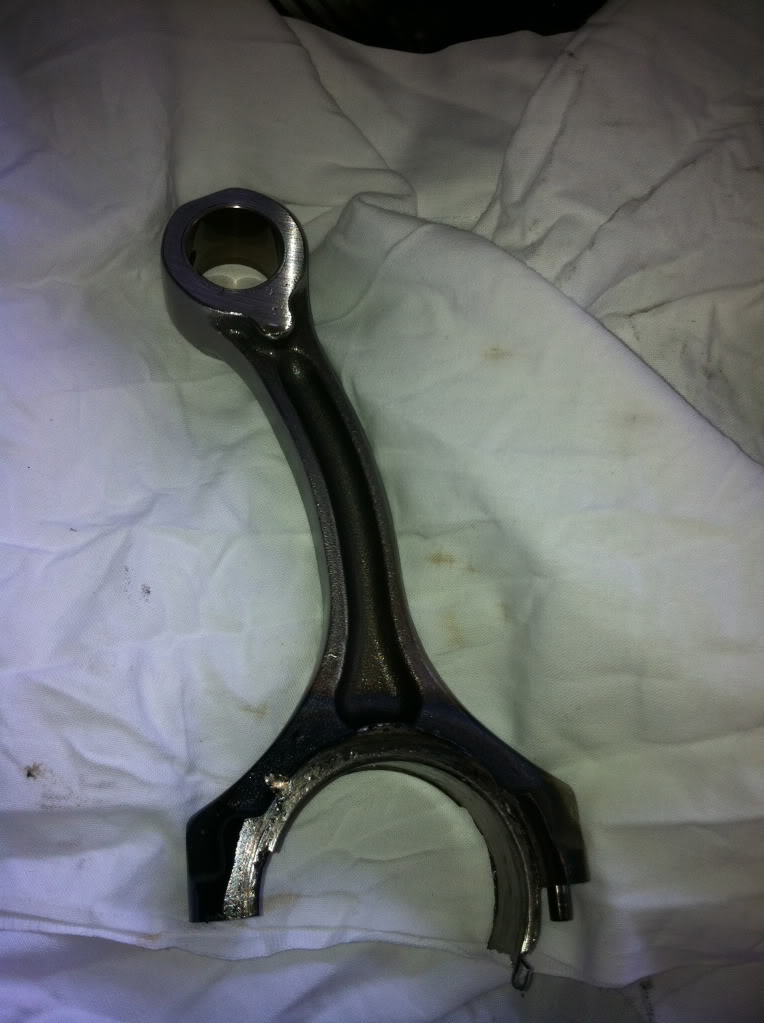

And the old connected rod, broke at the ring........
it happened @ the ring!
i don't know, maybe too little precision from renault, the bearing run into the conrod and made this.....

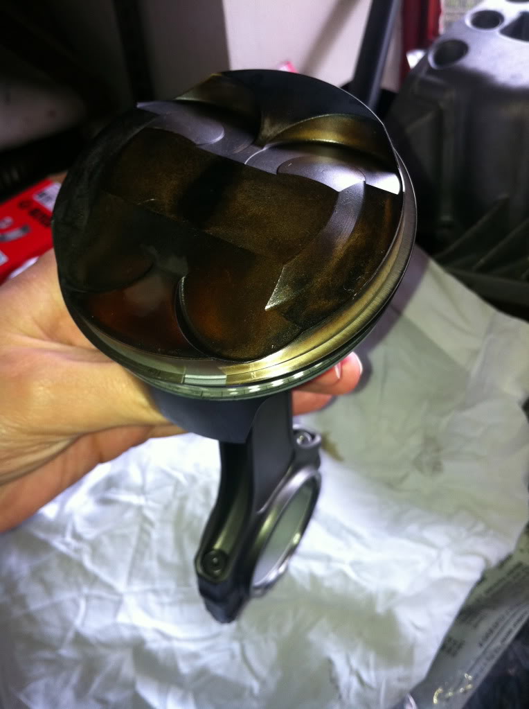

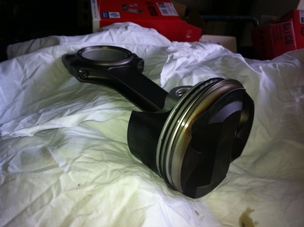

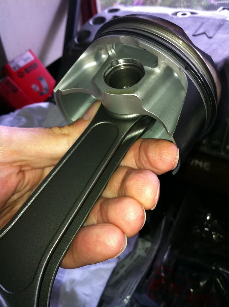

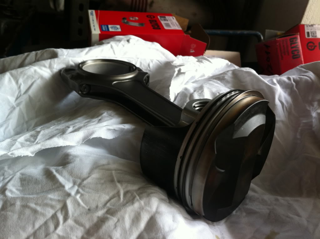

New set up looks lovely. That a standard piston? Looks frickin mental with those valve cut-outs!!
No, theme are r3 evo 250..
I've them and others from december!
Great.. Now i complete the engine with evo250 crank.. And:
Light flywheel, new short couple 230kmh @ 7500 in sixth gear, quaife diff...
