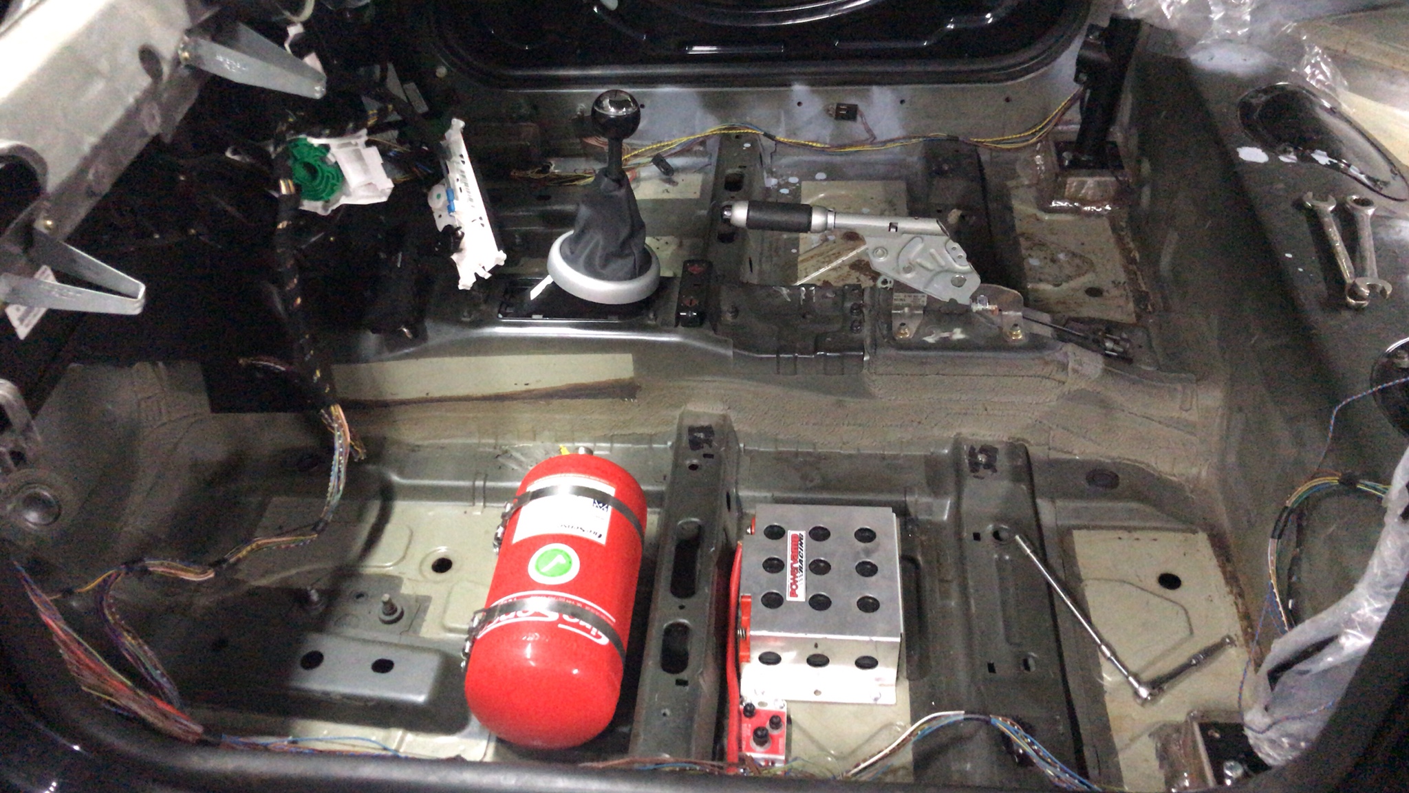

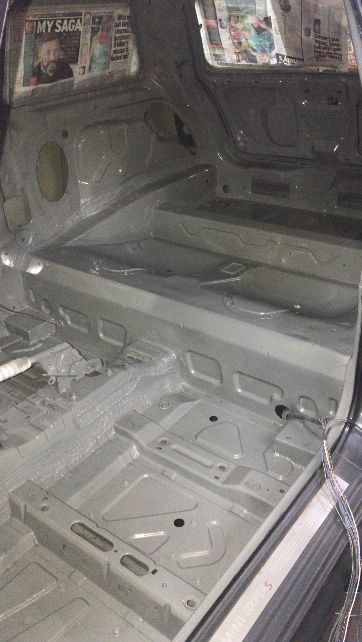

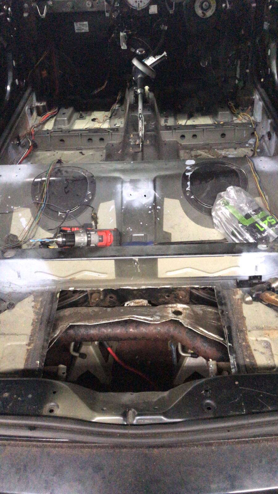

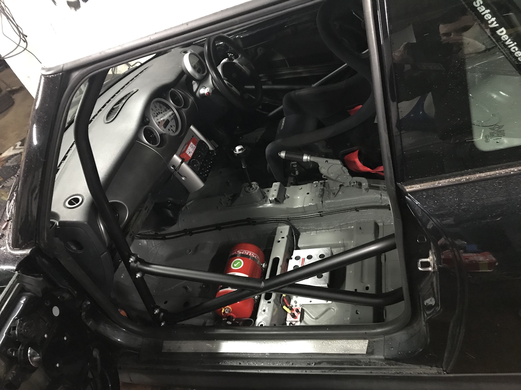

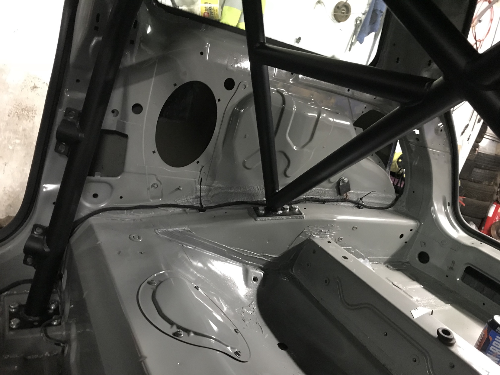

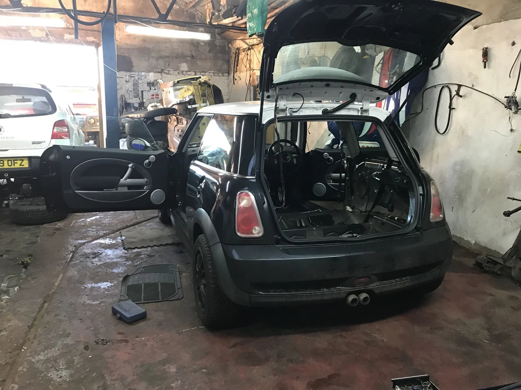

First off I have started with the interior, the lot is stripped out, tar removed and cleaned, battery mounted, isolator, extinguisher, cage feet all welded in and loom cut back. I have seat mounts to weld in and the boot floor battery tray has been removed ready for a flat plate to be welded in. Once that’s done I’m waiting on my paint arriving to paint it.
I shall keep those interested up to date with the build. Aim is to be compete for testing in March!

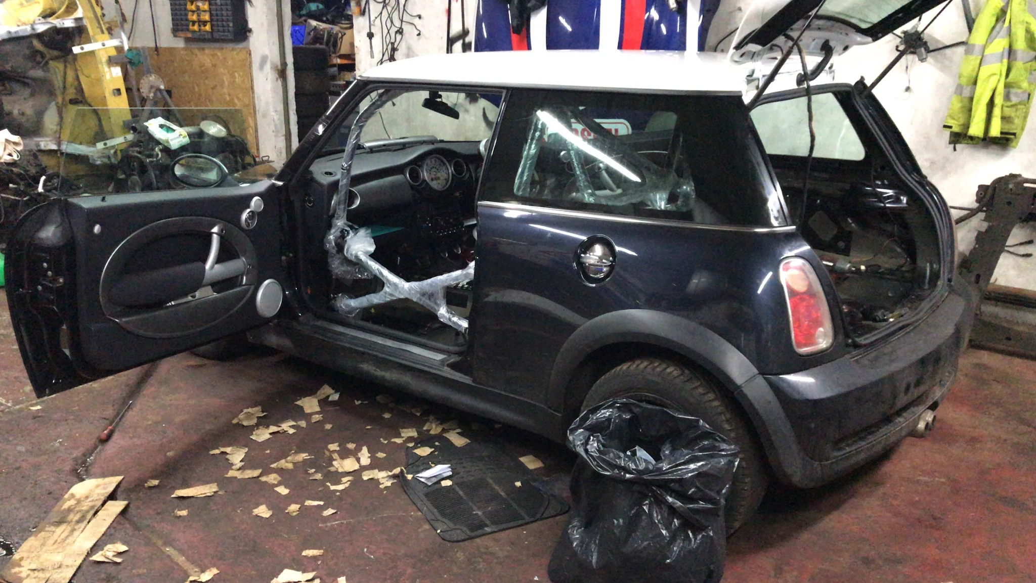

Well had another few shifts on the car and the interior is almost finished! Just ready for paint and then can finally bolt in all the bits.

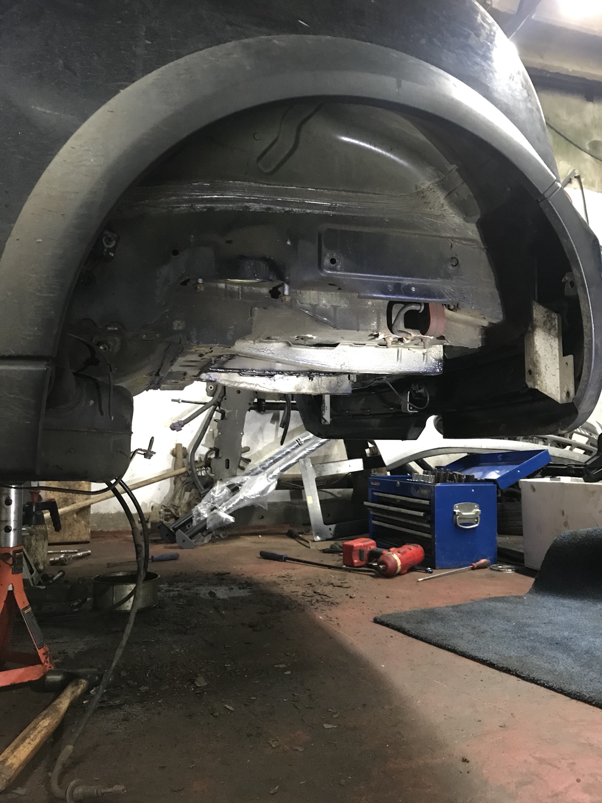

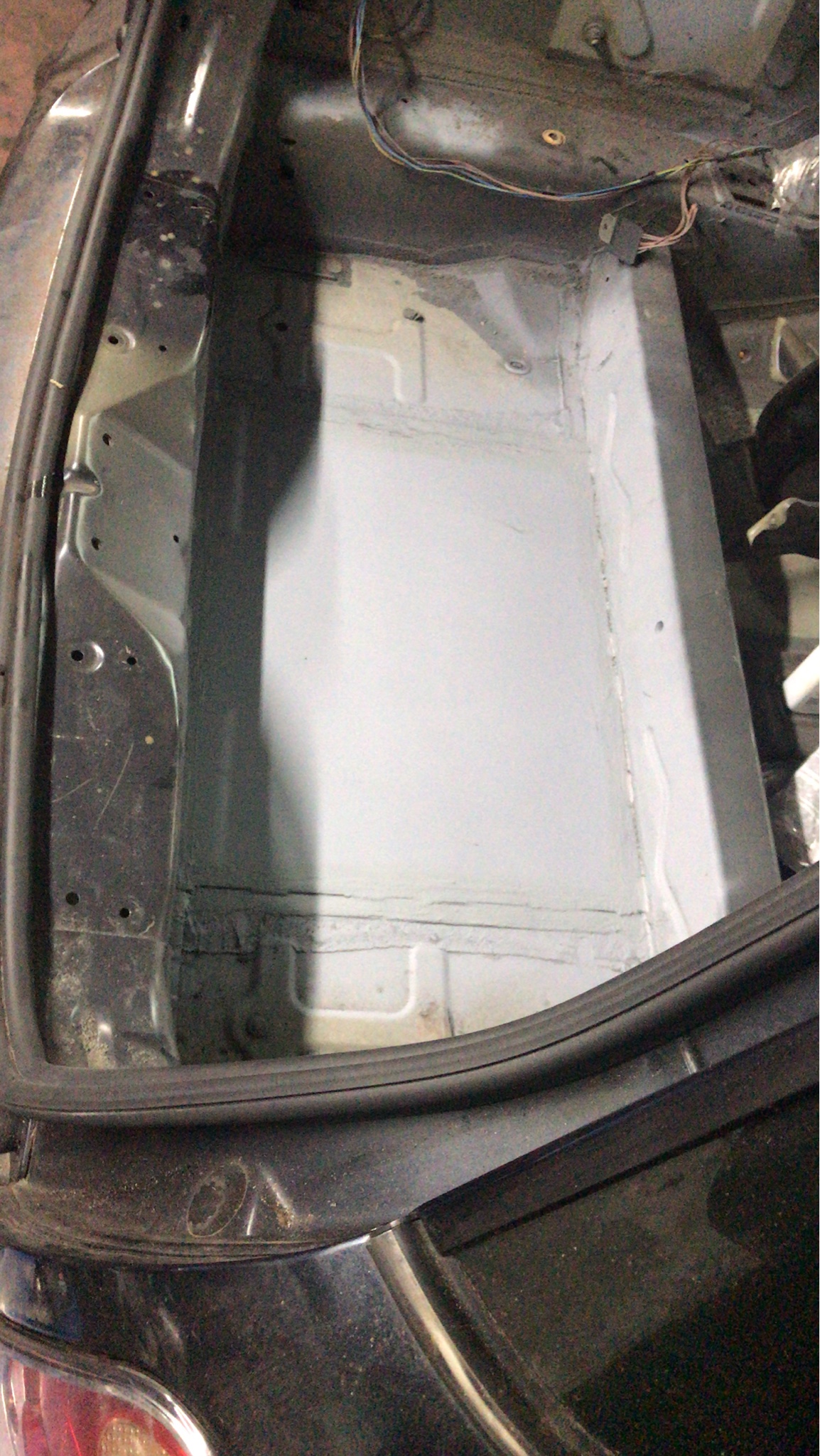

Original Battery tray cut out and a plate welded in place

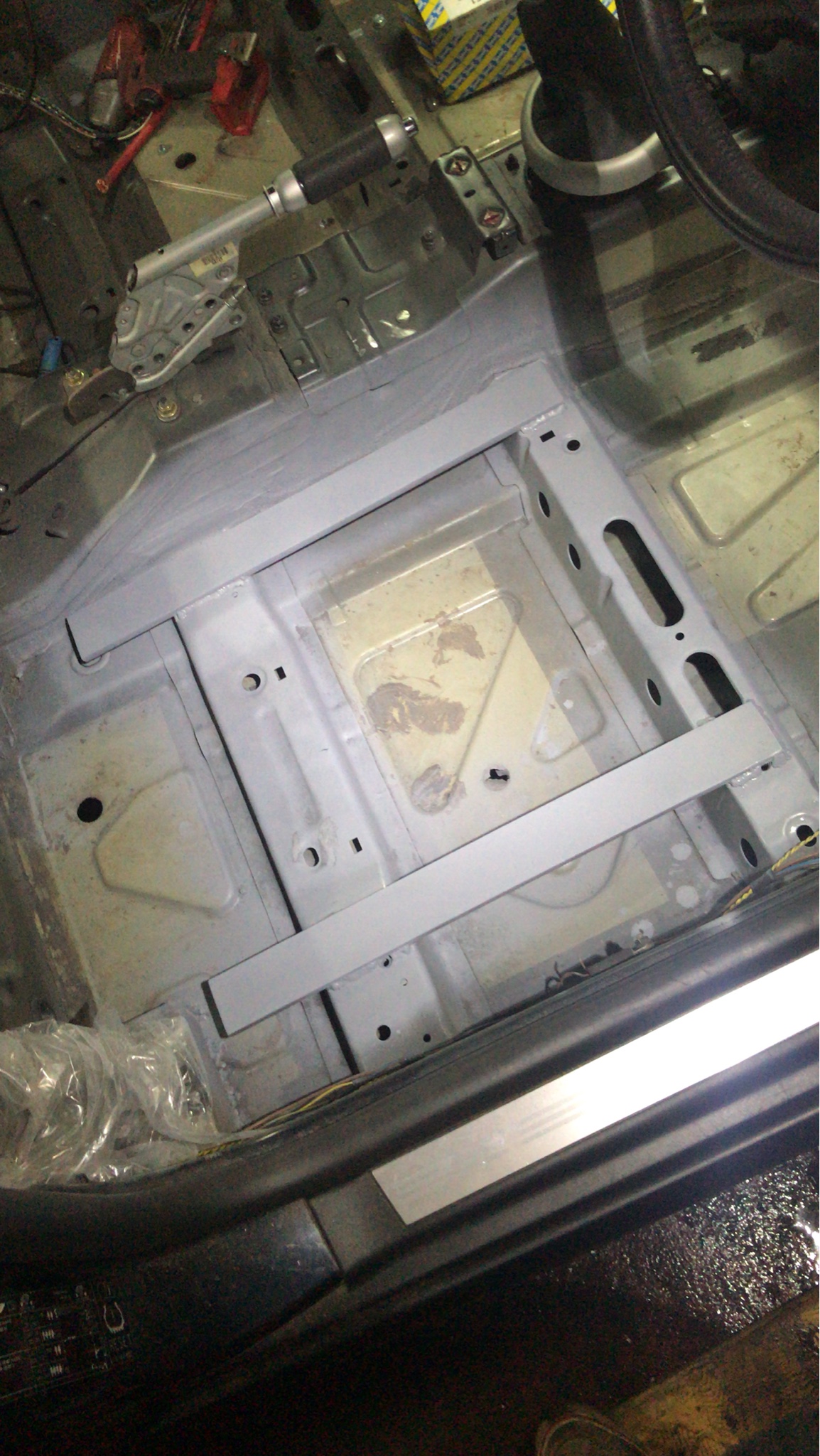

Regulation wise we keep standard seat mounts but are allowed to weld in plates to move them back so this is done.
Battery, cartek isolator and 4ltr electric extinguisher mounted (all rivnut for easy removal!) still to be wired in but this will be done after paint

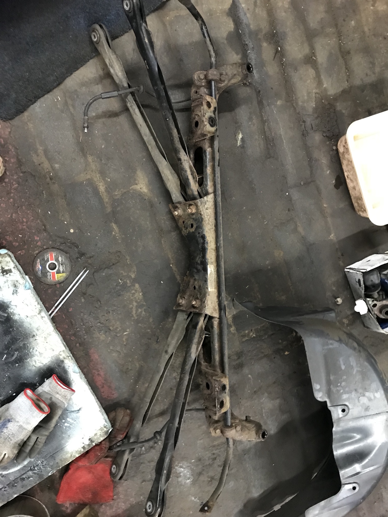

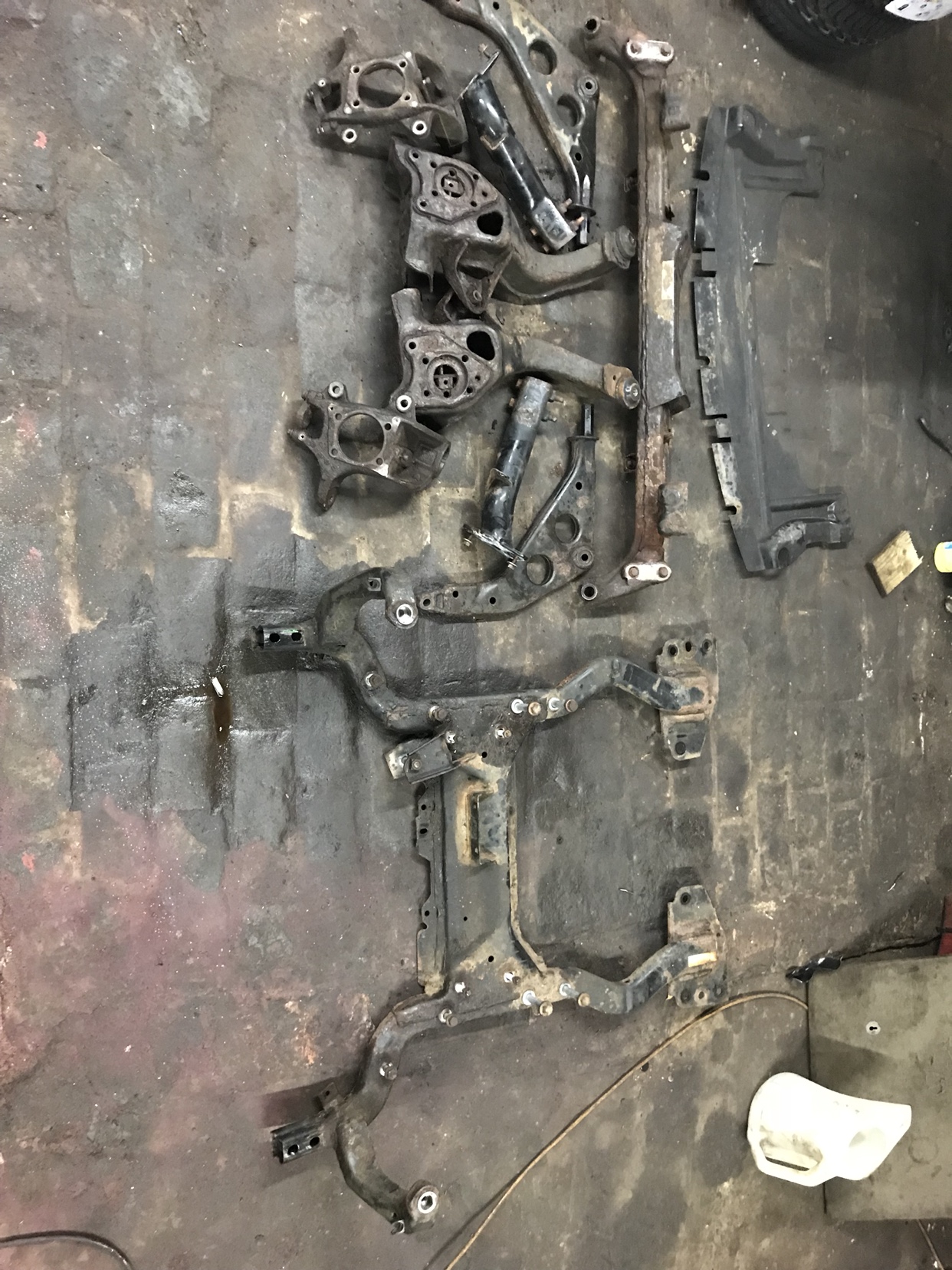

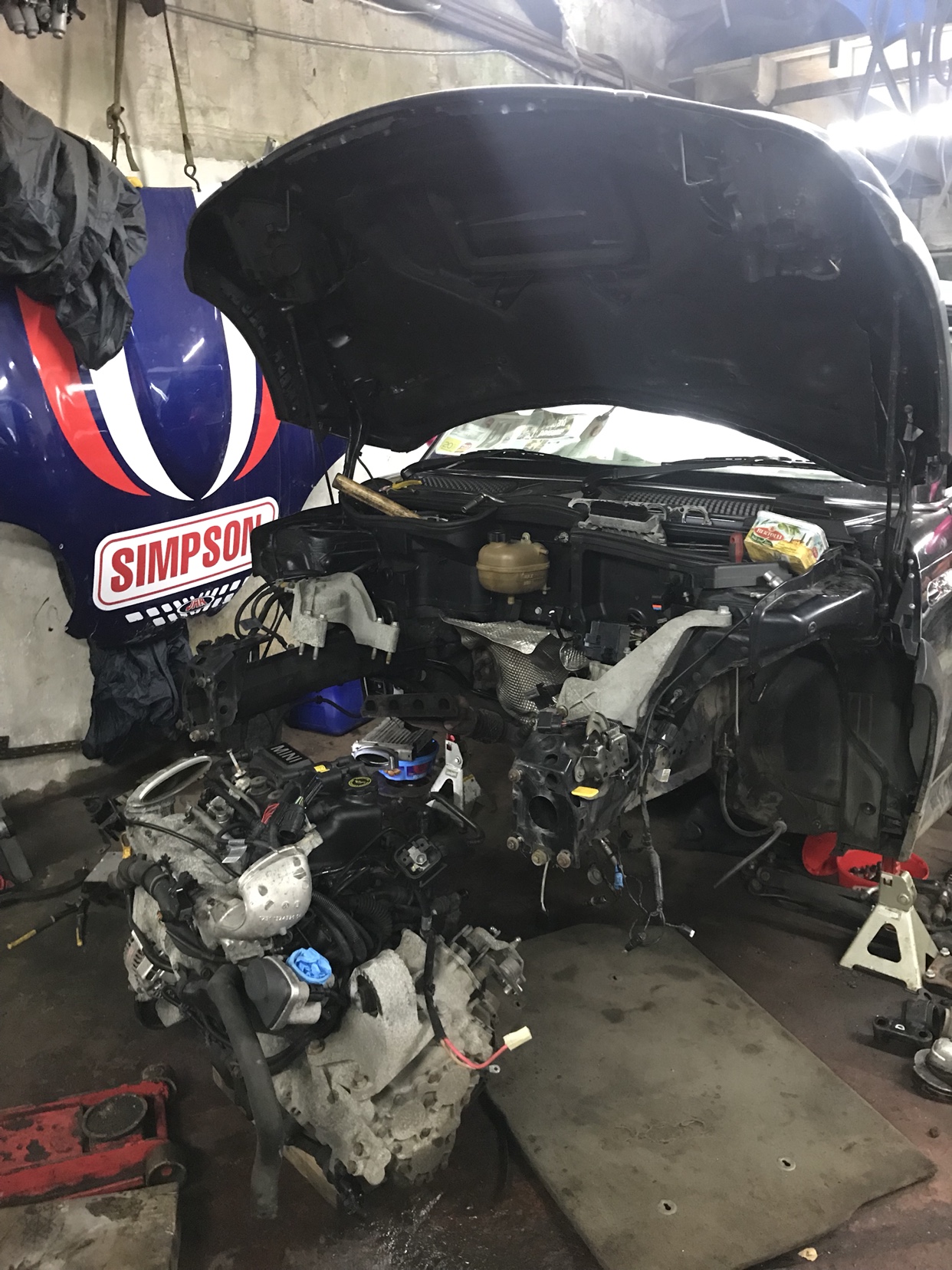

Exhaust, Rear subframe and arms removed, full stripped down and ready to be blasted/painted
I’ll be painting the underside of the car before fitting with all new parts!

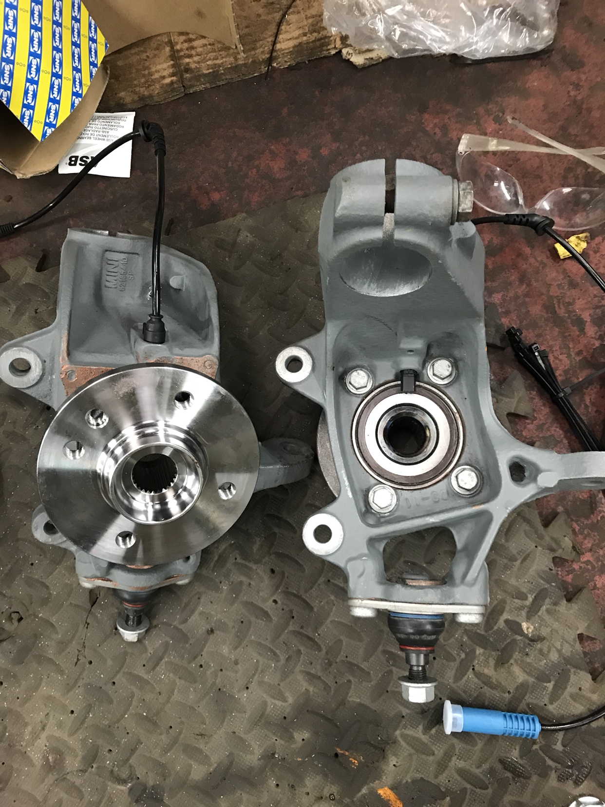

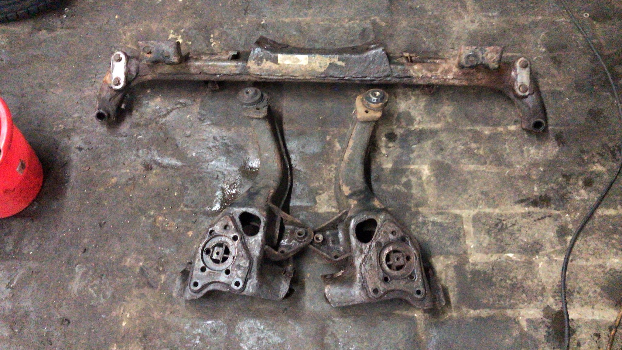

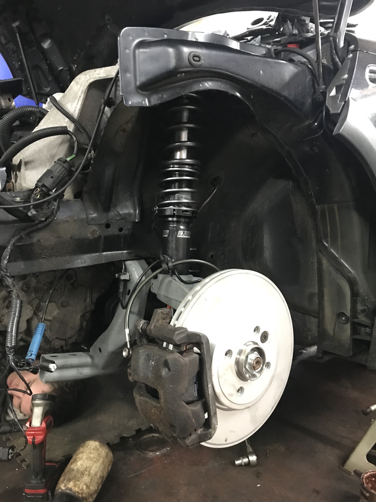

Work continues after the day job and that’s the front suspension, subframes, hubs, arms and even the from end of the car stripped off.
These items will be going away to be painted and receive a lick of paint before being fitted with all new bushes, ball joints, bearings etc etc.

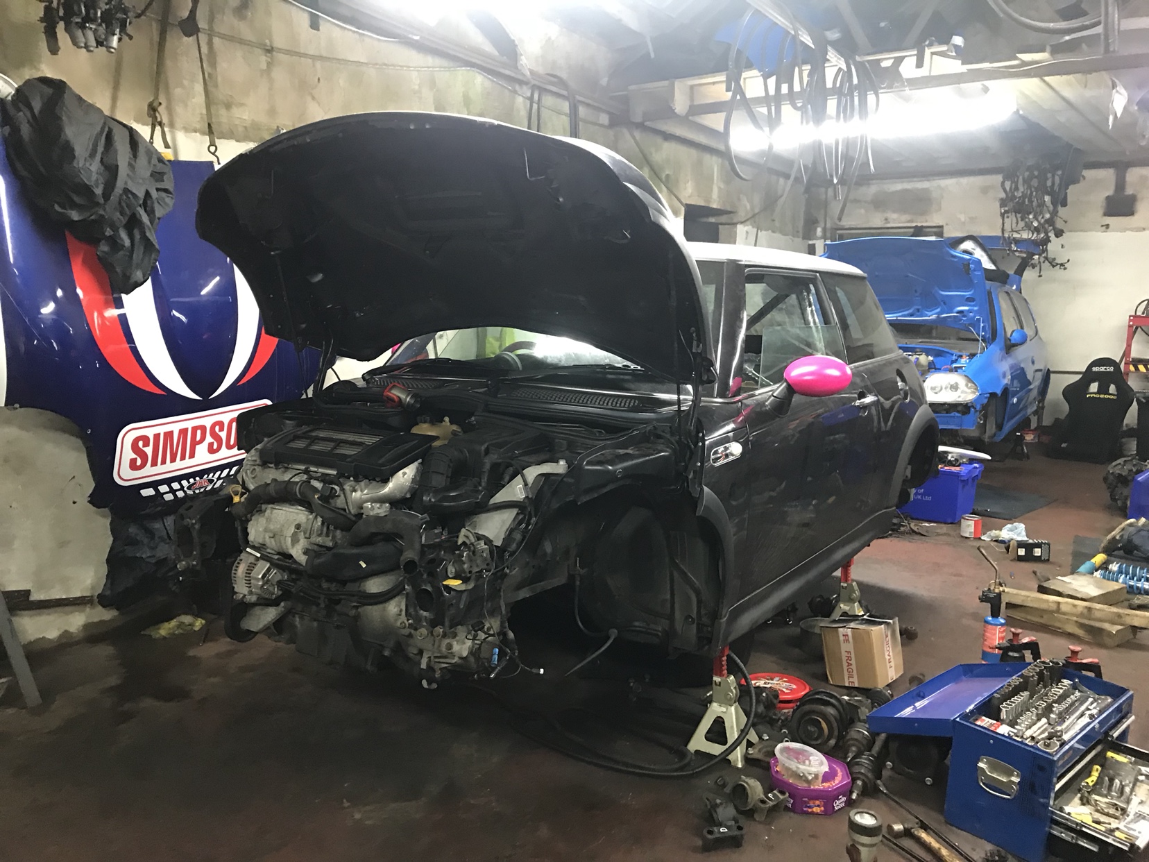

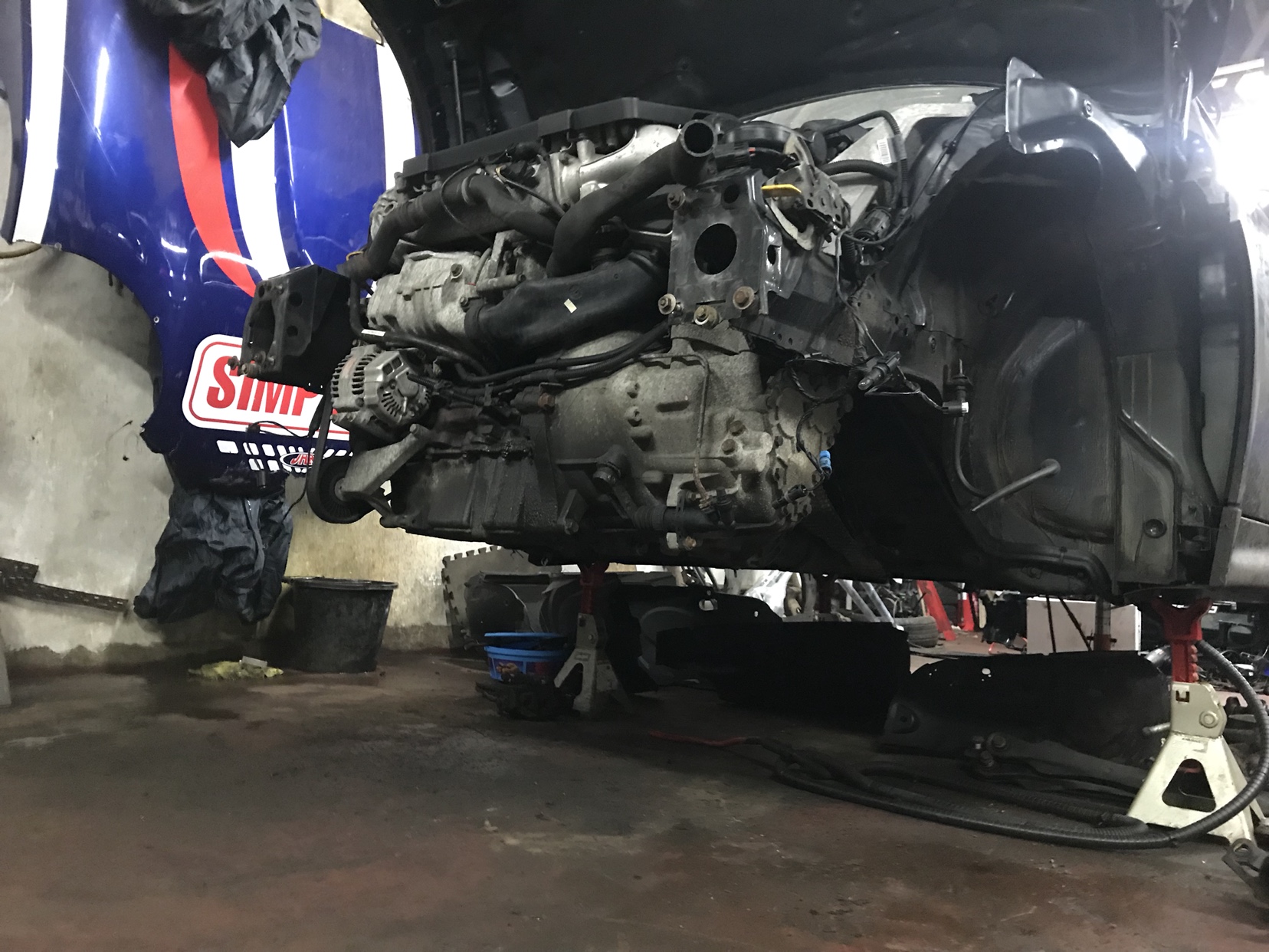

I’m heading down to autosport show, so no more work until the weekend - next up is getting the interior painted then pull out the engine!

Inside painted

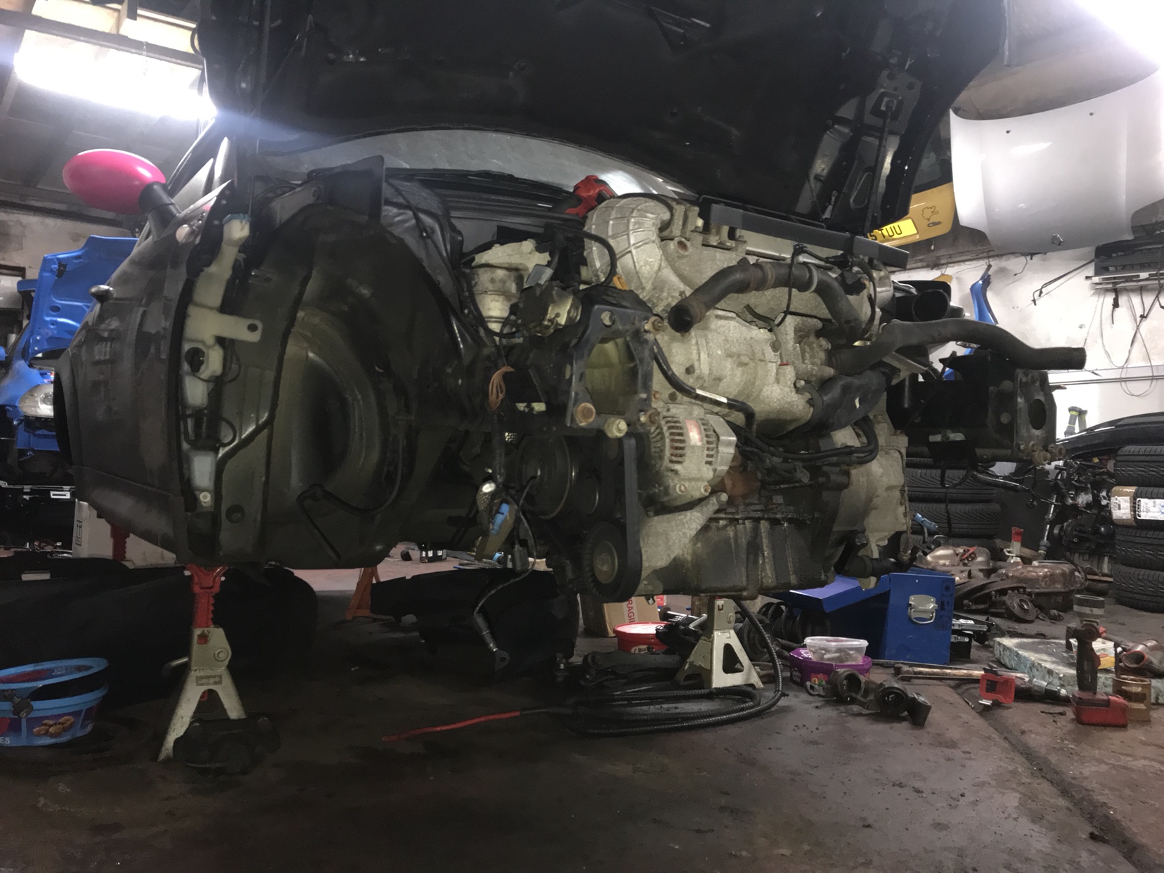

Engine out

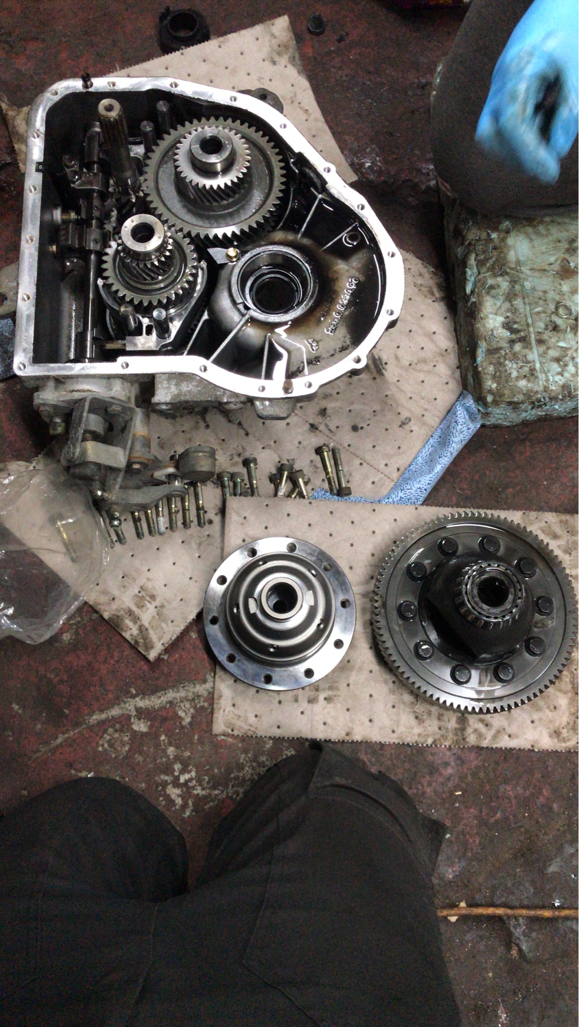

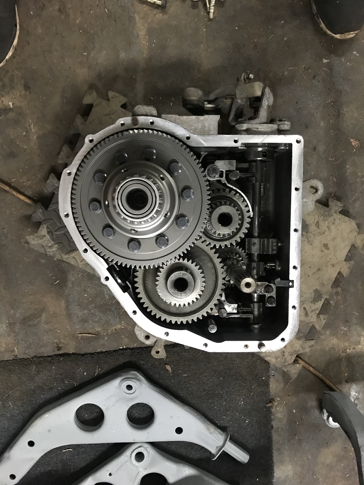

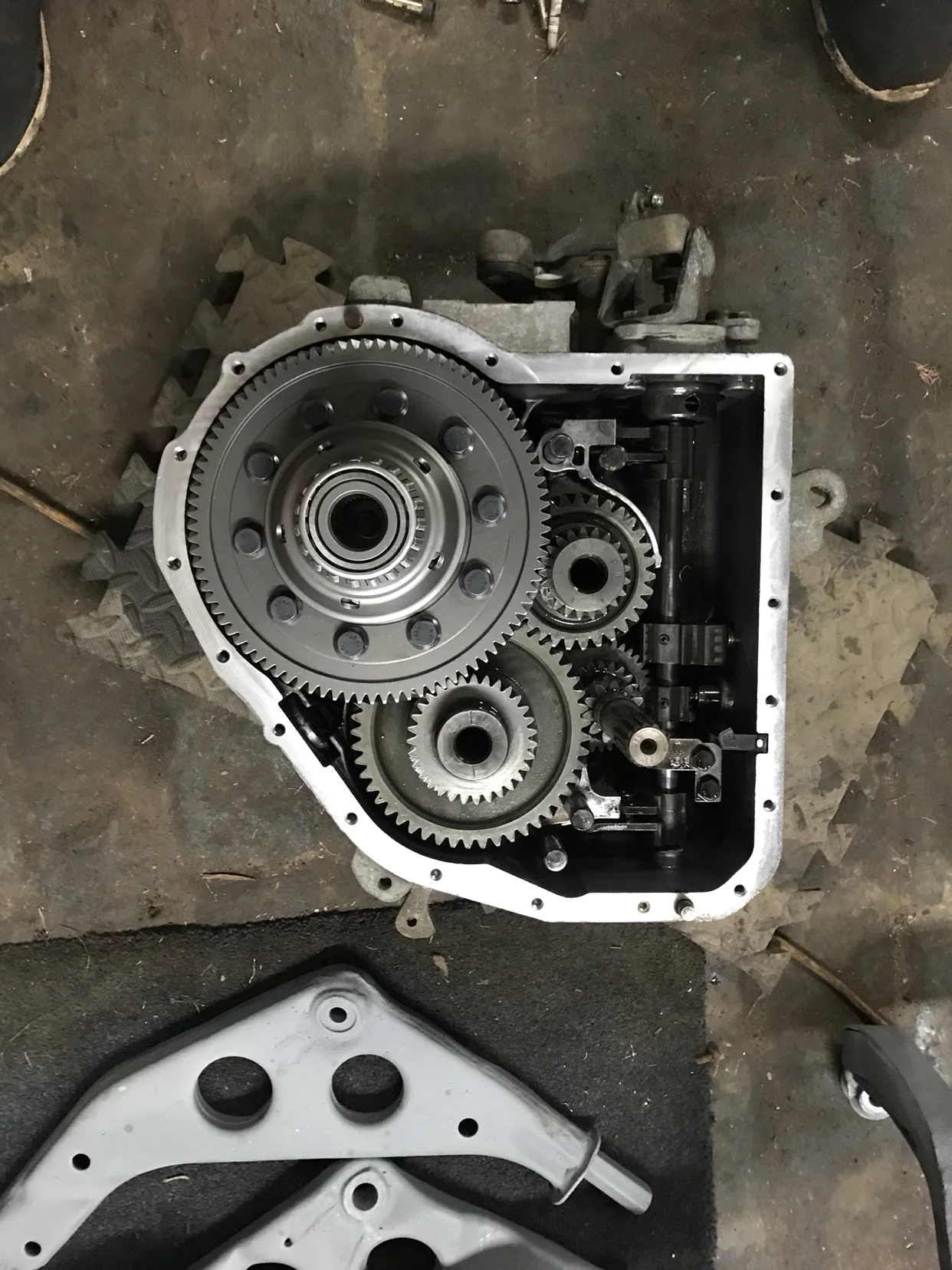

M Dactory diff fitted

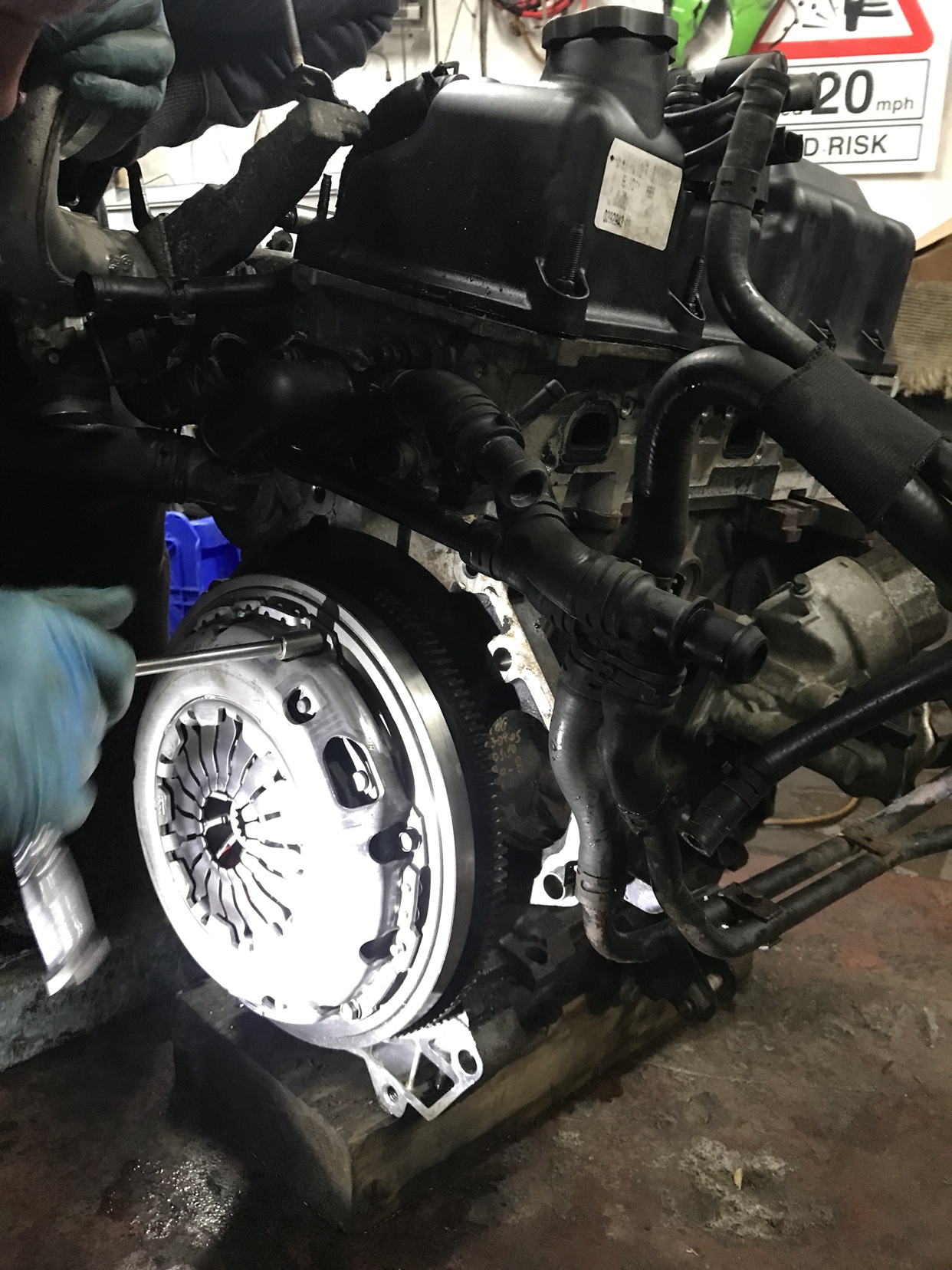

New clutch and flywheel (single mass)

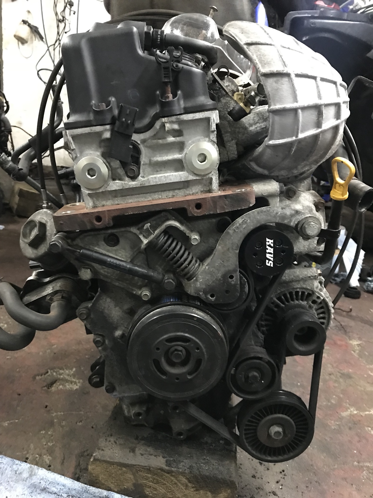

11% Kavs reducer pulley

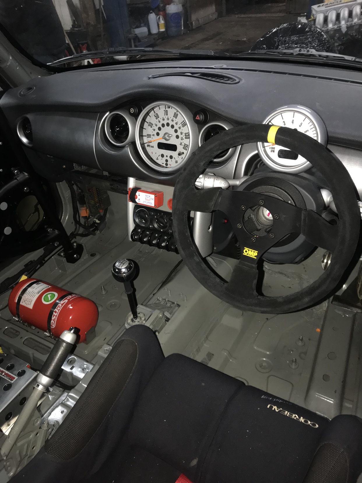

Seat, cage, cartek isolator, extinguisher fitted

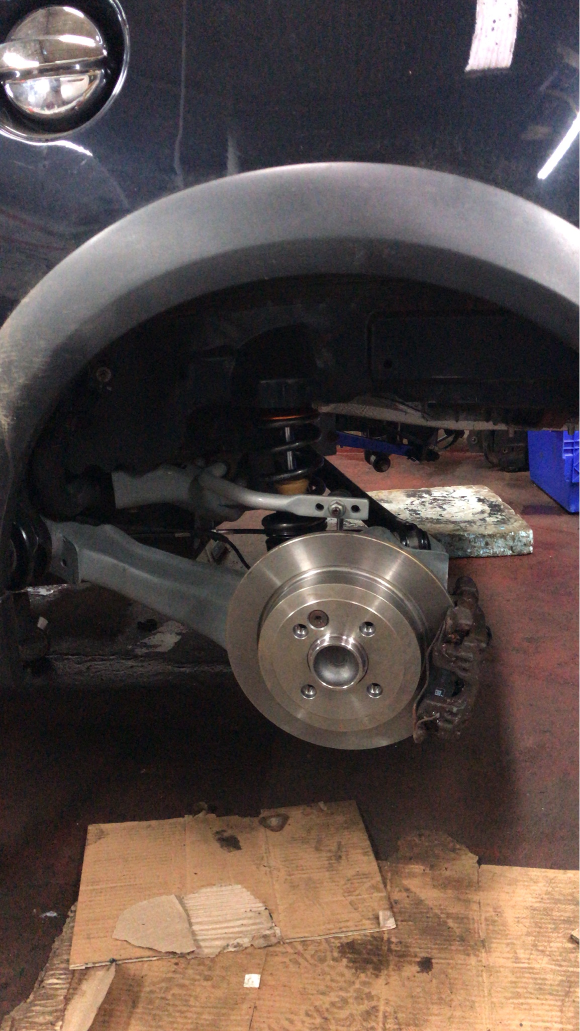

New bushes, ASTs, bearings, break, arms all fitted

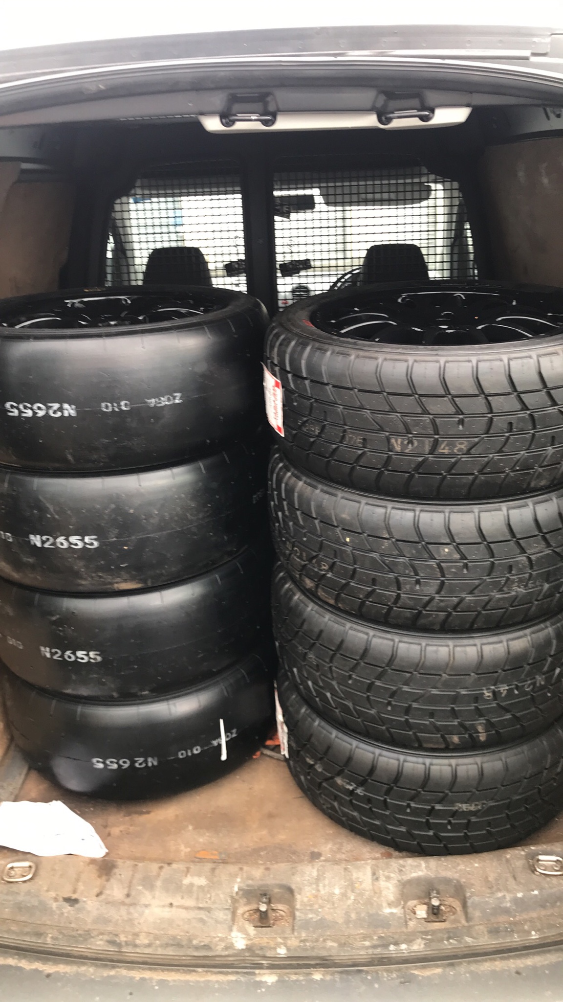

New wheels and tyres

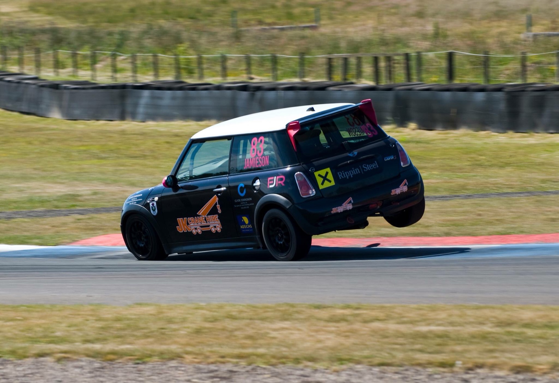

First outing
Stickered up
I’ve kept it brief so I didn’t go too mental with a million pictures!
Love this wee car compared to the Clio. Handles much better but so heavy!!
