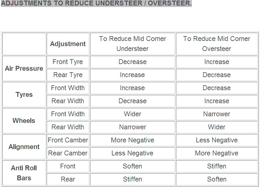

ADJUSTMENTS TO REDUCE UNDERSTEER / OVERSTEER.
AdjustmentTo Reduce Mid Corner UndersteerTo Reduce Mid Corner OversteerAir PressureFront TyreDecreaseIncreaseRear TyreIncreaseDecreaseTyresFront WidthIncreaseDecreaseRear WidthDecreaseIncreaseWheelsFront WidthWiderNarrowerRear WidthNarrowerWiderAlignmentFront CamberMore NegativeLess NegativeRear CamberLess NegativeMore NegativeAnti Roll BarsFrontSoftenStiffenRearStiffenSoften
I found this on demon-tweeks.co.uk will looking at tyres. Might be useful info to a most track day folks. Sticky maybe ?
Adjustment Table didn't transfer correctly. He're what that stuff should say :);
Without being too critical, and i suppose the car's setup has to start somewhere.
The table is very simply correct, by that i mean very simply. That could be where the problems arise in trying to achieve a set up change that doesnt just confuse.
The tyre temperature across the treads can and does go miles out, without the setup being wrong. By wrong i mean being able to acheive the quickest lap after say5-10 laps at ten-tenths pace.
This is more true with front wheel drive than rear drive.
The inside shoulder will always be hotter because of the negative camber, whether the camber is negative 2 or 5 degrees.
What if the front alignment is too far out one way or the other, this will also heat the tyre one side more than the other.
And that is only the start of it!
