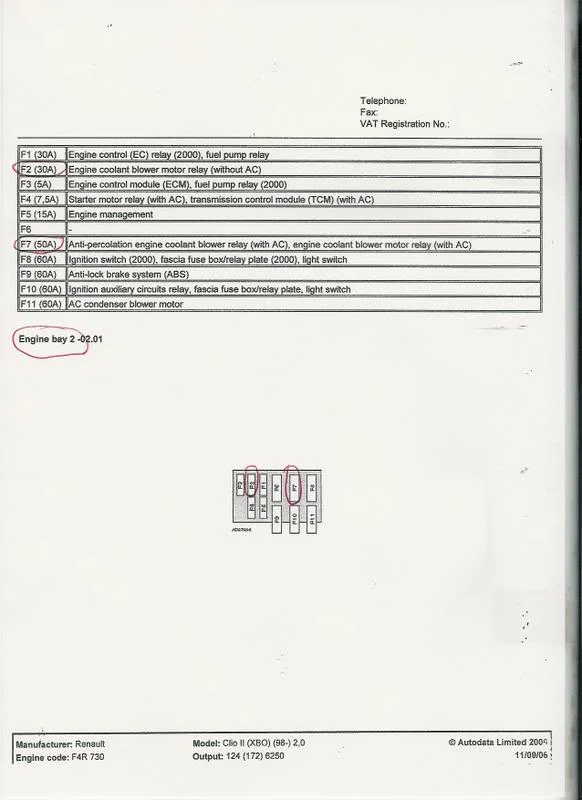

If they are on your PC you can cut and paste them from Word or whatever you use, or copy them to photo bucket and post them as images., like this.
