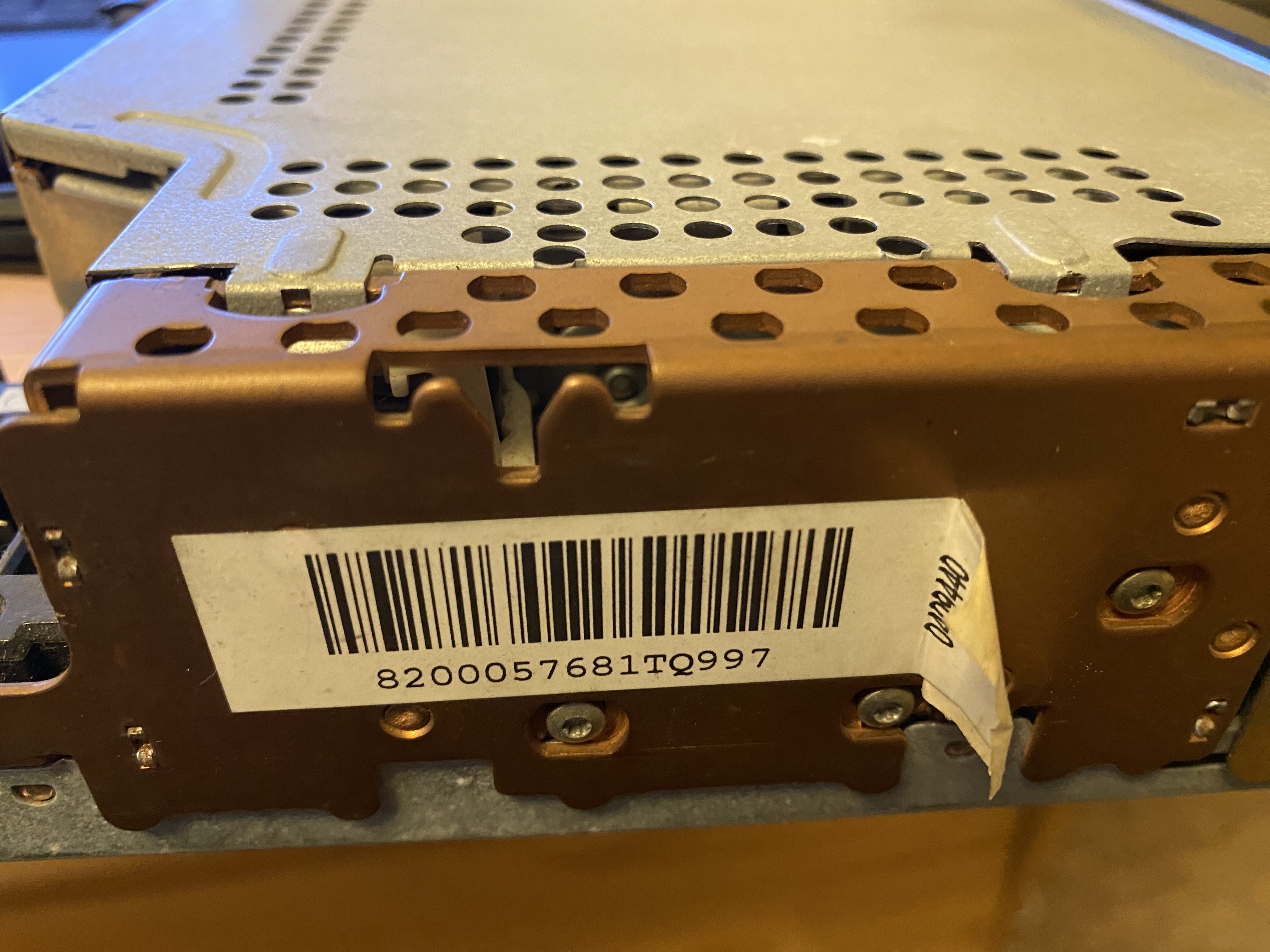

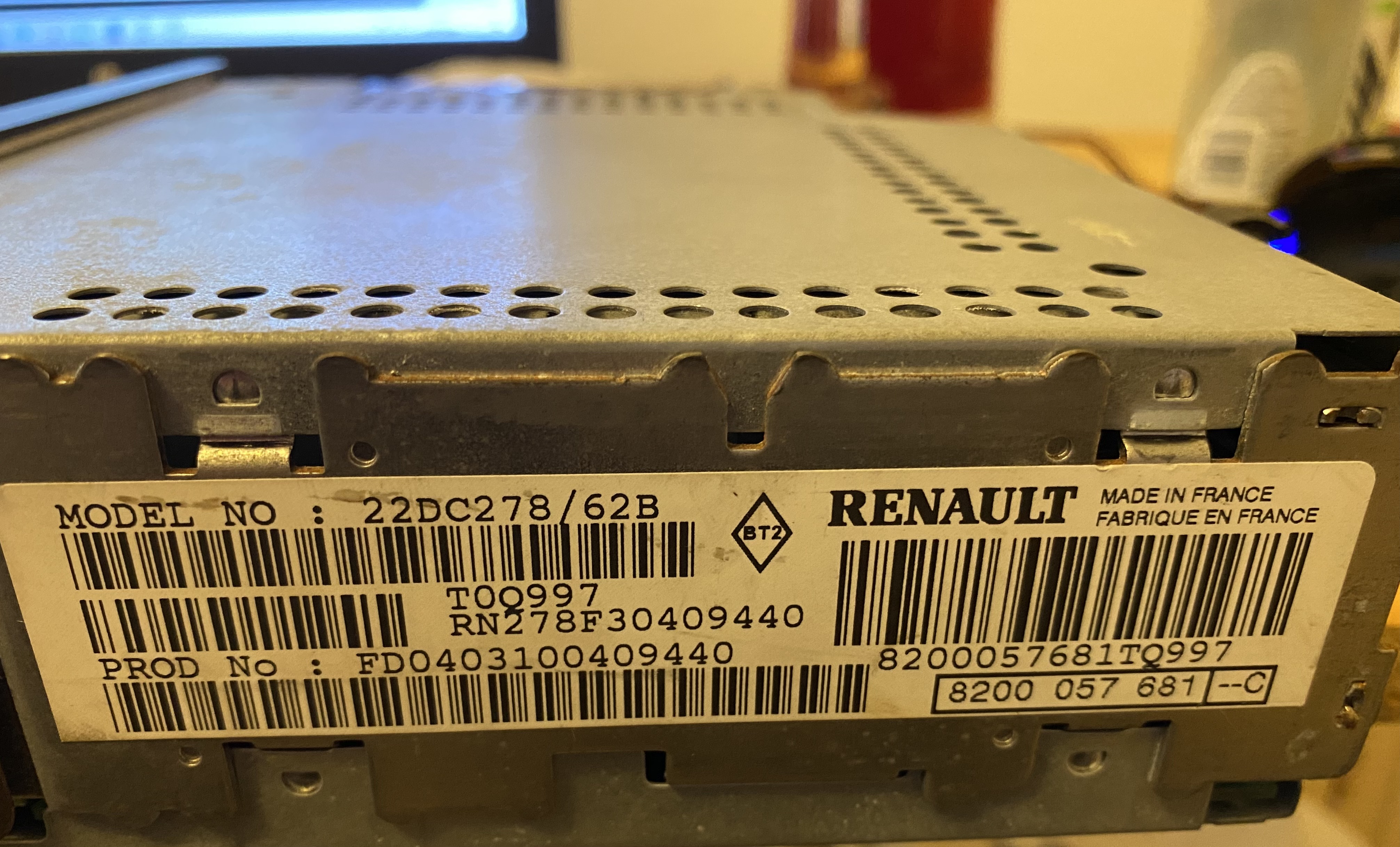

Hi guys,
I’ve been kindly gifted a radio from CS member and I just need the code. Does anyone know what it is for this radio?
And how do I input the code?
Thanks

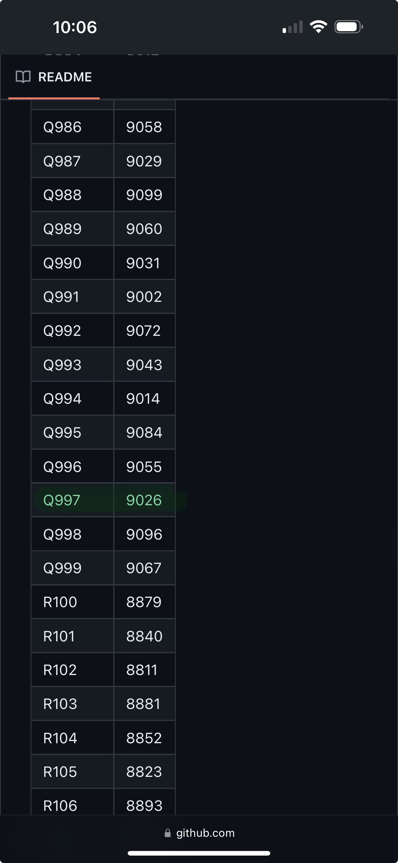

I'll try it tomorrow, thanks.

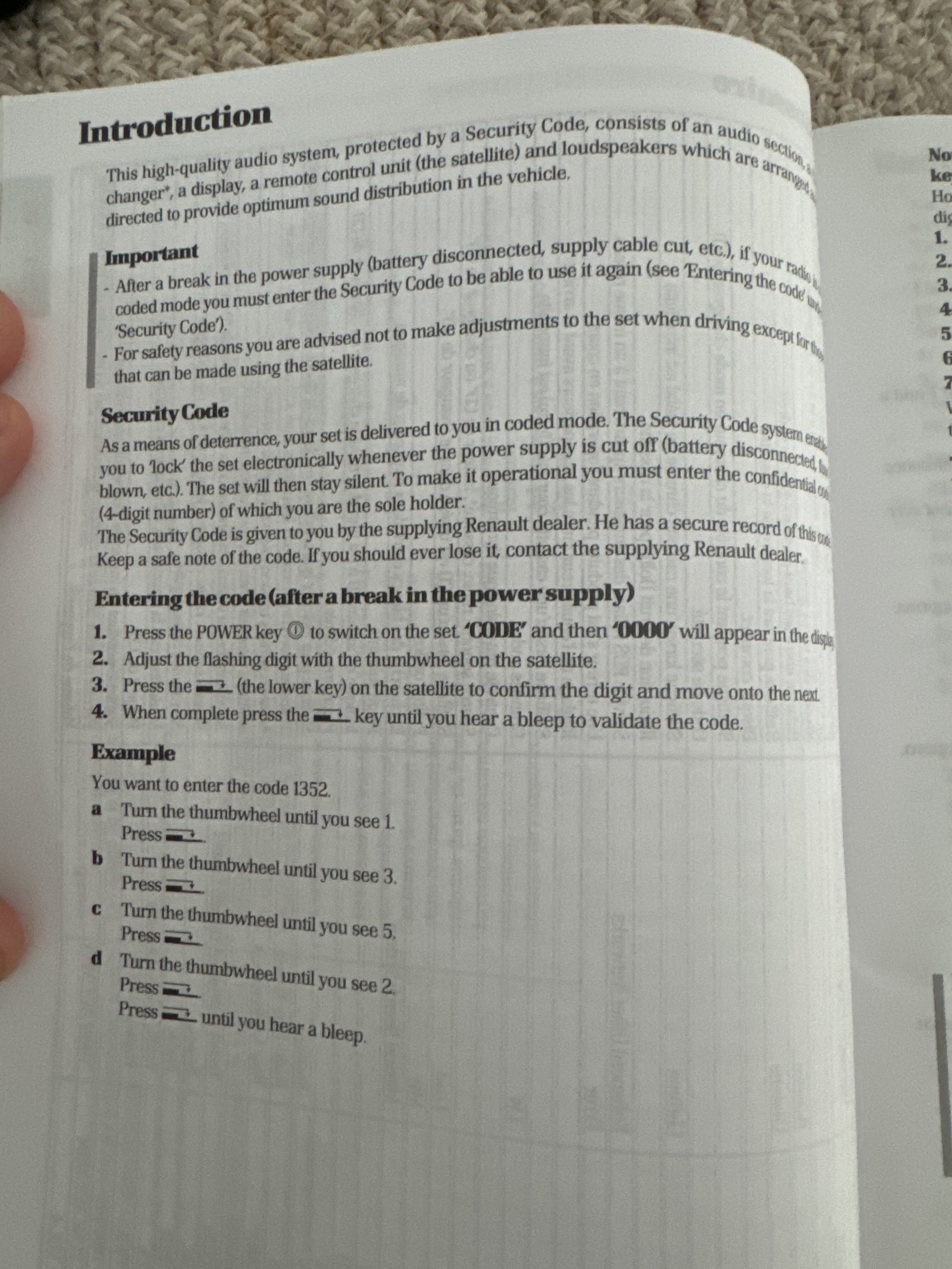

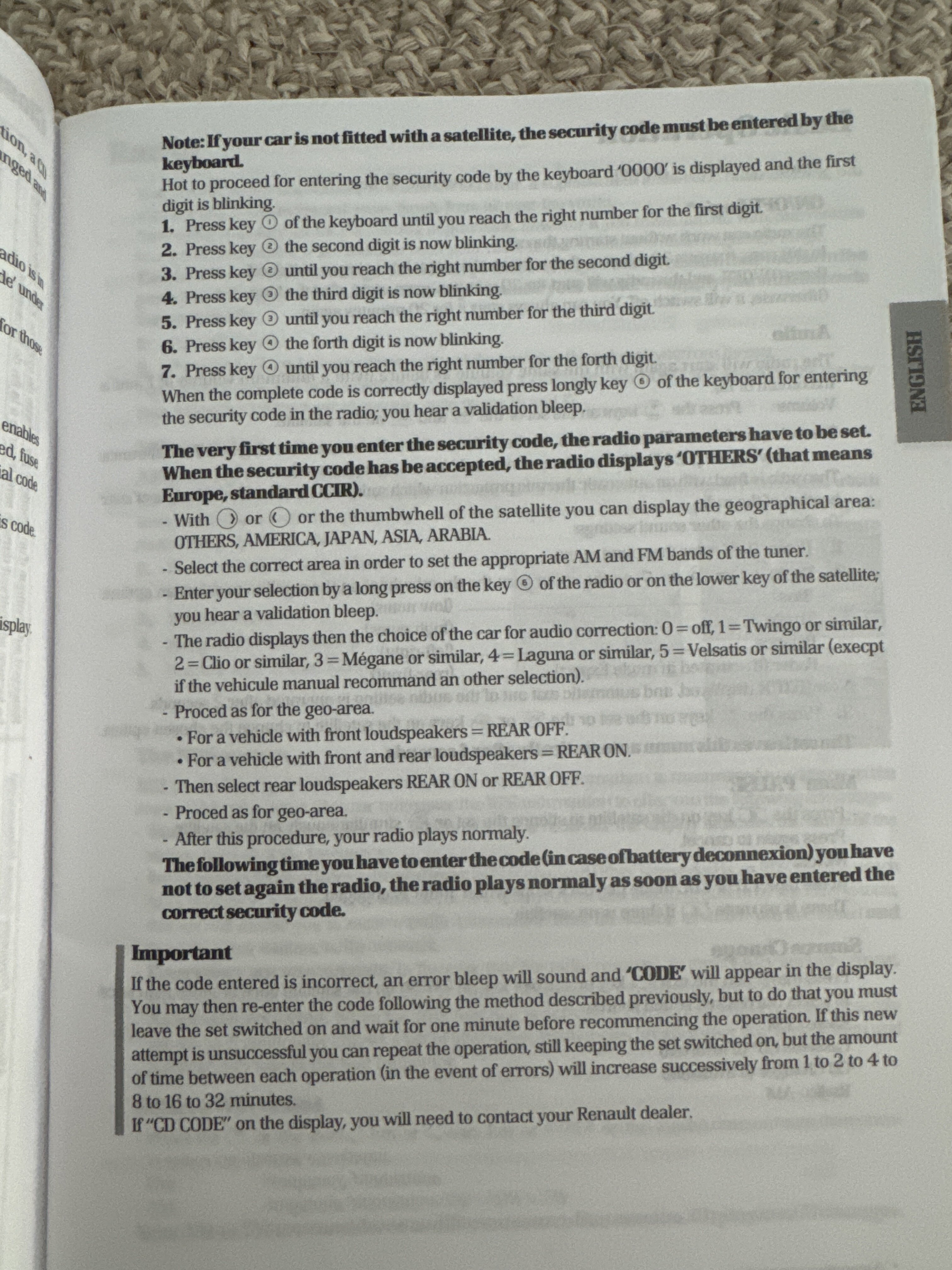

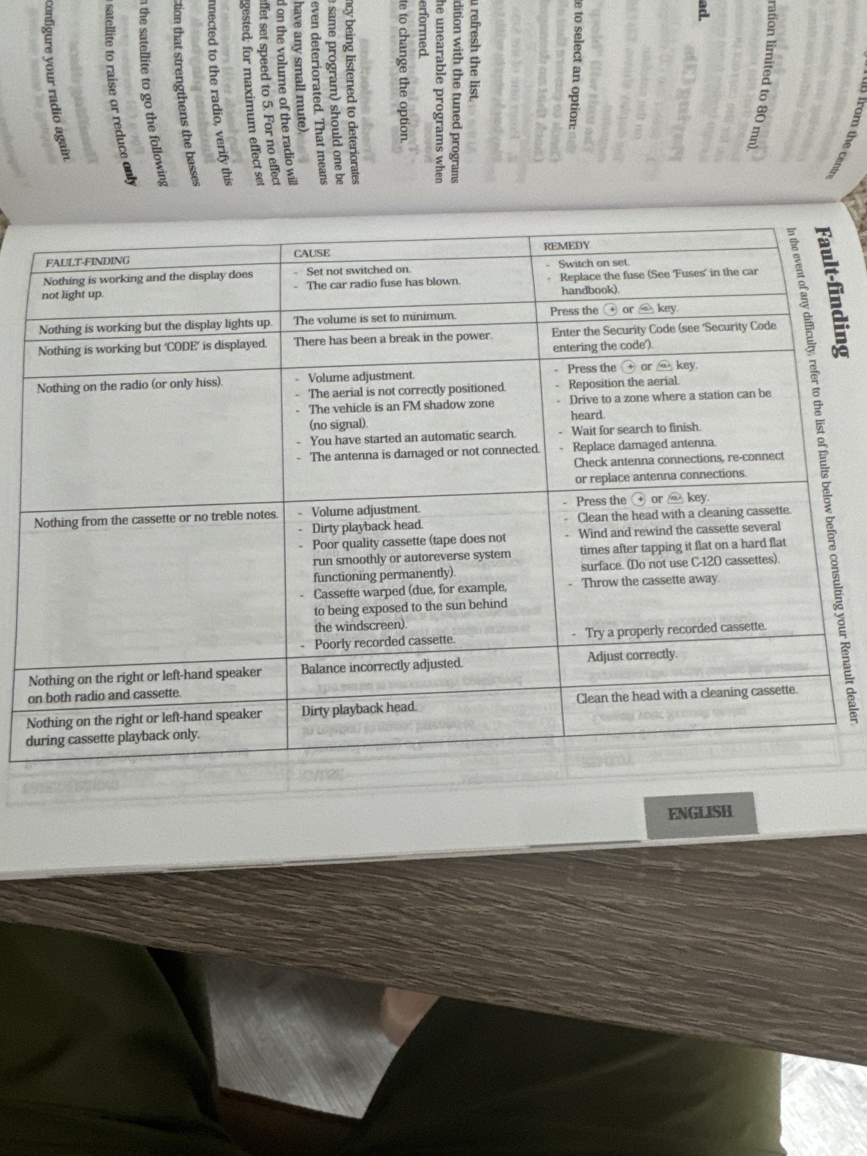

How do I input the code? When I plugged the radio in the display just read 'ERROR' and I wasn't able to get any numbers to come up no matter what I pressed ?
