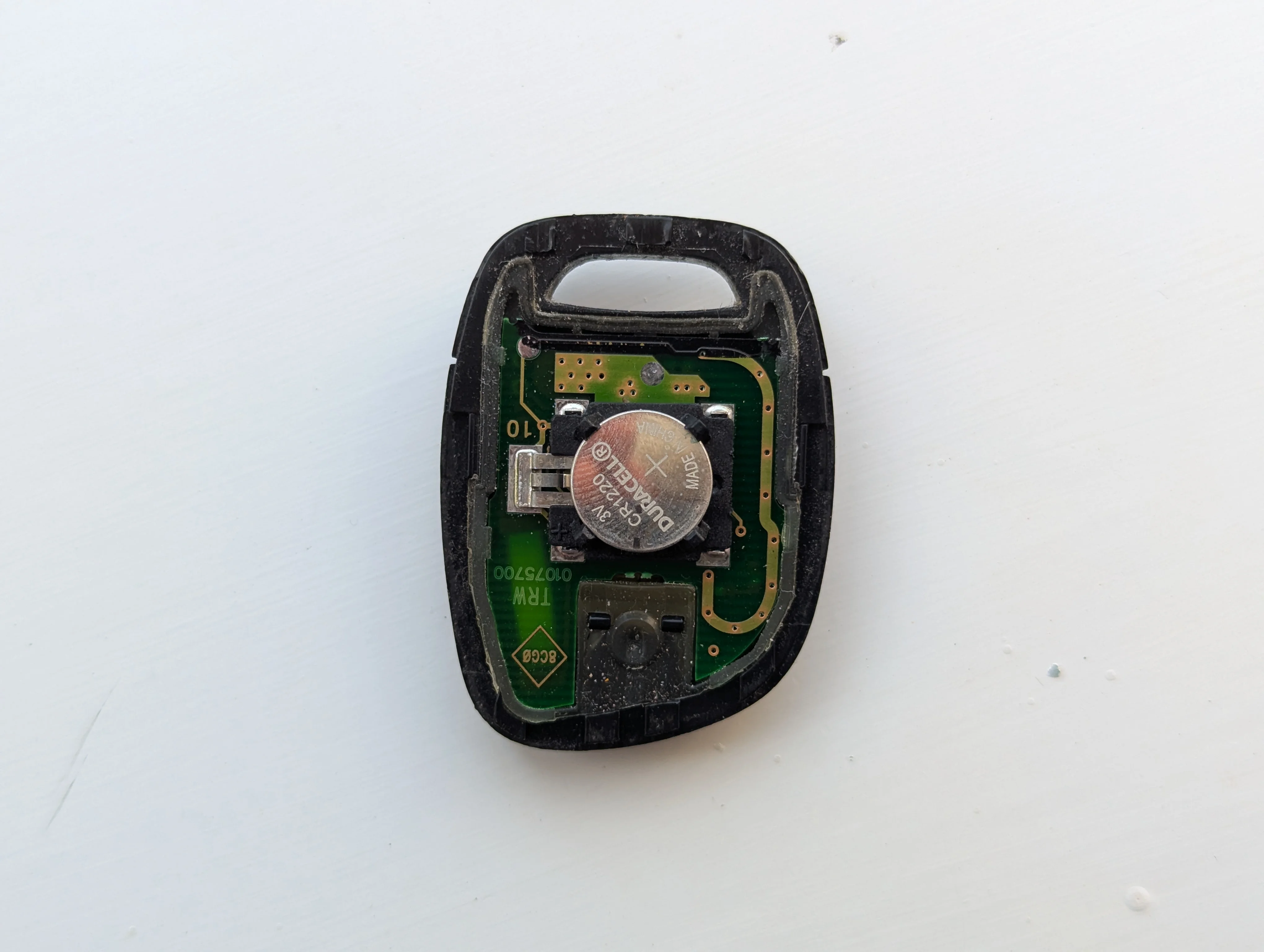

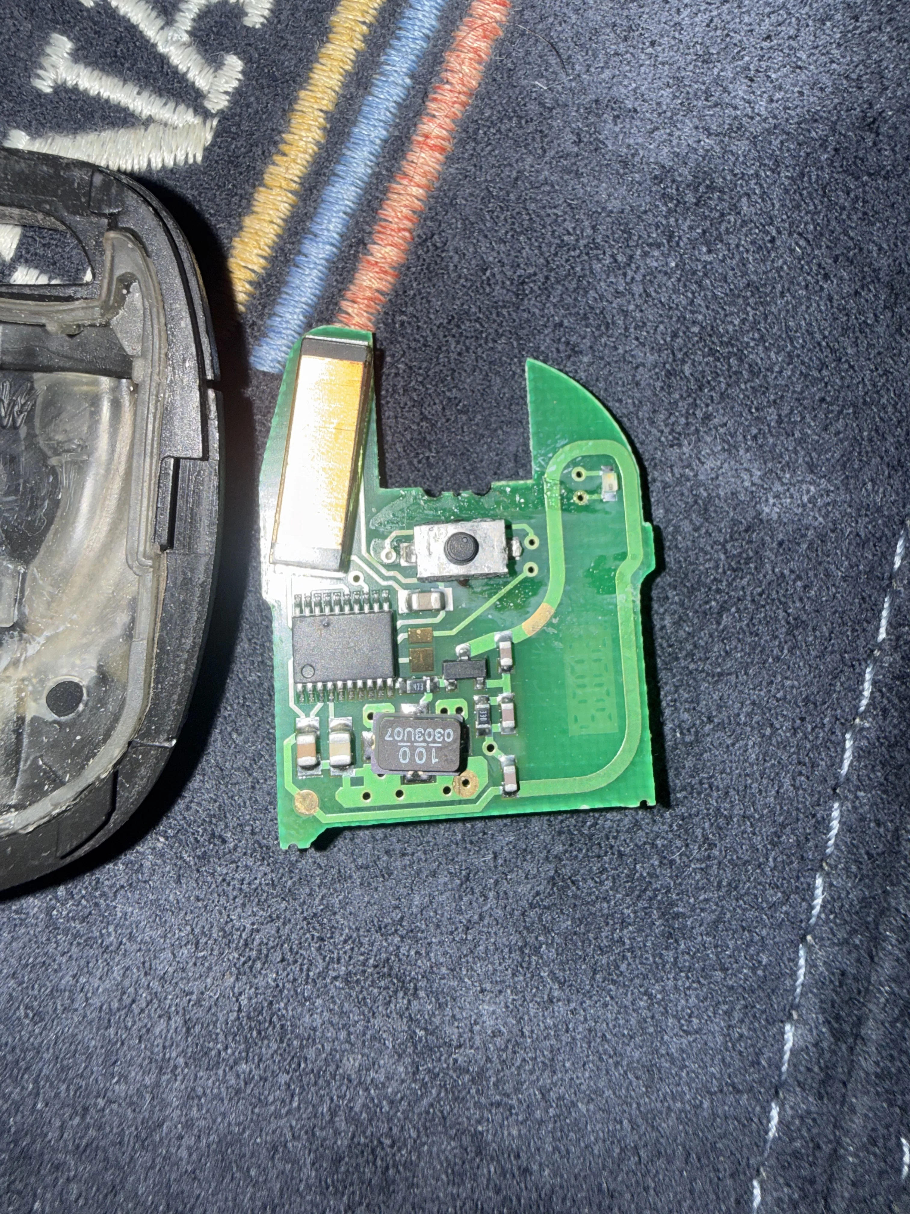

Stick a picture of the PCB up mate
That’s what the insides of the key look like. I’m guessing that’s what you’re after.
I’m definitely going to try what was left in the project forum for the car when I’ve got a minute.
It might be a non-OEM (or ph1 specific board then). Both batteries are 3v so if it worked before its probably right tbh. Be interested to find out what it is. if you have a multimeter you can at least check button continuity.
I haven’t got a multimeter to check it, another ph1, a normal one, on YouTube used 2016 batteries but it had two in. The internal of the key was completely different though so this could have a different board in it.

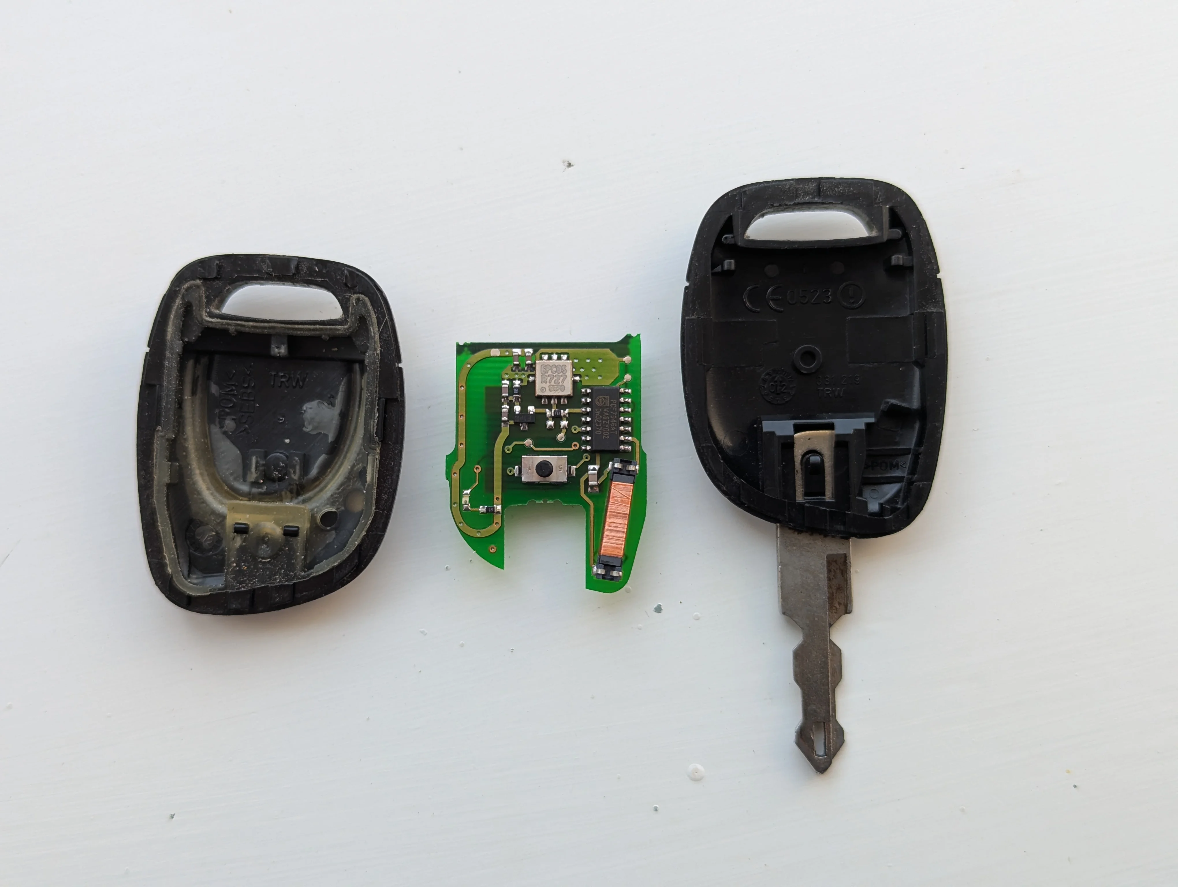

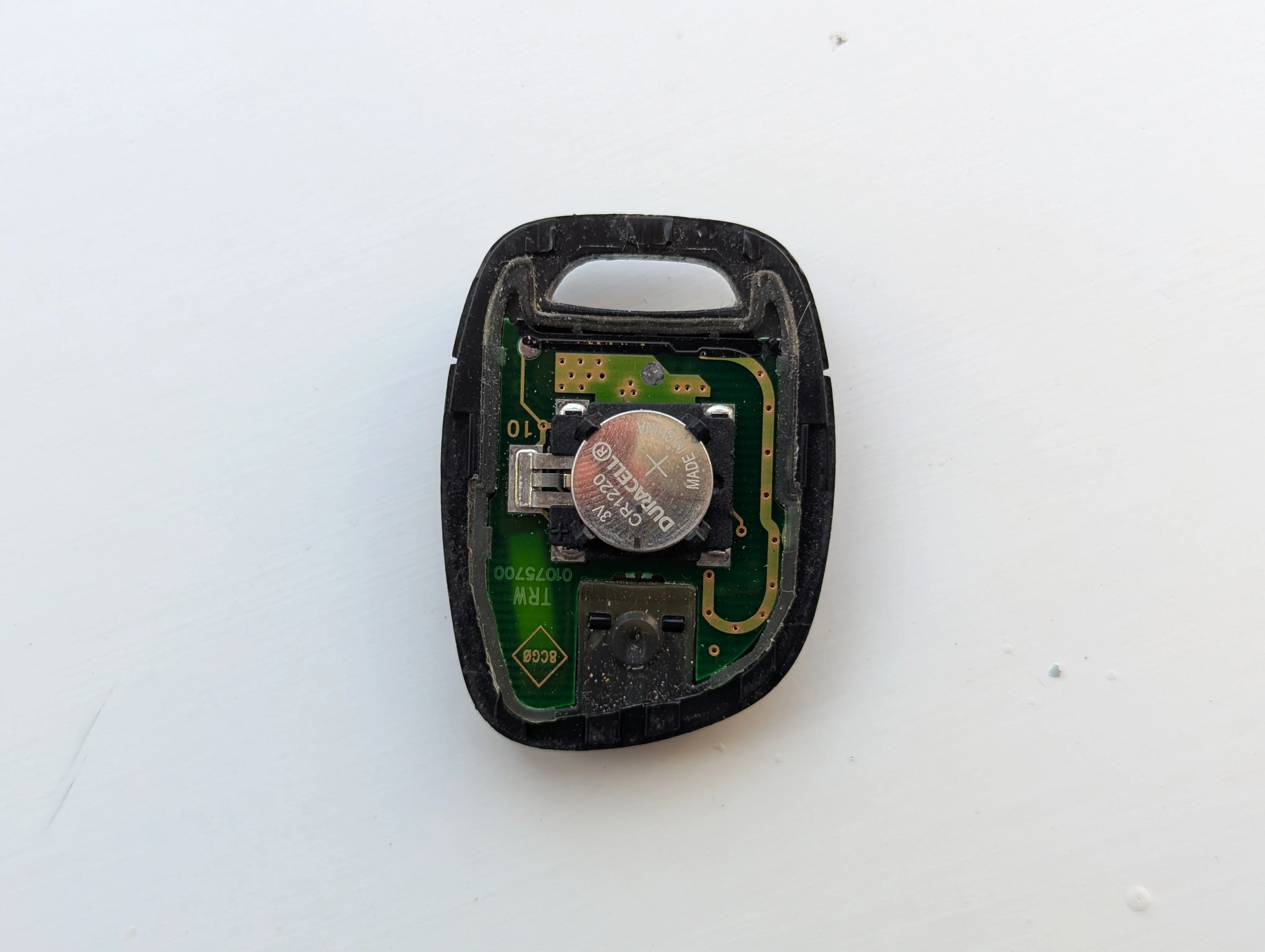

Baterry must be fine, I have never seen one. My ph2 keys have always looked like this:
I would suggest jumping the switch but you have to close the case to complete the battery circuit 🙈
My money is on this. Was quite a common issue wasn't it?
I think it's quite common as far as broken fobs go
Just reflow the board, use a heat gun or hairdryer
This is a good shout, even if it's just some fresh solder on the micro switch and go from there

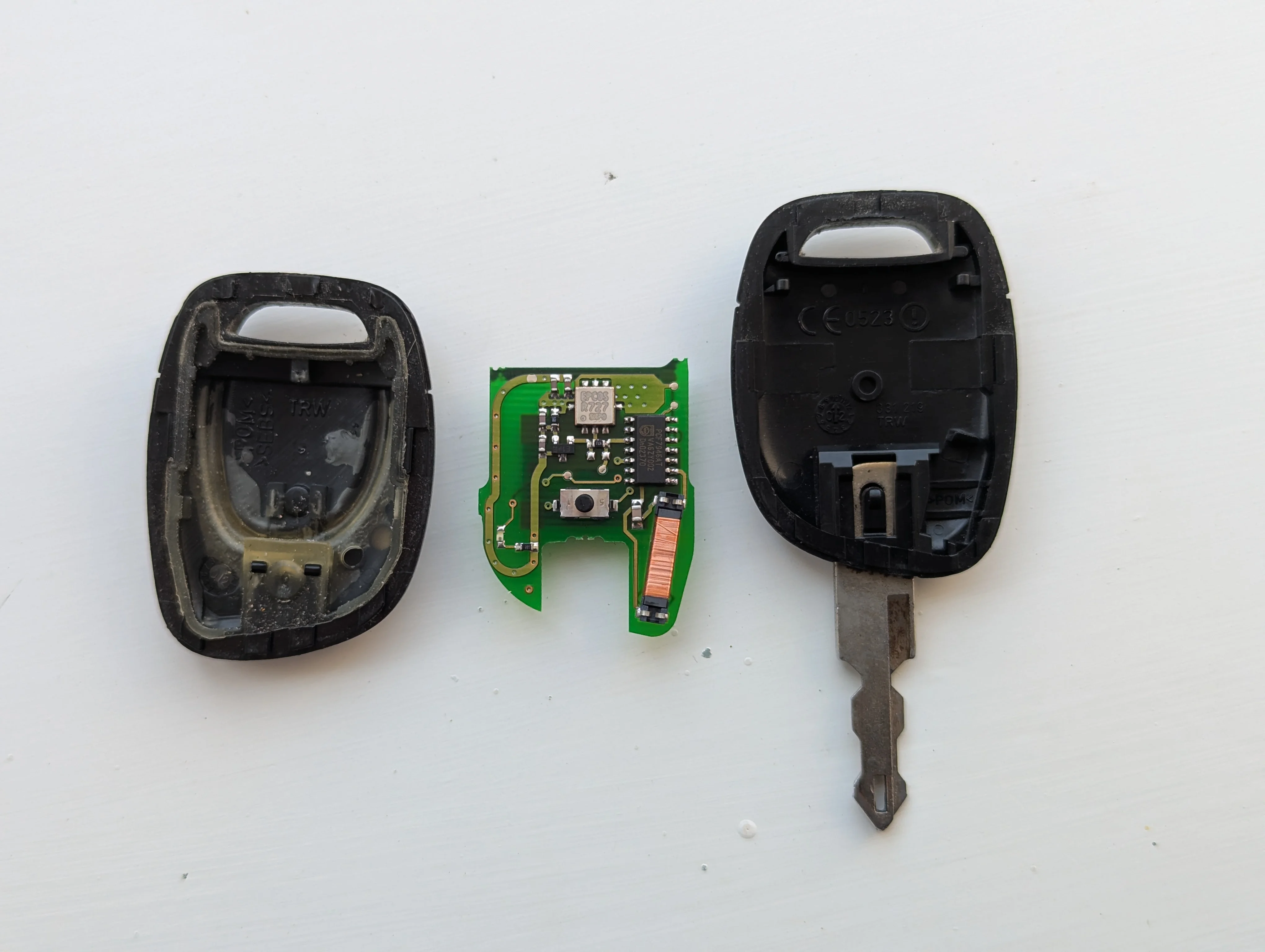

View attachment 1795380View attachment 1795381
Mine looks completely different inside, the battery isn’t attached to the circuit board like that. It’s sat inside the plastic on the key.
I’ll have a look into the microswitch and reflowing the board.

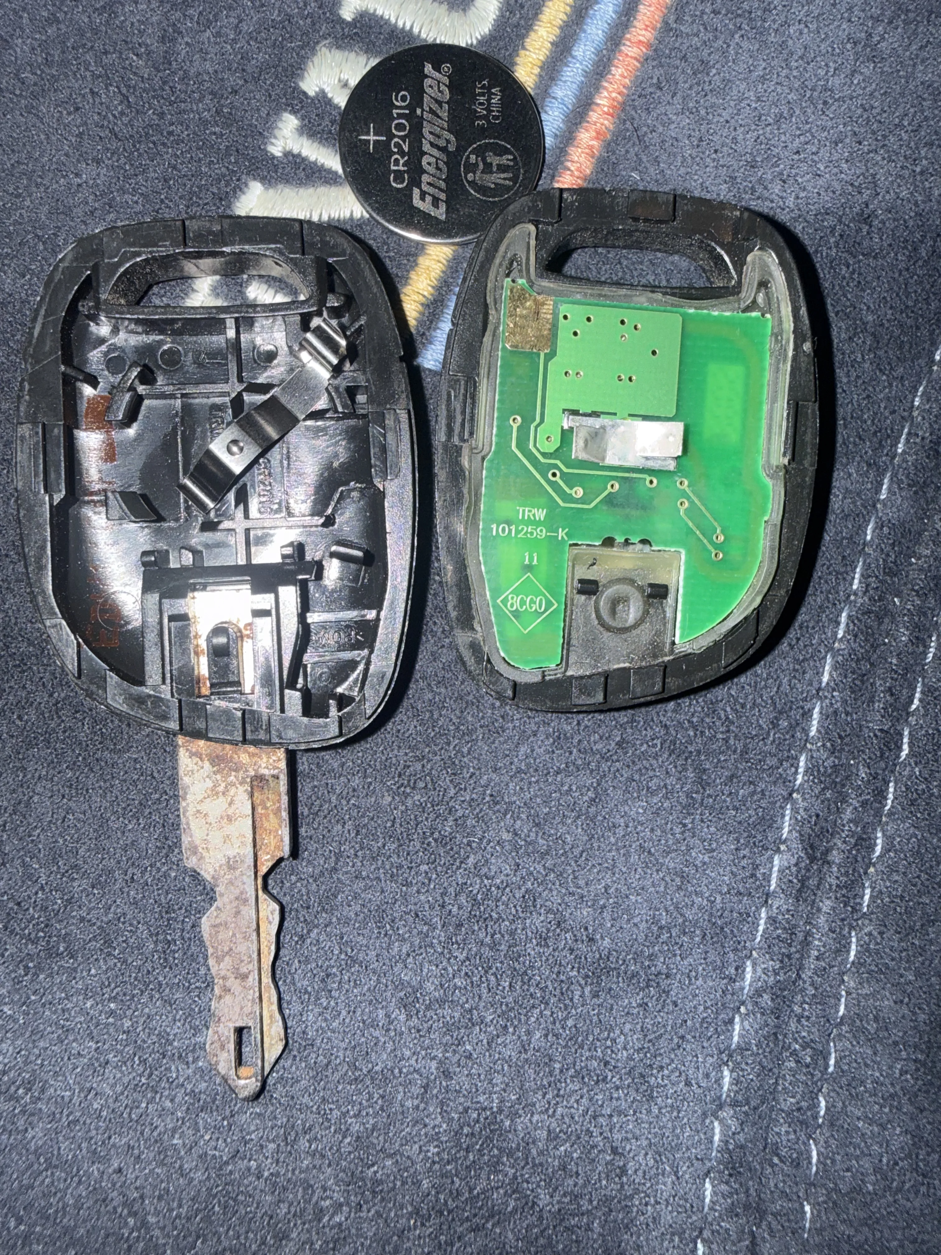

I was having another look at the key and the switch inside looks like its lifted off the PCB a little bit. Apparently Renault didn't put much solder on that bit so Im going to try putting some more solder on that.
I'd put money on that being the issue mate
The key still isn’t fixed and I don’t think the microswitch seems to be the issue.
The key guys looked at it and tried to fix the switch but nothings worked. He’s now going to see if he has a donor key to swap over the switch. Is it worth just getting another key at this point?
