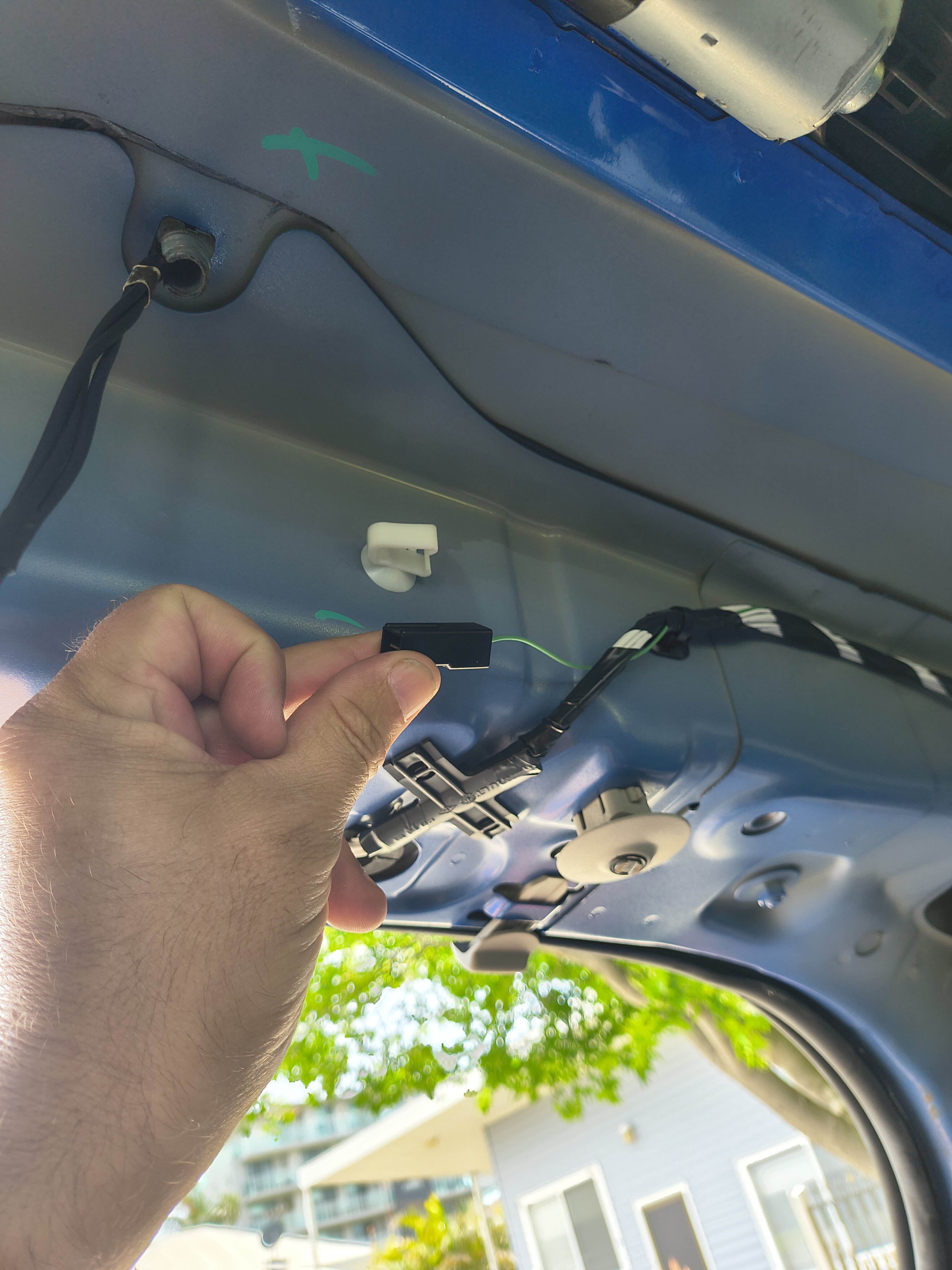

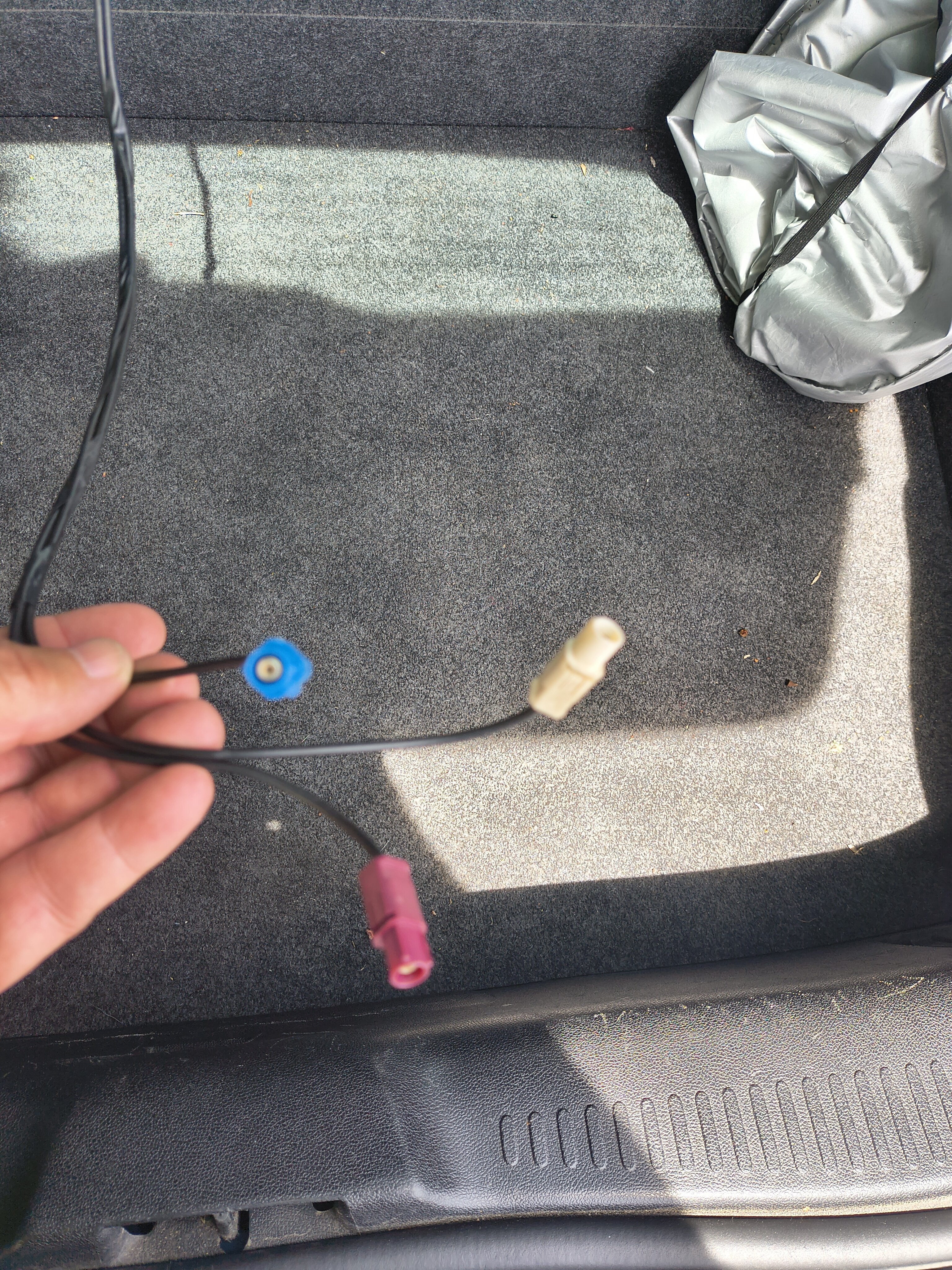

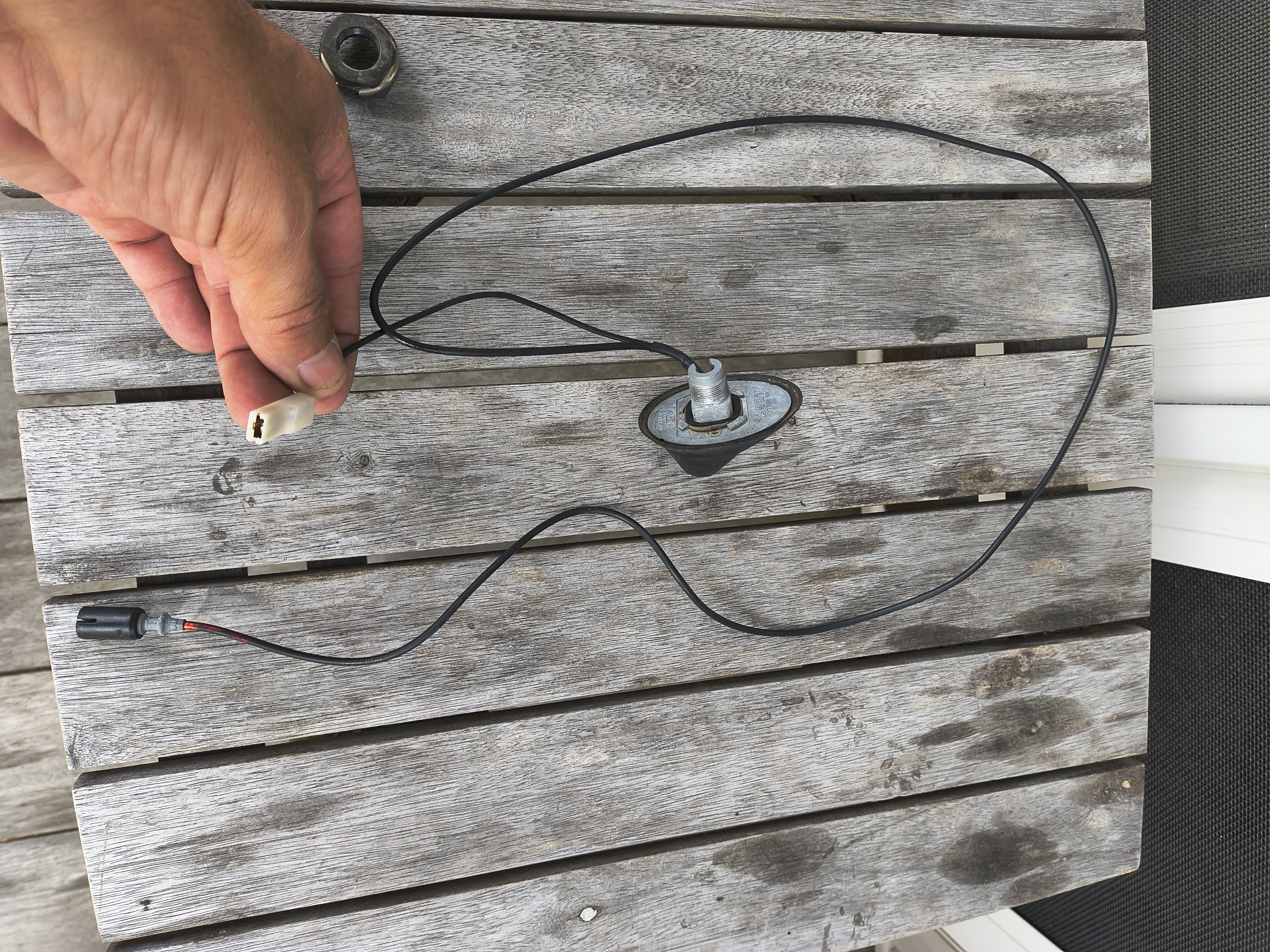

Does anyone have a copy of the Mk3 wiring diagram? I had to pull apart the car to fix a sunroof issue so while I have the roof lining off I got it redone and I want to replace the Clio aerial with a Meg 3 one with GPS antenna. Mine doesn't have GPS but I will install an aftermarket one later. So I just expected the aerial to have a single wire for the radio but it has another one as well (lime green) that just goes into the loom so I am unsure what this is.
If nobody has a wiring diagram does anyone know what this is and if it needs to be connected.
The Meg one has Fakra connectors that are (I think) Blue - GPS, White - standard radio & Brown - DAB radio.

The green wire/black plug that fits into the white connector on the aerial is a 12V feed.
The head unit doesn't supply phantom power to the aerial, so it takes a separate feed. A replacement head unit probably will, but you'll also have to replace the length of cable from the dash back to the aerial which I assume you'd do if you were fitting a nav and needed a nav antenna anyway)
Yes thanks that’s what I thought but when I put a multimeter on it it doesn’t show 12V with accessories on either with the radio on or off.
