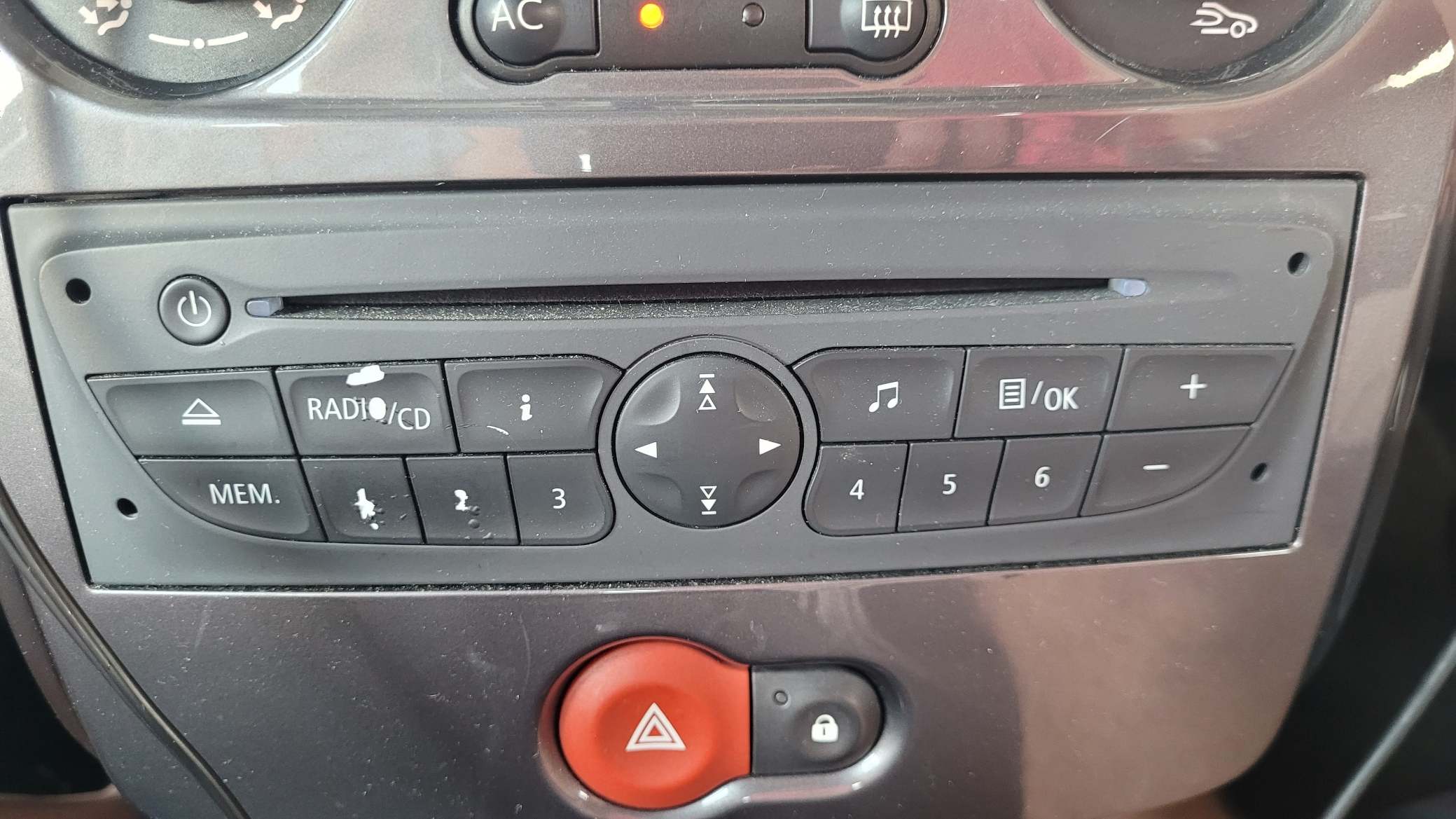

On the Clio 172's and 182's you could hold down 2 and 5 as you powered on the unit and it would access the master menu.
This does not work on the pictured unit below - Is there a trick to access the menu that allows you to change the region? Or how do you do a hard factory reset of the unit so I can set that up.
Car in question is a 2010 Clio 200
RESOLVED - You can use a good quality scan tool to access the radio under "special functions" and perform a reset and choose the region.
