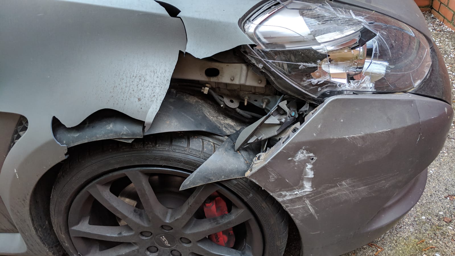

Plea for help.. Owner of Raider#8 for a year or 2 now. Loving it, except its just been driven in to…
Im aware of the total mare getting paintwork done/matched. Has anyone ever found a good company for Raider paintwork? Or any matt paintwork for that matter?

Full Respray is usually the only option they struggle with the colour match more than the Matt finish, the paint code is more blue than the actual car colour
I’ve owned #3 for the last 6 years so know the pain I’ve have a front bumper blown over and it’s never quite right
I have a extra paint excess on my insurance if i need to claim, might be worth looking into if you you are going through insurance and have protected no claims
Rojer
A good body shop will have a gun (i think its a spectral analysis gun) which they can put on various panels of the car and it will analysis the paint. It will then base the formula they mix the paint to so it matches 100% Other body shops may do spray out cards and check the match.

Where are you based? We specialised in troublesome finishes and standard paint. Matte, satin, plastic paint / waterborne (see lotus matte black b21 code) and Tri coat and 4 stage pearls.
Matte paint is no harder to match than any other. It's harder to get right but the colour itself is the same as any other paint used on any other car. The matte effect comes from the clearcoat.
The raider posted above is just a poor bodyshop not going the extra mile to match a colour.
A spectrometer also won't work as it uses angles and gradients from spec and reflectivity to determine close colour matches. It may help but truly the only way to do it is start from the base colour and make your own. We ( Protek Bathgate) spend days designing our own colours for even the most mainstream cars.
