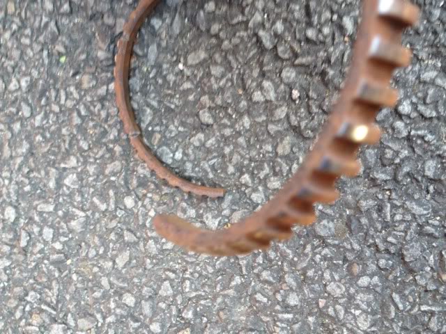

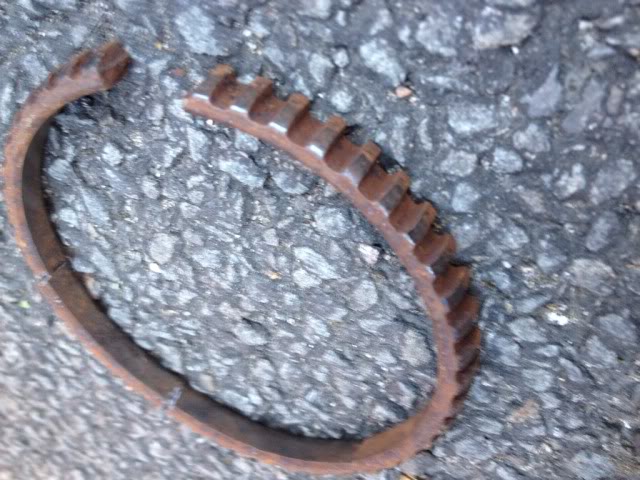

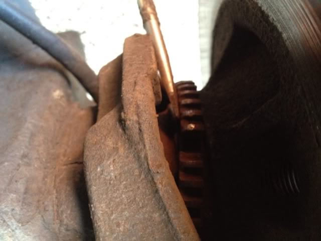

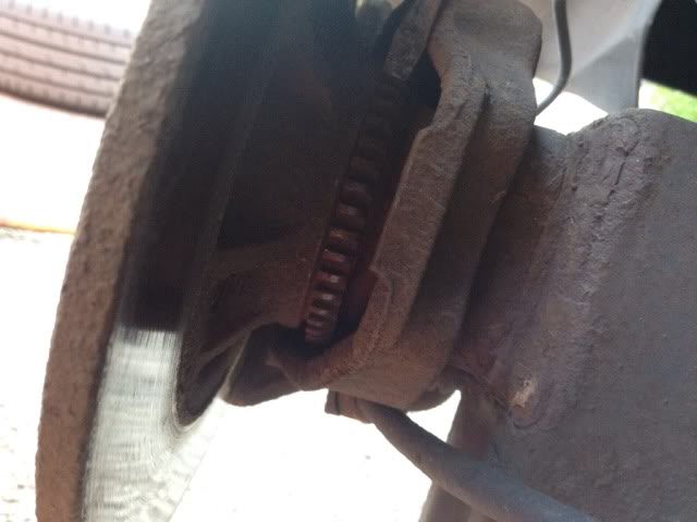

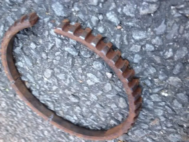

Oooo, whats this!
FOUND IT!
It was loose, need to now find out what it is?
As it was loose and broken, I took it off, problem solved!
