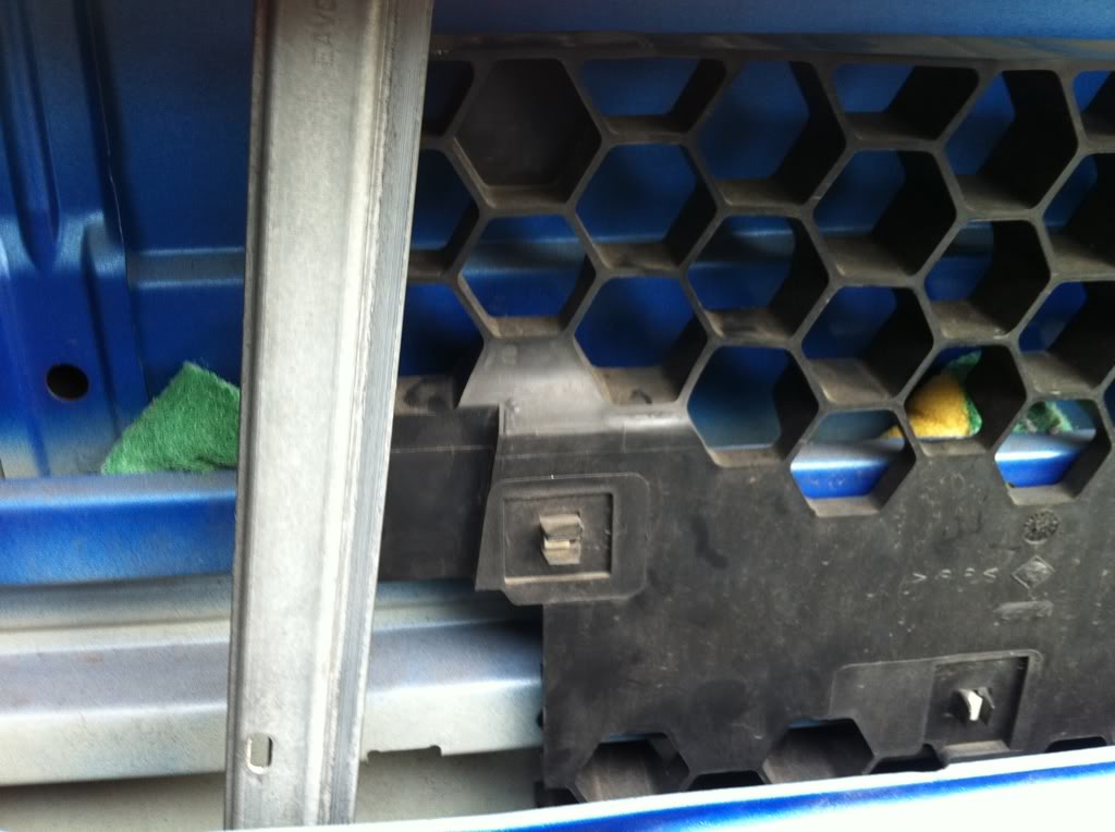

This is what I have just done and seems to have worked
Thats it, them impact bars rub on the door skin also. Basically foam anything that might rub. (love the scouring pad btw;))I even whipped that honeycomb bit off and siliconed all round the clips, and along that bar, stops it rubbing when it dries out
How do you get the honey combe bit off?!?!
Those clips wouldnt budge on mine!

I didnt remove mine and the noise stopped take the doorcard off and pull forwards and backwards and see if you can hear the noise then pull the impact bar towards you and the noise should stop.
Wedge something in there to force it towards you so it doesnt rub and done.
