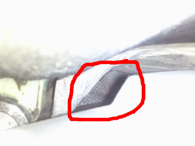

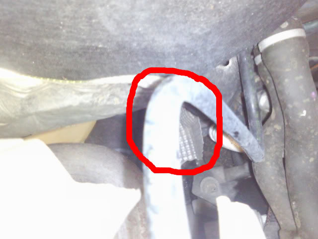

ok well ive been having a fiddle with the car , my dad appeared with a stick ( i wasnt to happy about this but hopefully we have sourced where the sound is coming from)
its definatly something knocking together , mainly when i switch the engine on and off . Now i think (not 100%) it the metal plate in the below pics ( sorry i have no idea what it is , im a woman after all ;) )
Sorry for the poor pictures, i still cant find my camera :(
