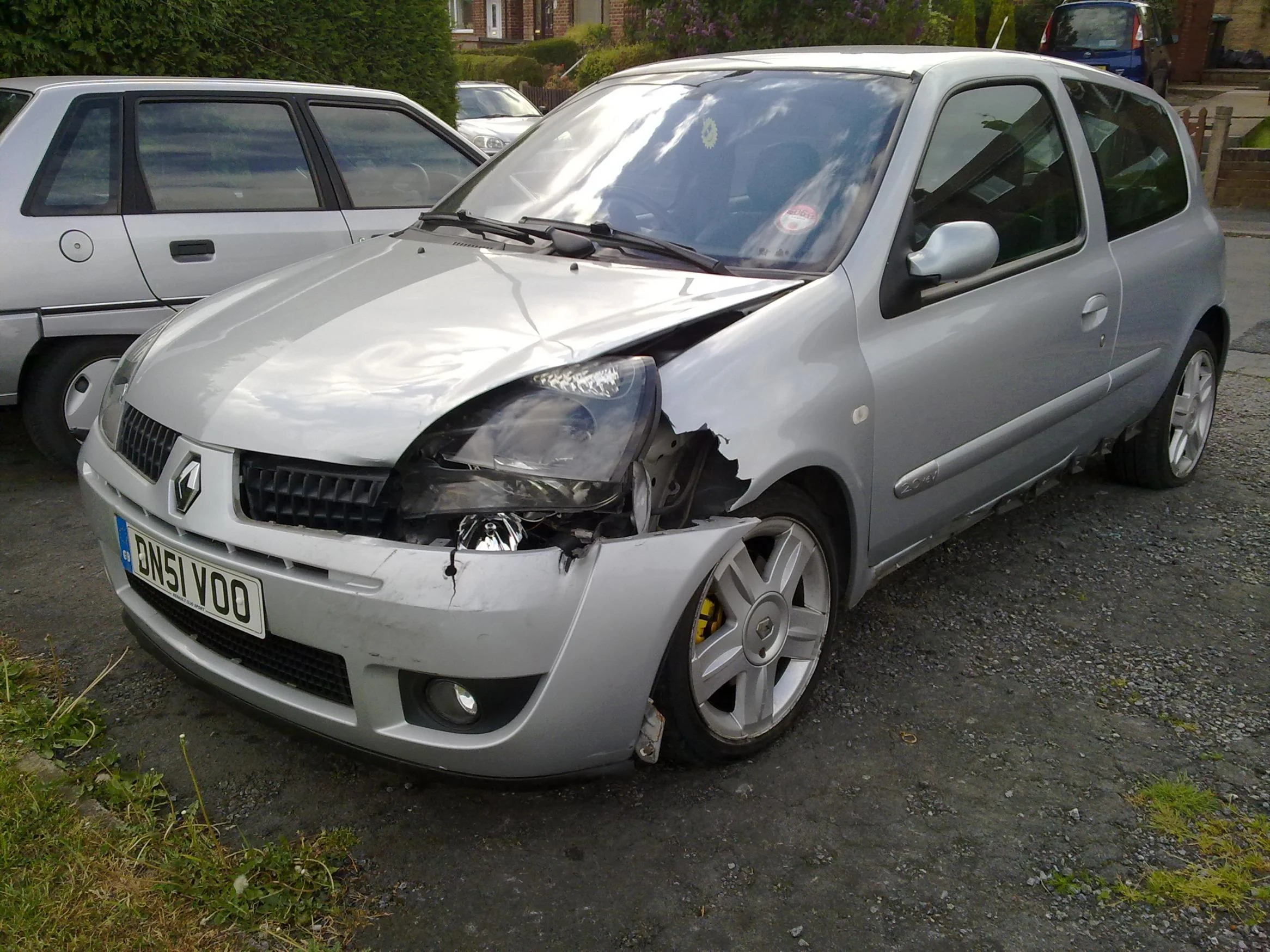

best one ive got where strips are visable. (the bullets arent on it anymore) i can try wood agaisnt a slight flush bit under where the bullets were, but the back ,i dont see where any wood would sit to get decent surface area.

If you have no bullets anymore, put a piece of wood against the flat edge where the bullet would end and meet the strip. Sharp tap and they should come off.
It really is very easy :)
aye thats what i said about the fronts atleast theres a slight lip , just the rears really ,theres no decent surface area at all. shall give it another go tommorow anyhow. thanks people

On the front ones, if theres no bullets, you can get a bit of wood and tap them backwards, sorted.
The rear ones, get the palm of your hand on the strip, closest to the back of the car. pull back 6 inches.... FIRE! Aim in towards the car and forward at the same time. They'll come off.

yea im begining to wonder if theyve been glued. ill try the wood buisness as best i can tommorow anyway, see how i get on.
