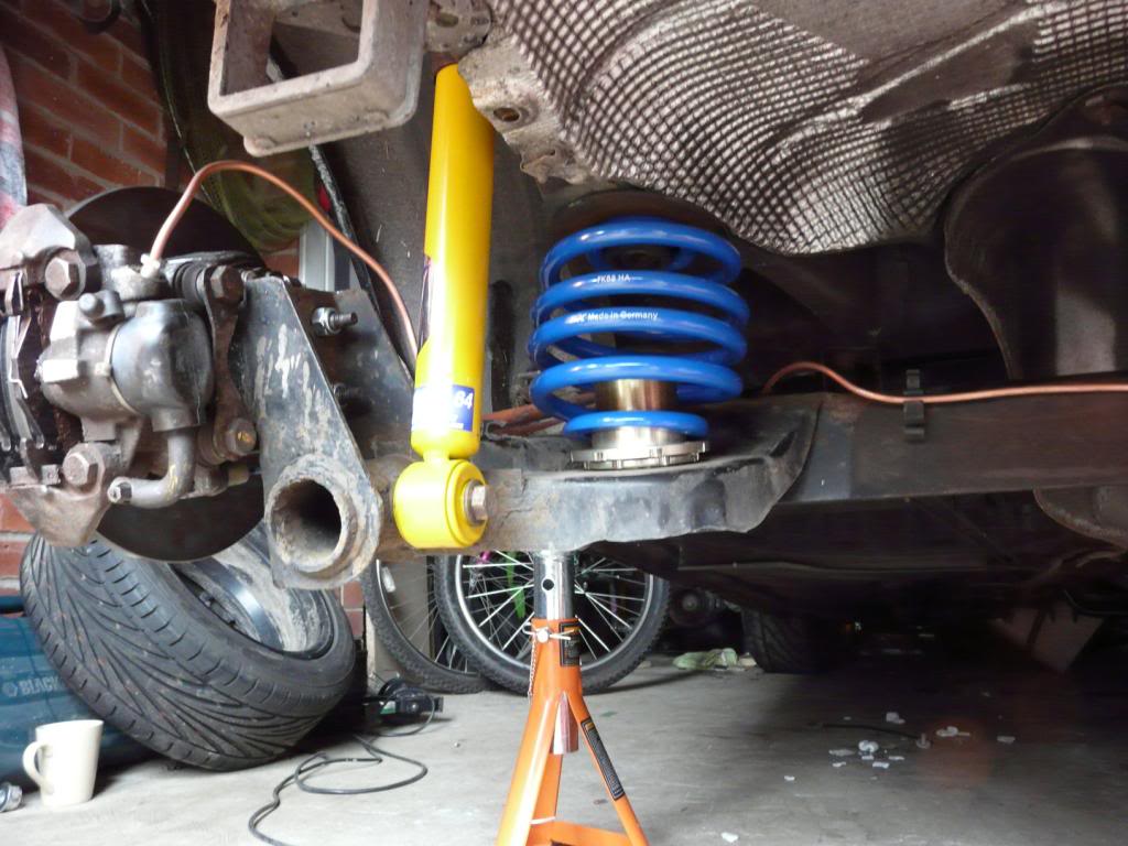

Anyone took there rear adjuster out to make it lower. If so how does the spring sit once you have unbolted it and removed the adjuster, surely the spring wont sit properly.

I think he means the ring on the rear coilovers that you wind to make it lower and higher on the platform.
You can take the adjustor rings off but not the actual thing that bolts onto the beam

yea on about them i hear people take the adjusters of to make it that lil bit more lower heard to unbolt the whole lot and put the old rubber spring bit back on them the spring back on is this correct and safe

Just take the adjusting collar off the thread. Do not unbolt the piece with the thread on, your spring could fall out if you did.

spoke to 1 lad on here who just has the spring sat there on the old rubber mount and said its fine bene like it for a year. :S iv just removed the whole lot and done what he said hope its ok

I had mine removed from my kw's but it was knocking over bumps so I got scared the spring was going to come out on track so put them back in. You could make up clamps to make sure they didn't come out but I didn't.

I may just put the thread collar bit back in without the winder at least it wont go nowhere dnt want it coming out
