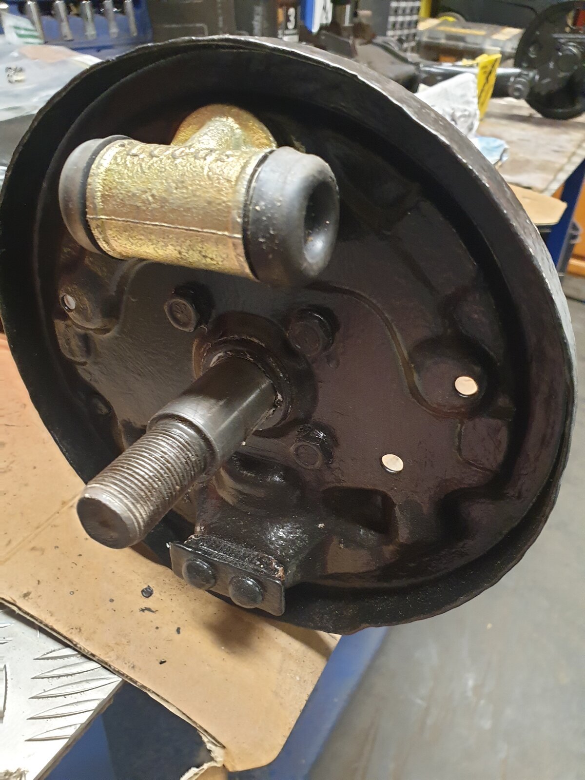

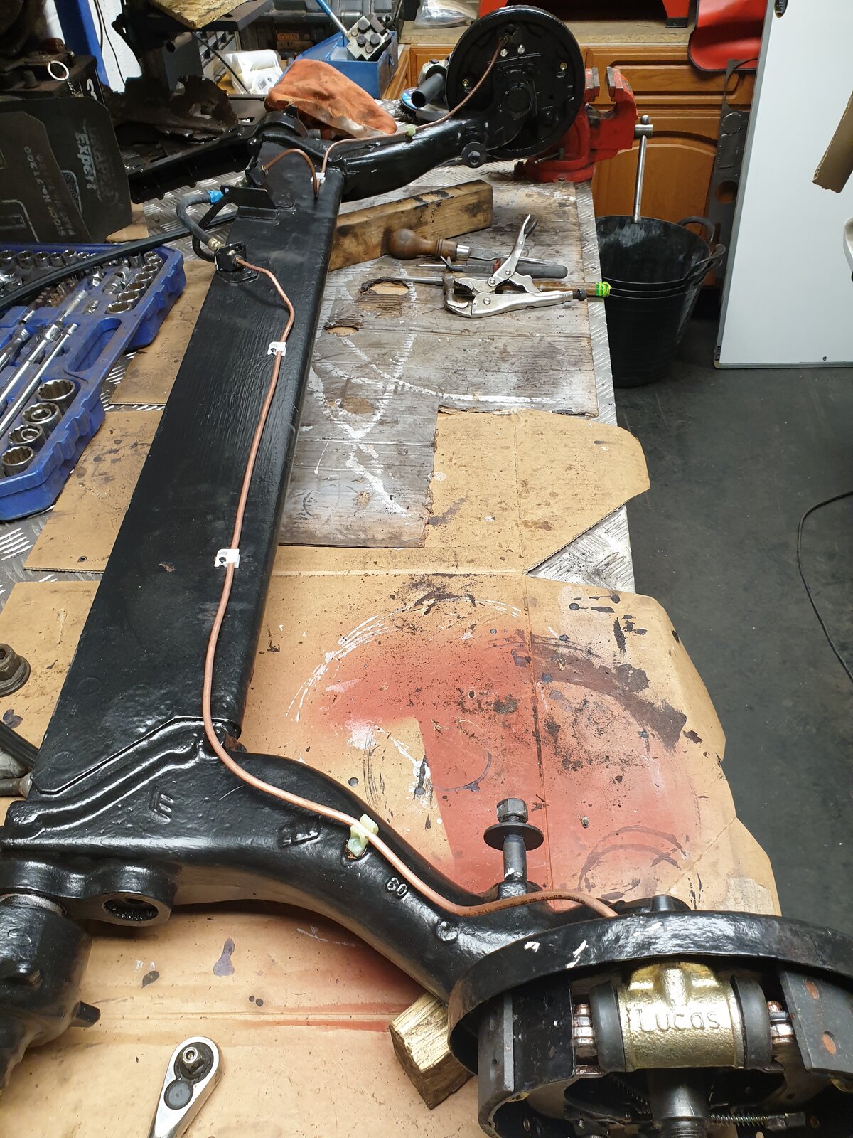

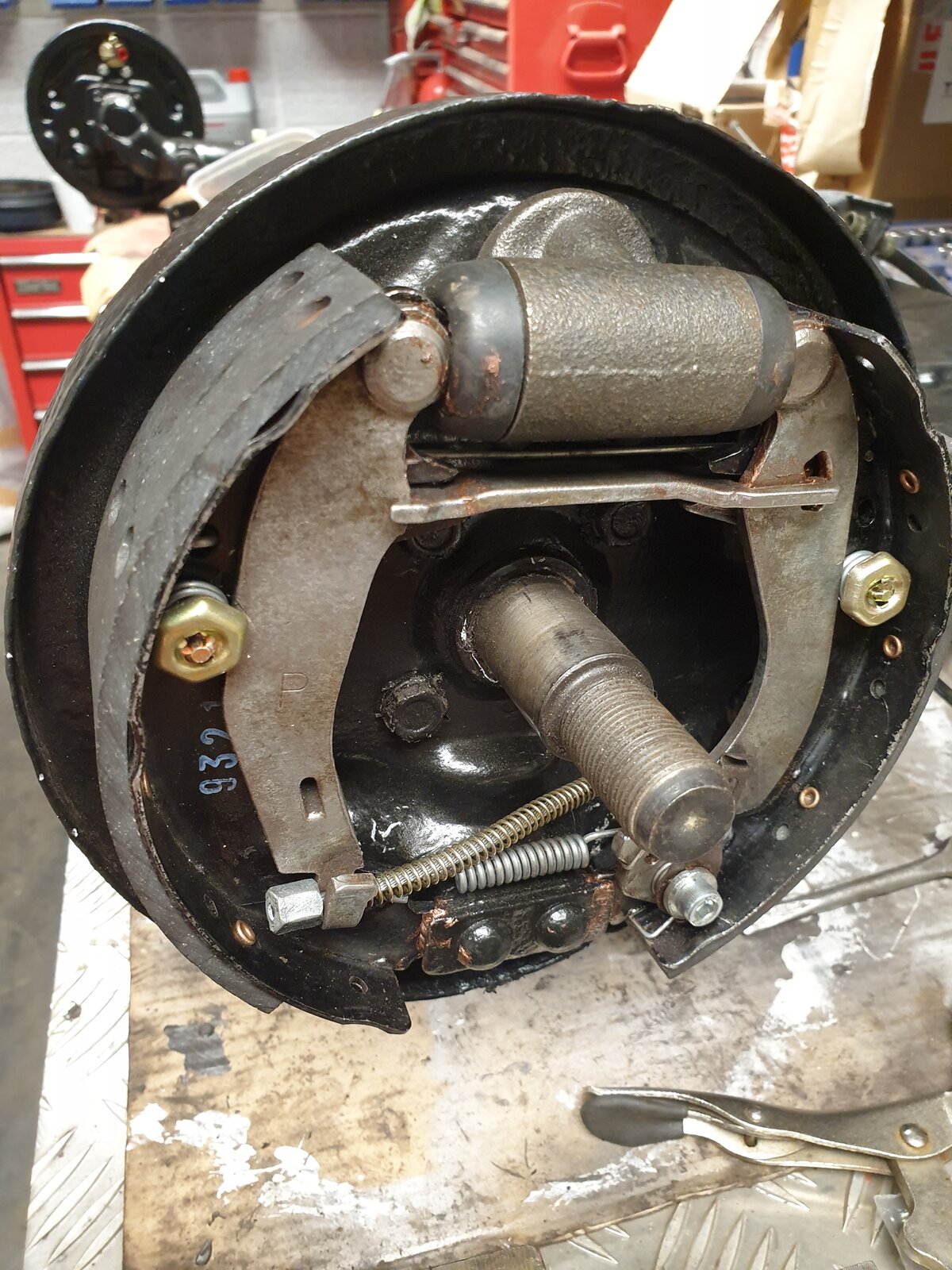

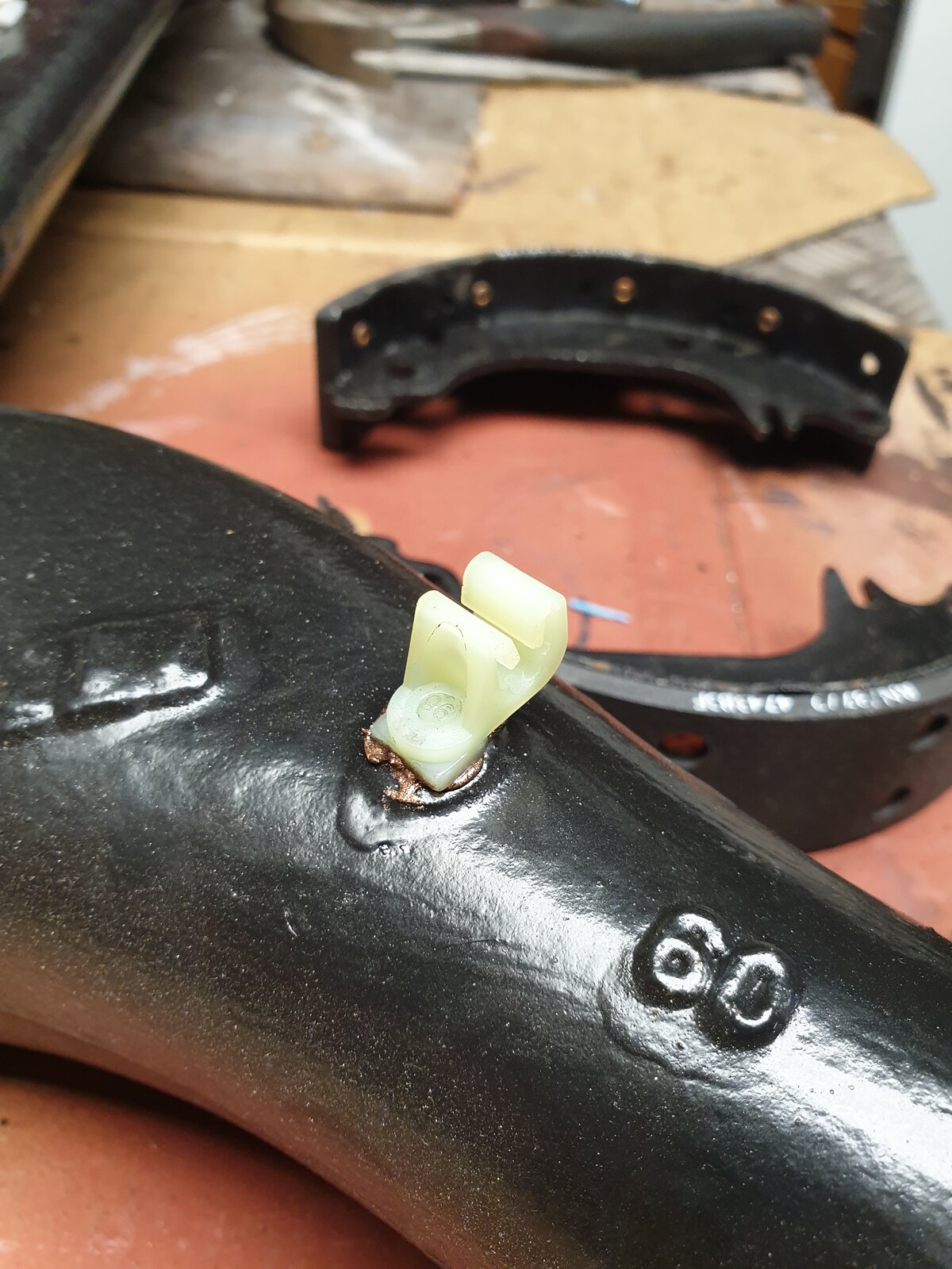

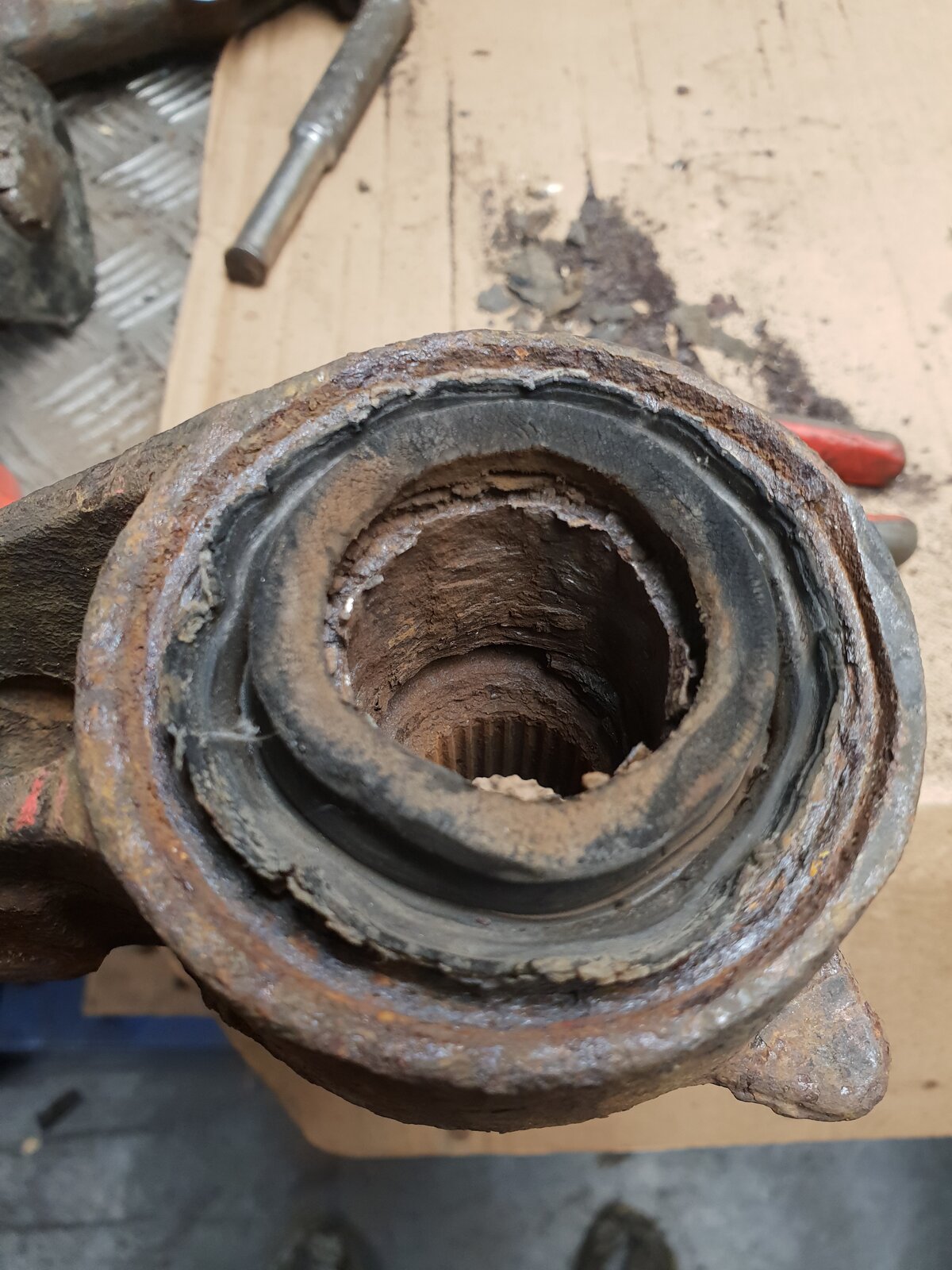

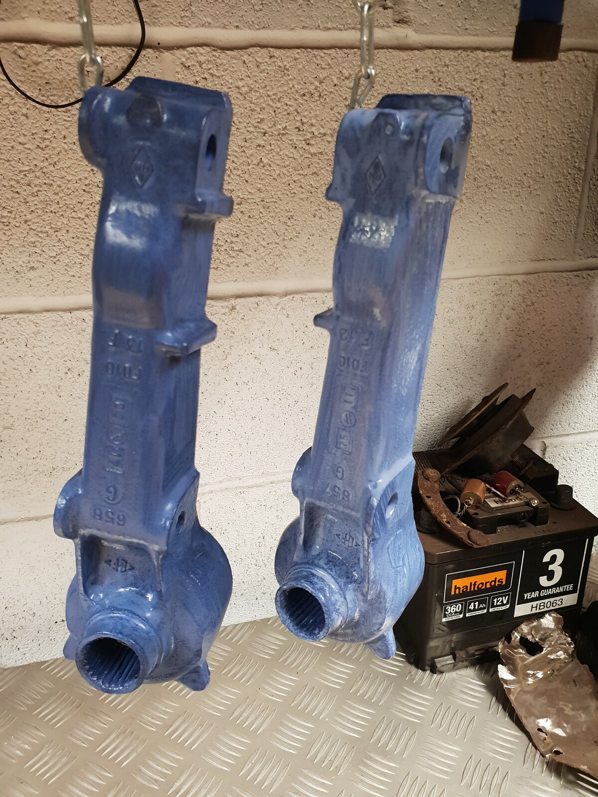

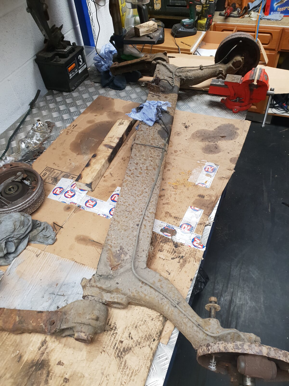

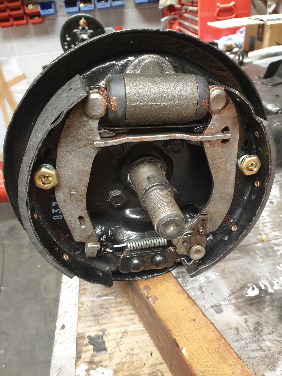

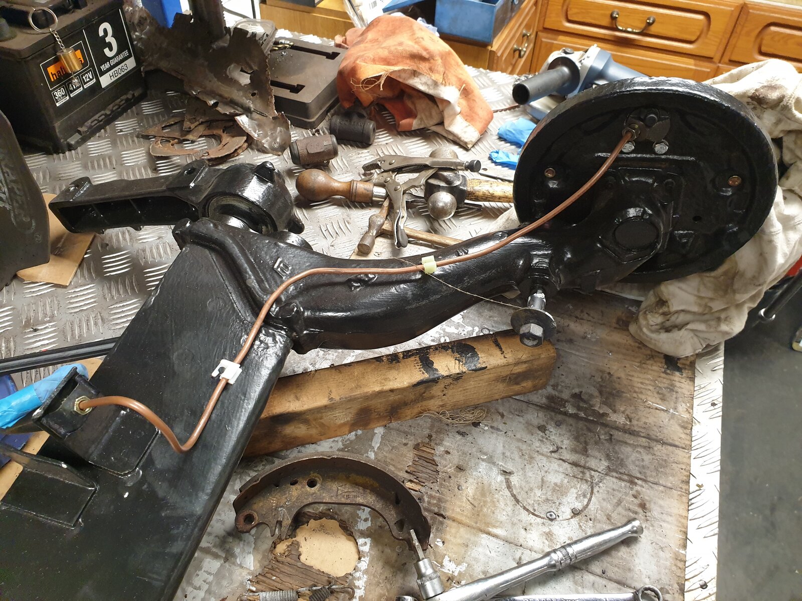

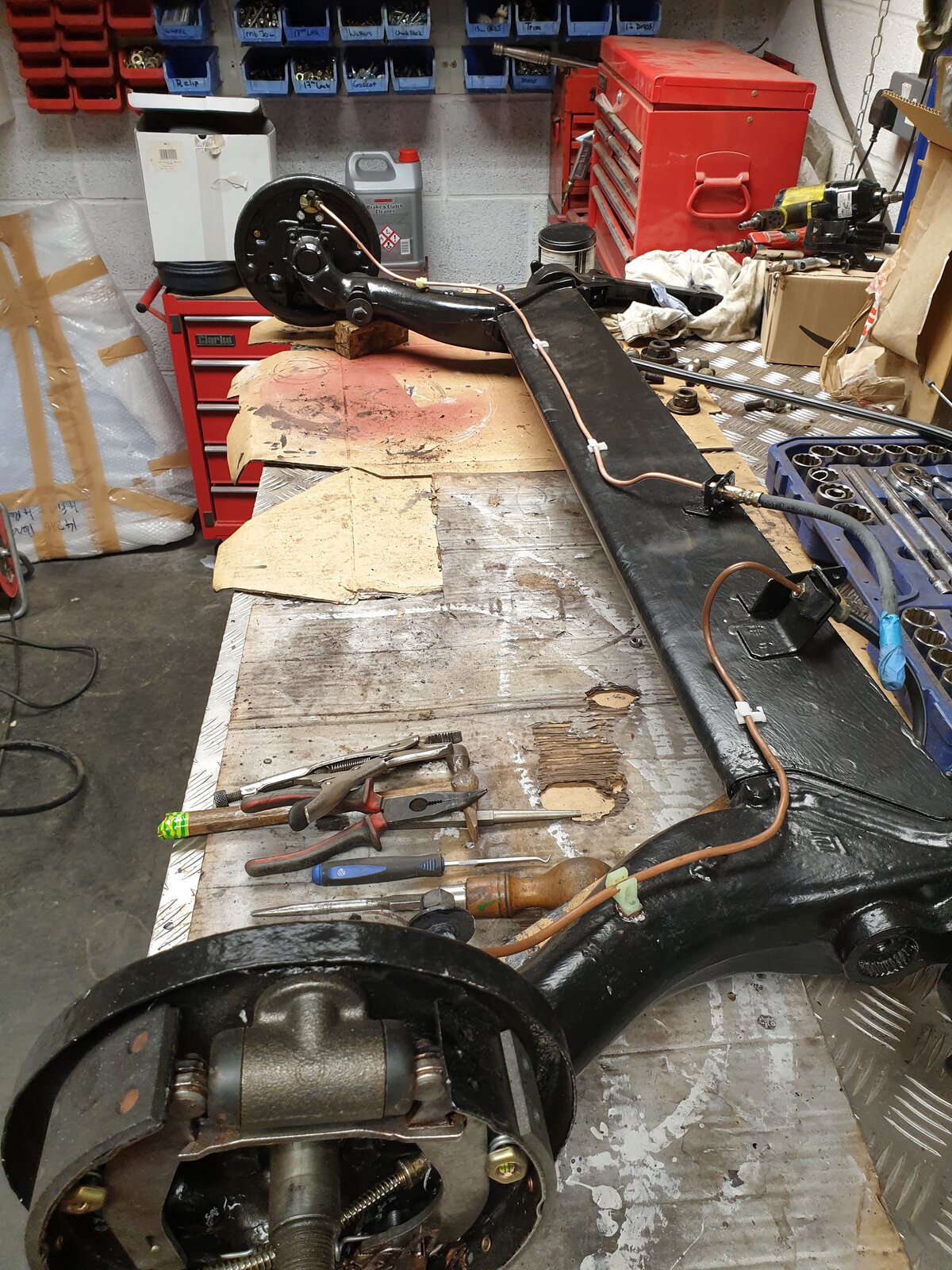

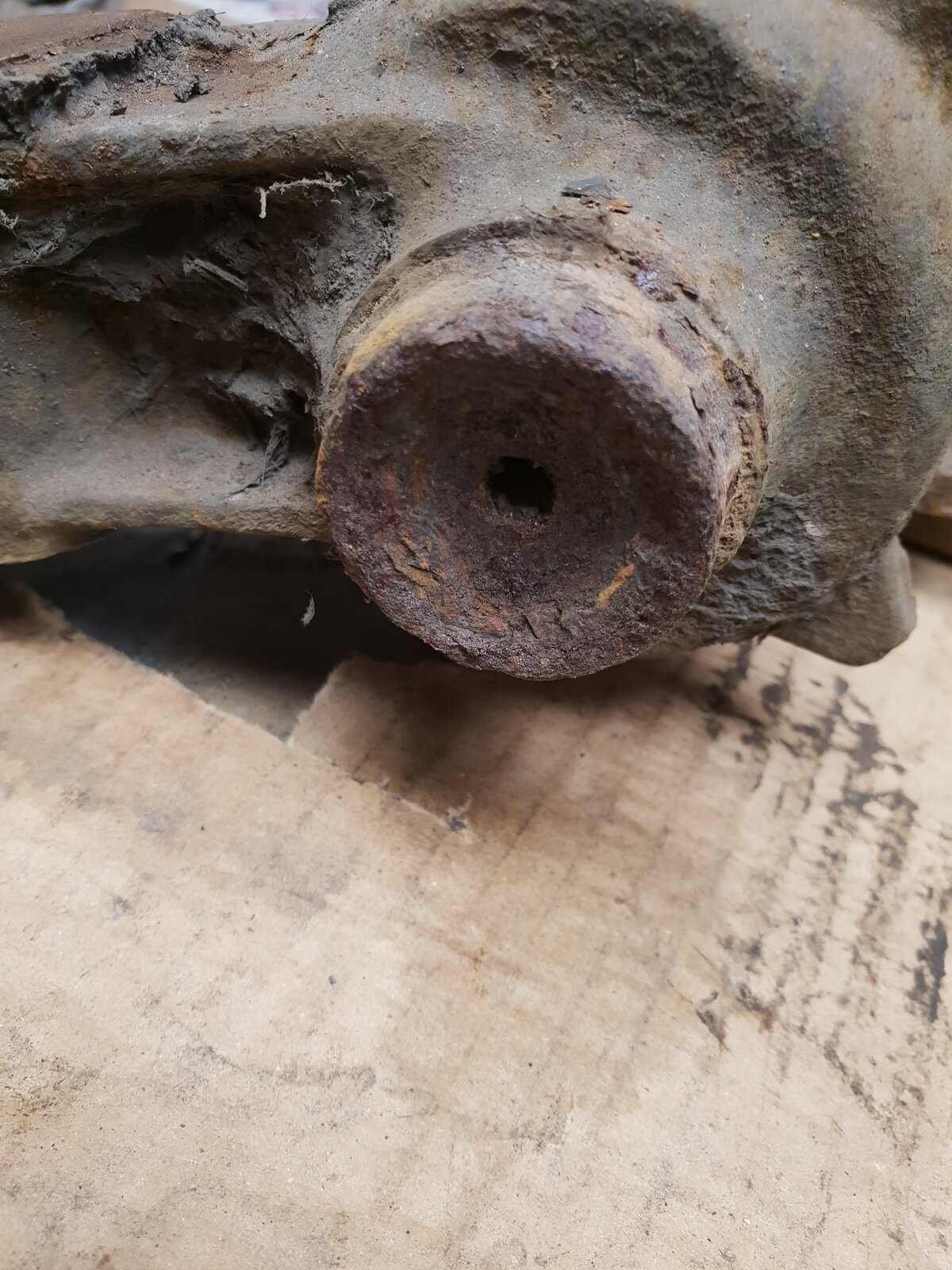

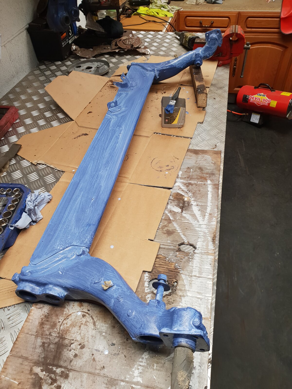

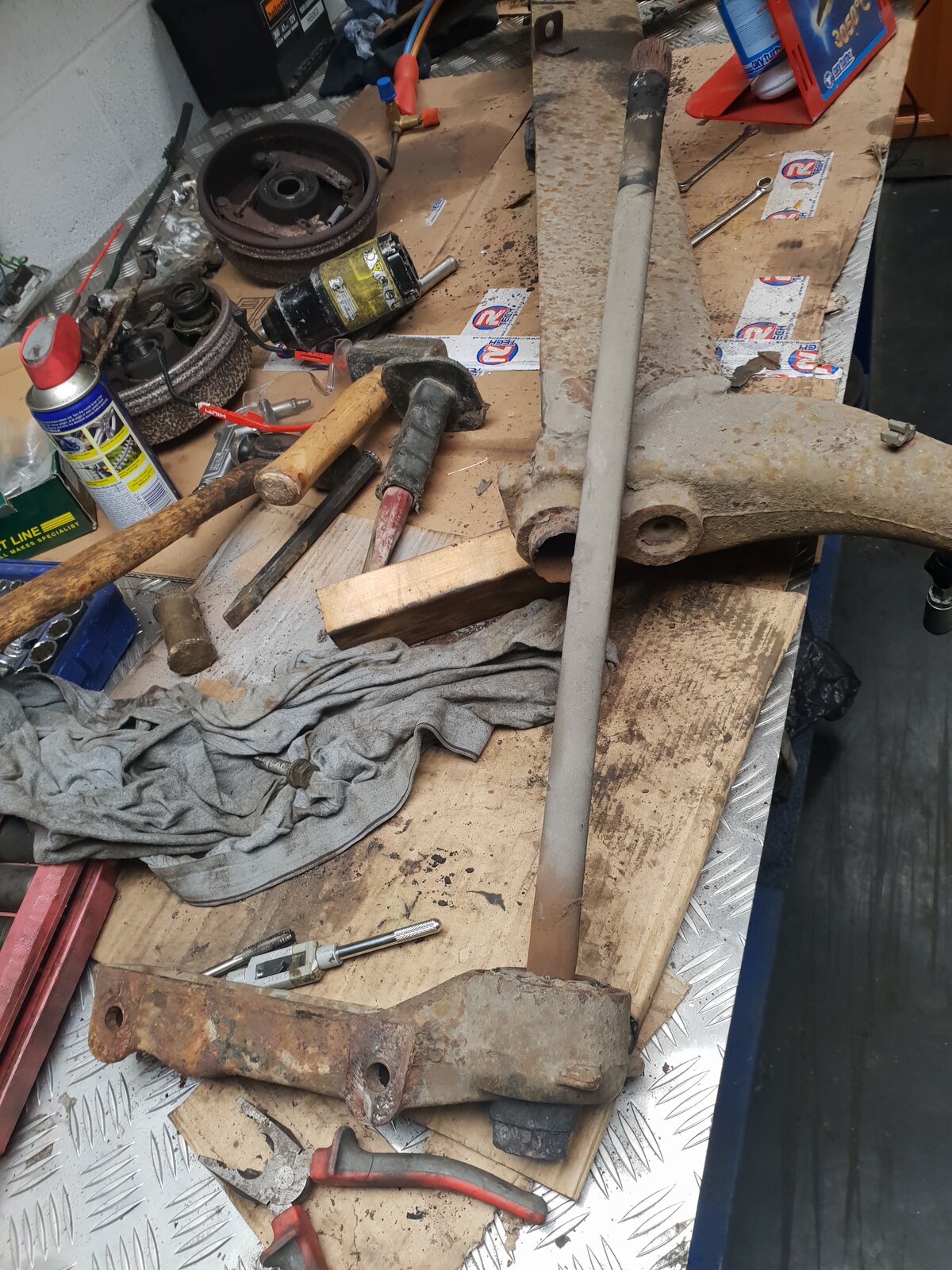

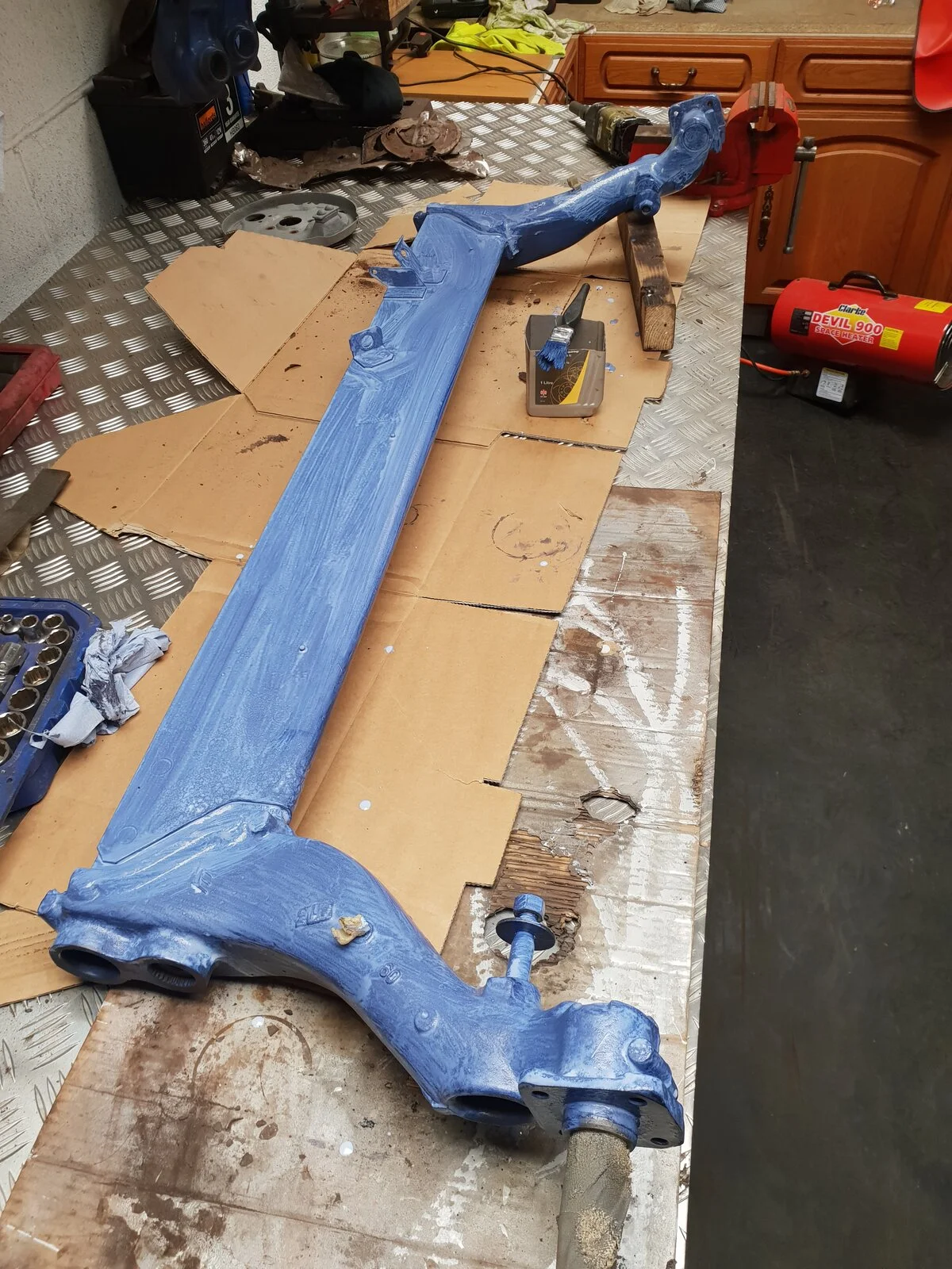

I did my own, not a Clio but similar trailing arm setup.
I used parts off the web, a local blaster to sand blast the parts and hand painted it with Bilt Hamber Hydrate 80, then primer, then black metal paint.
Cost me about a hundred quid all told.
