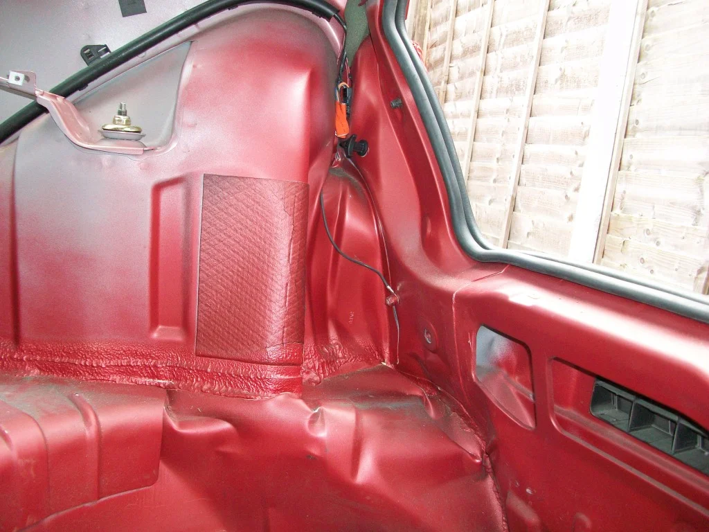

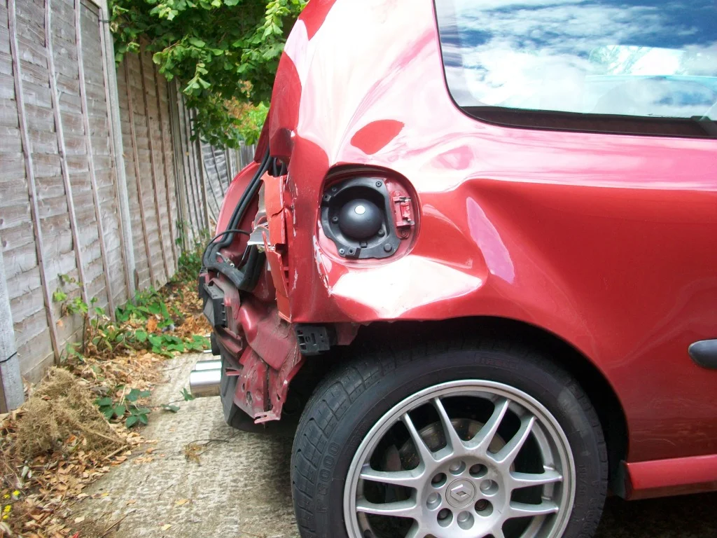

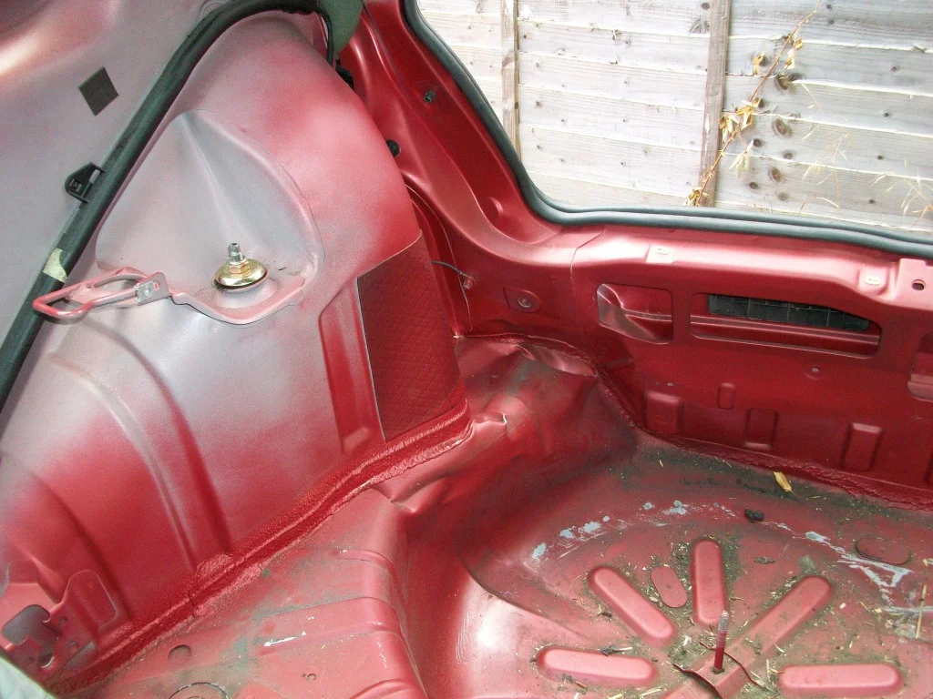

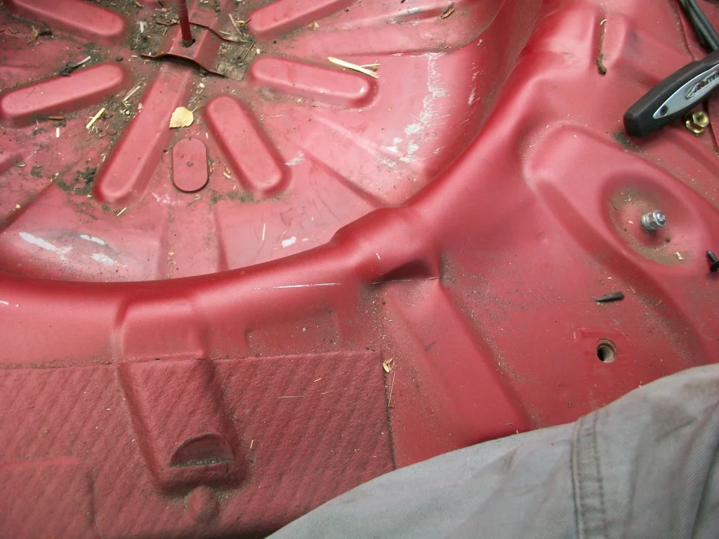

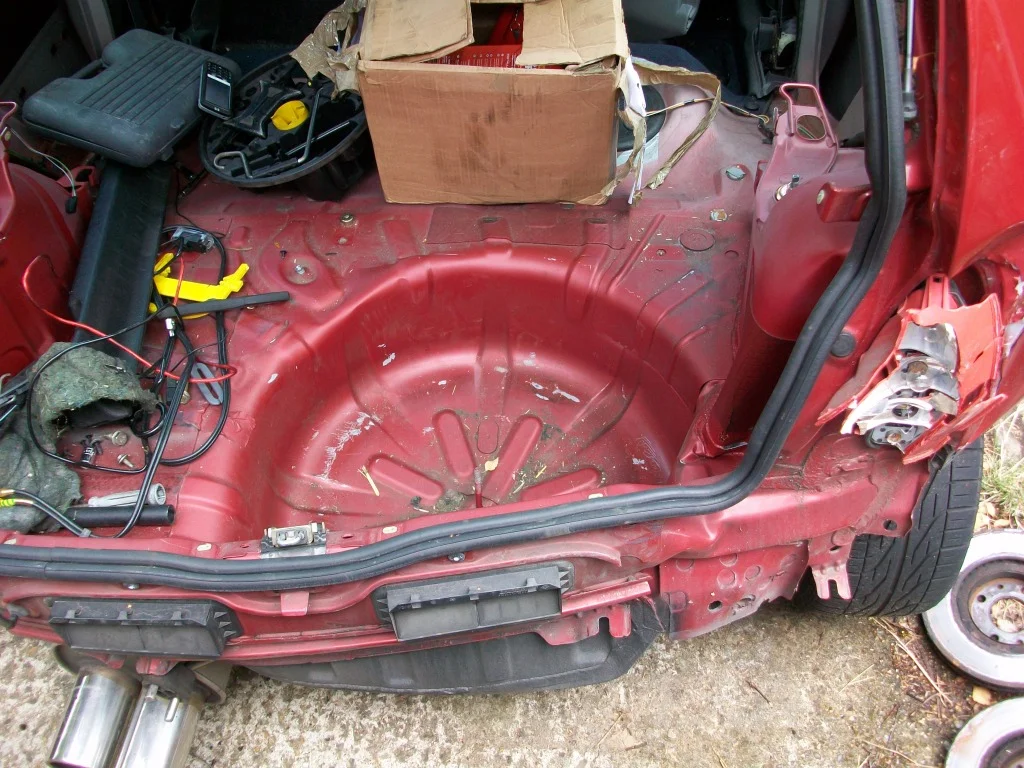

The other day while driving round a bend on track I lost the back, spun and hit a concrete wall - rear right hand side (drivers’ side). Bent the tailgate, broke the lights, and pushed the side in to the car a bit.
Anywho, today I've removed some of the inside of the car to have a proper look at the damage and was wondering if anyone knows if this could be repaired?? It seems a shame just to pull it apart but if it's not repairable that's what I'll probably do! :(
Here are some pictures: :dead:
Cheers guys!
I personally wouldn't be happy repairing that. Boot floor is creased and it would need a new quarter panel aswell
I wouldn't be repairing that.
Will need jigged to make sure the chassis etc is still straight, new boot floor, new back panel, new quarter panel, easily £2k+ of damage right there.
Cheers guys, was the information I was looking for! :)
I've not much idea when it comes to repairs but did think it was quite damaged but wanted to check.
