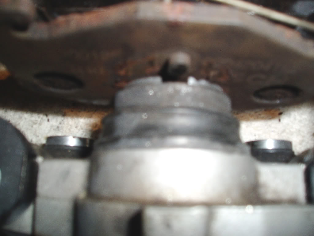

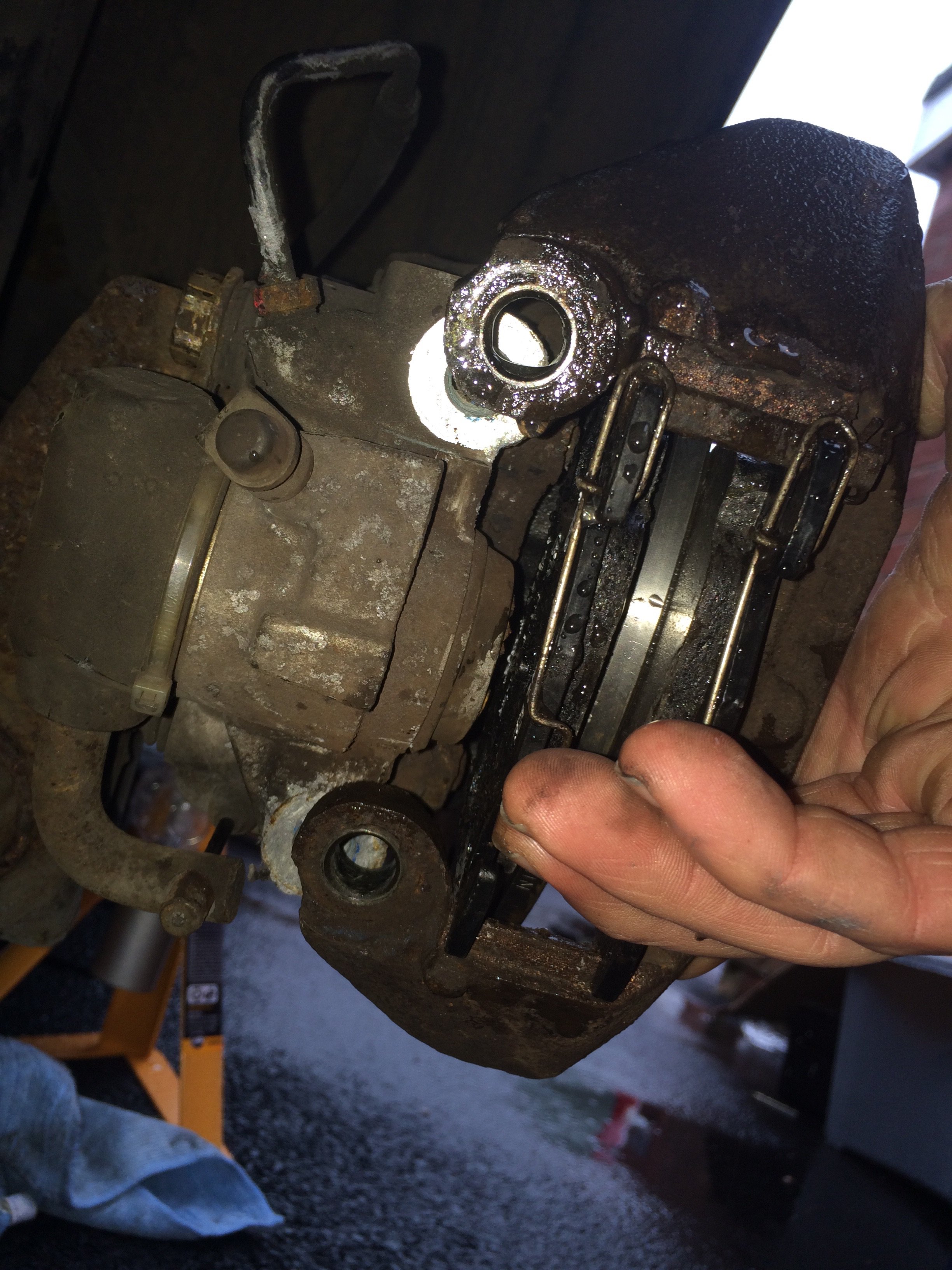

Just changed pads and discs on my 172...now the caliper won't align for the bolts....any ideas?

Take the pads out again , then bolt the pad carrier on . Make sure the piston is wound in enough to put the pads back in , clockwise direction . Use a screwdriver or small some square bar . Also make sure the piston is lined up properly so the notch lines up with the with the bit on the back of the new pad , or you'll never get it in .

Just tried it without the pads, the gap isn't big enough to slide the 'outer' pad into. It seems the outer pad is stopping the caliper going back far enough.
You've got it bolted back on , without the pads in is what you're saying ?There isn't much room to play with . You need to wind the piston right back into the caliper . It will actually go further in than the rubber dust boot . There's a guide here , but it's slightly wrong . There's no need to take off the pad carrier to change the pads . Also make sure the face on the bottom of the carrier , where the little " L " shaped holder thing ( i don't know the correct name for it ) and clean that too , remove any rust or s**t or it'll be hard to slide back in under the pads .
