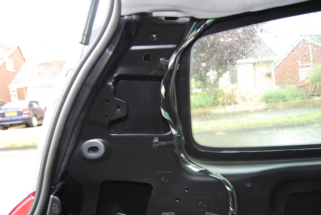

noob. ill take a look tomorrow! is the thing pretty obvious that you plug the resistors into then?
You can see the one hole from where the bolt went, you remove this and belt comes out.
This is the wire you are left with after removingt he belt, as you can see, i have just put the resistor into each side, and then i will tape it in.
As already mentioned, you could cut the wires, and solder them. But ive done it like this so i can easily put the belts back in.

cheers for putting that pic up then.
i haven't taken the panel off yet to have a look properly just trying to get all the ideas together at once then go and do it all! where does that white plug sit? and is it on all three rear seat belts?
Just two mate, doesnt have one on the belt for the middle passenger.
The two wires are attached to the back of the pretensioners, you cant miss them as you have to unplug them to remove the belts etc.

Those rear ones dont look anthing like mine........
+1
i did mine on sunday, and there were definatly a wire going in between the loom and the pretensioner. its a white clip that has to be unplugged. mine had a purple wire going from the pretensioner too if thats any help.
