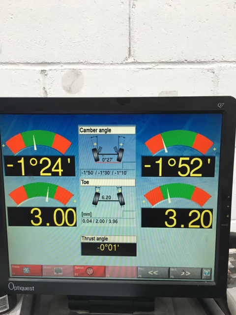

So, my car had toe in ... 3mm each side :

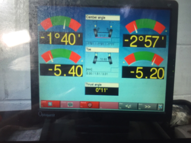

I've now added 60mins shim to the rear to create toe out... This is what I wanted to achieve, I like the car to be loose(r) however, I'm racing at Brands on Sat and thinking I might have taken it too far.. Is it??
Any comments ?? What are racers doing in regards to their toe out??

I think it will make the back end a bit too lively.
Did you try anything else set-up wise before adjusting the rear toe?

No, not really ... I've always had toe out ... Last 20mins ? But I can't find what 20mins = ??mm
