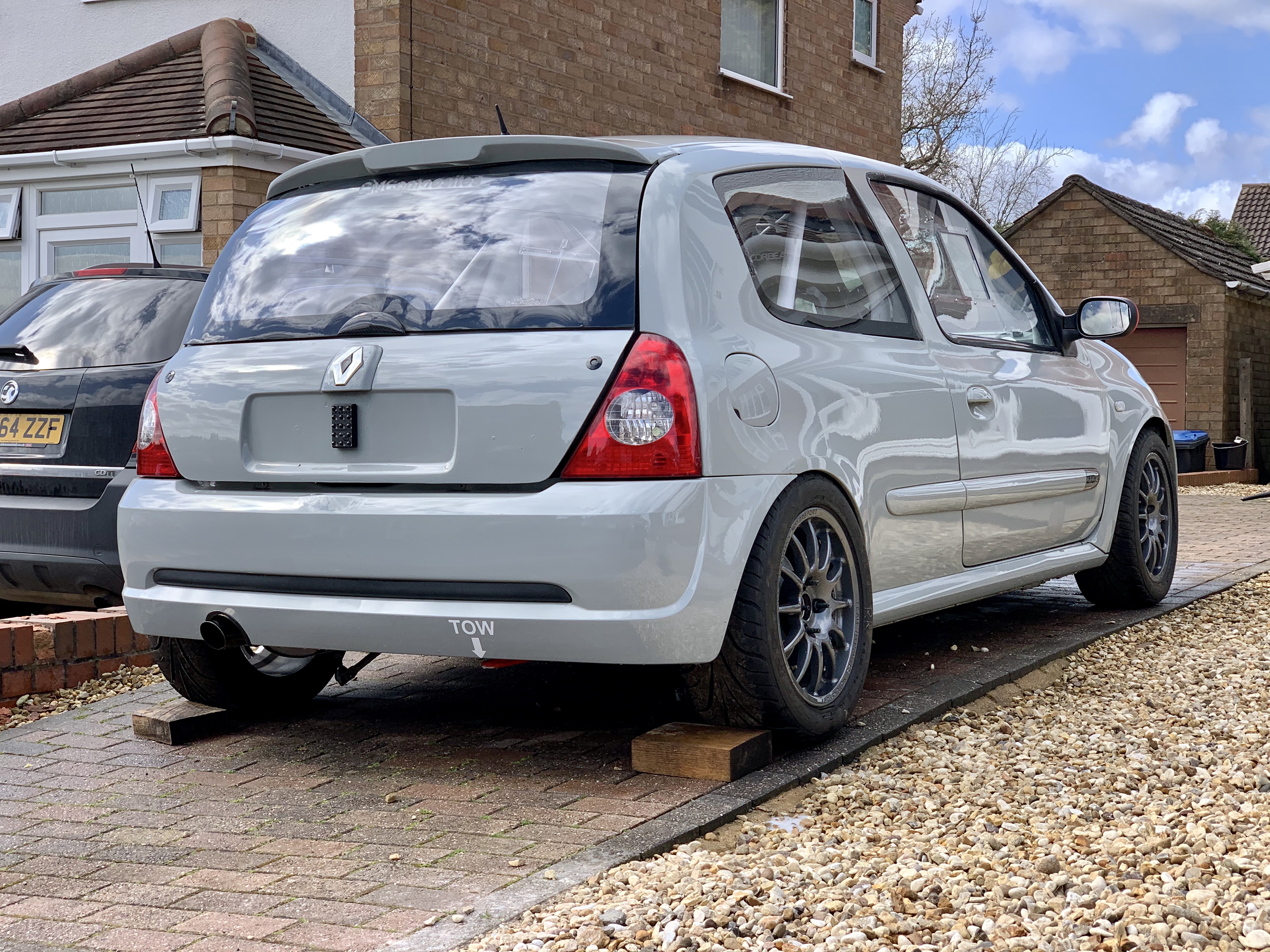

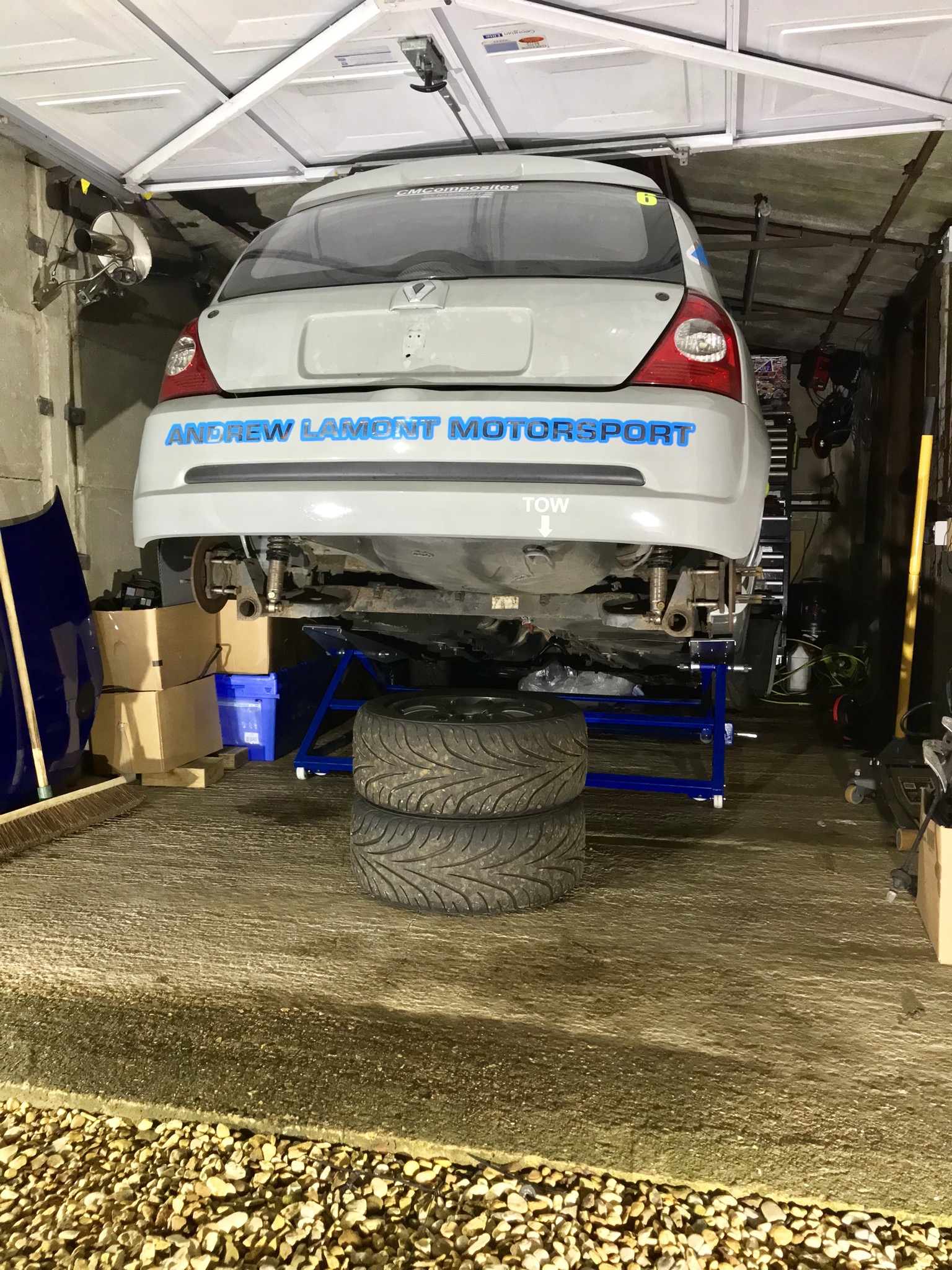

Will have a standard tow eye. Picture below of mine 172. I’ve painted mine red to be visible

I think im going to paint my rear tow hook red after seeing this. Would you also mind sharing your wheel/tyre/spacer specs? Fitment on the rear looks spot on.
Thanks mate.
Running Puremotorsport billet stub axle kit/twingo disc setup with puremotorsport 10mm stub axle spacer and 7x15 et35 wheels with 205 595RSR tyres

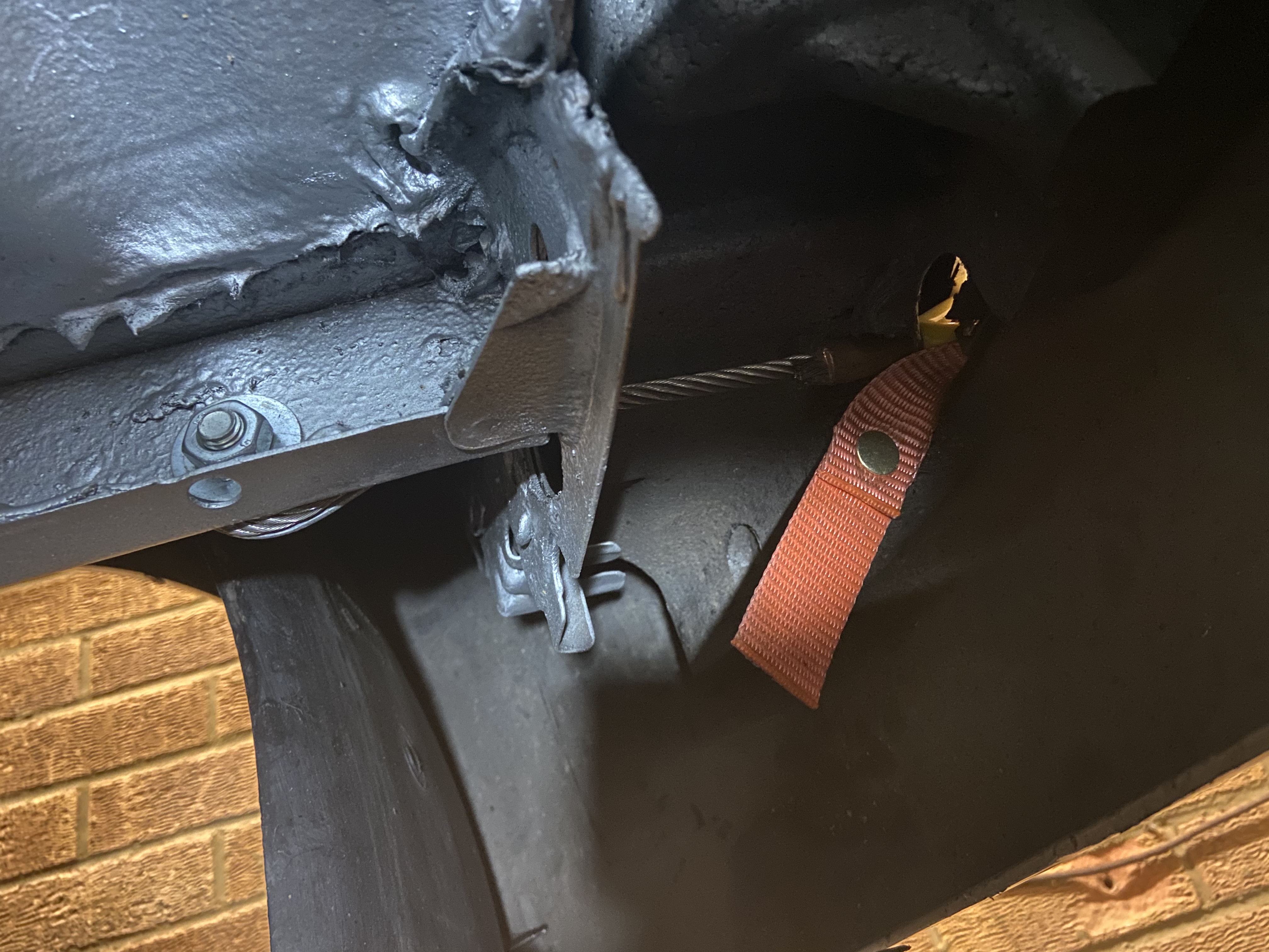

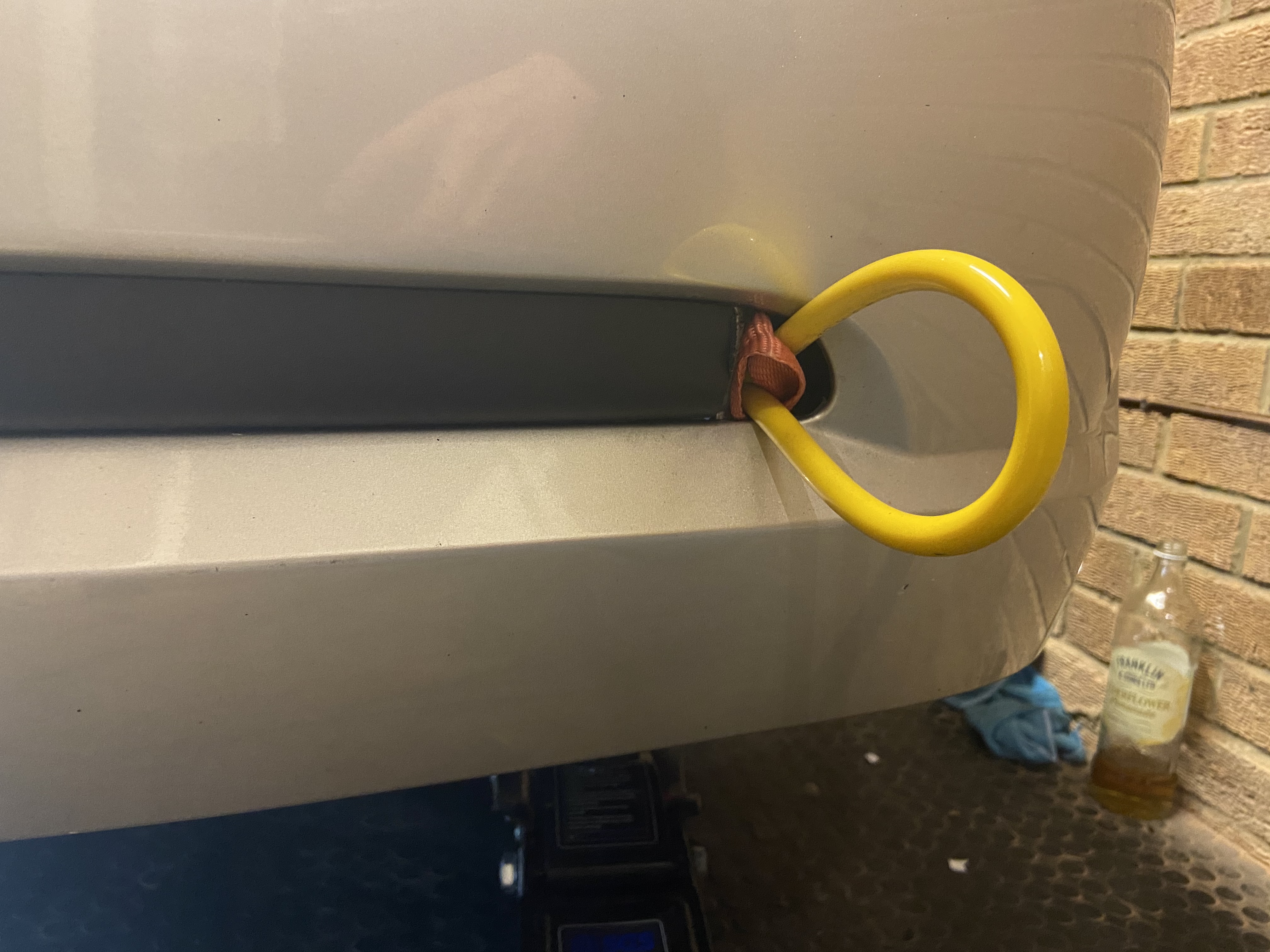

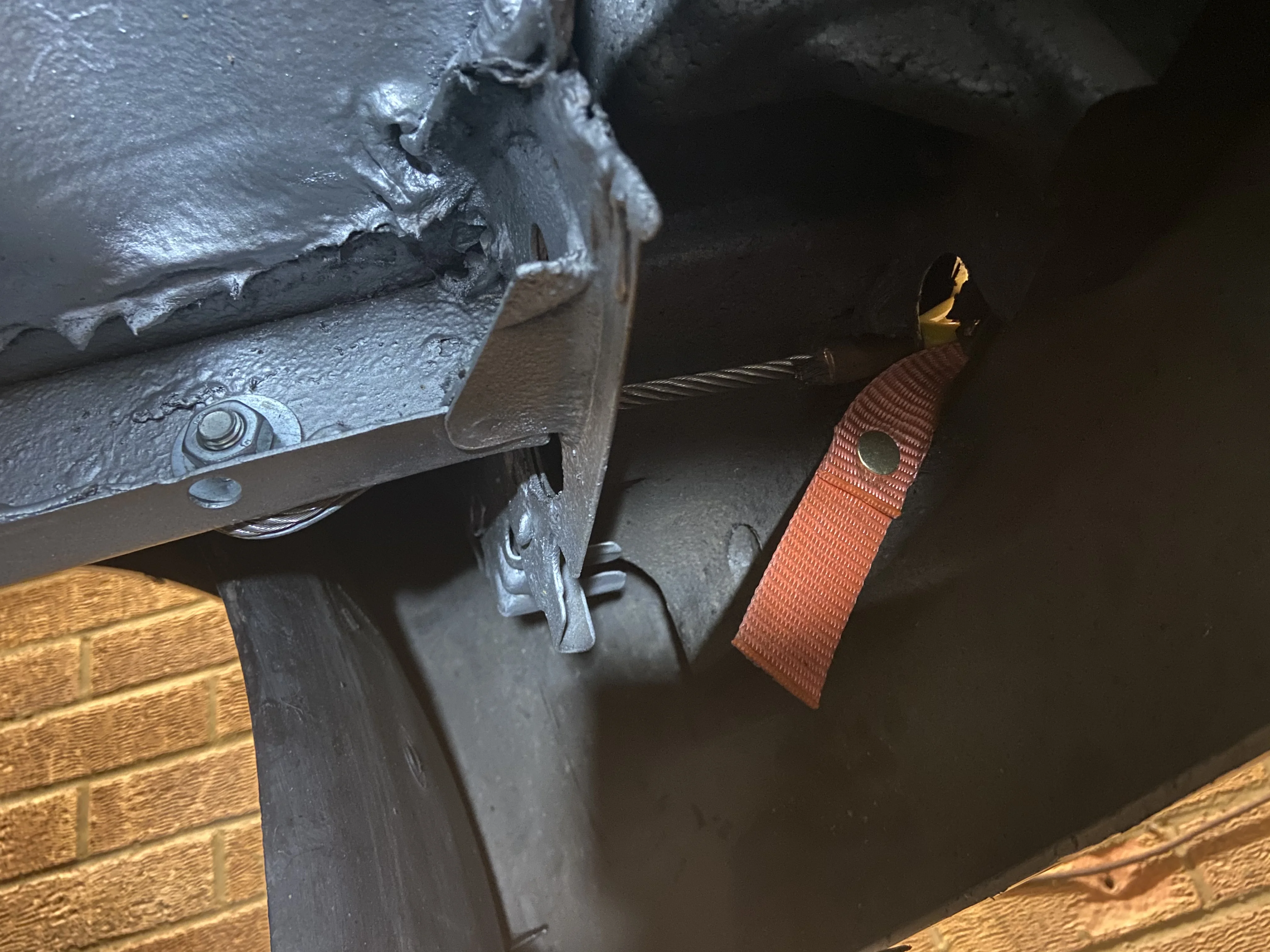

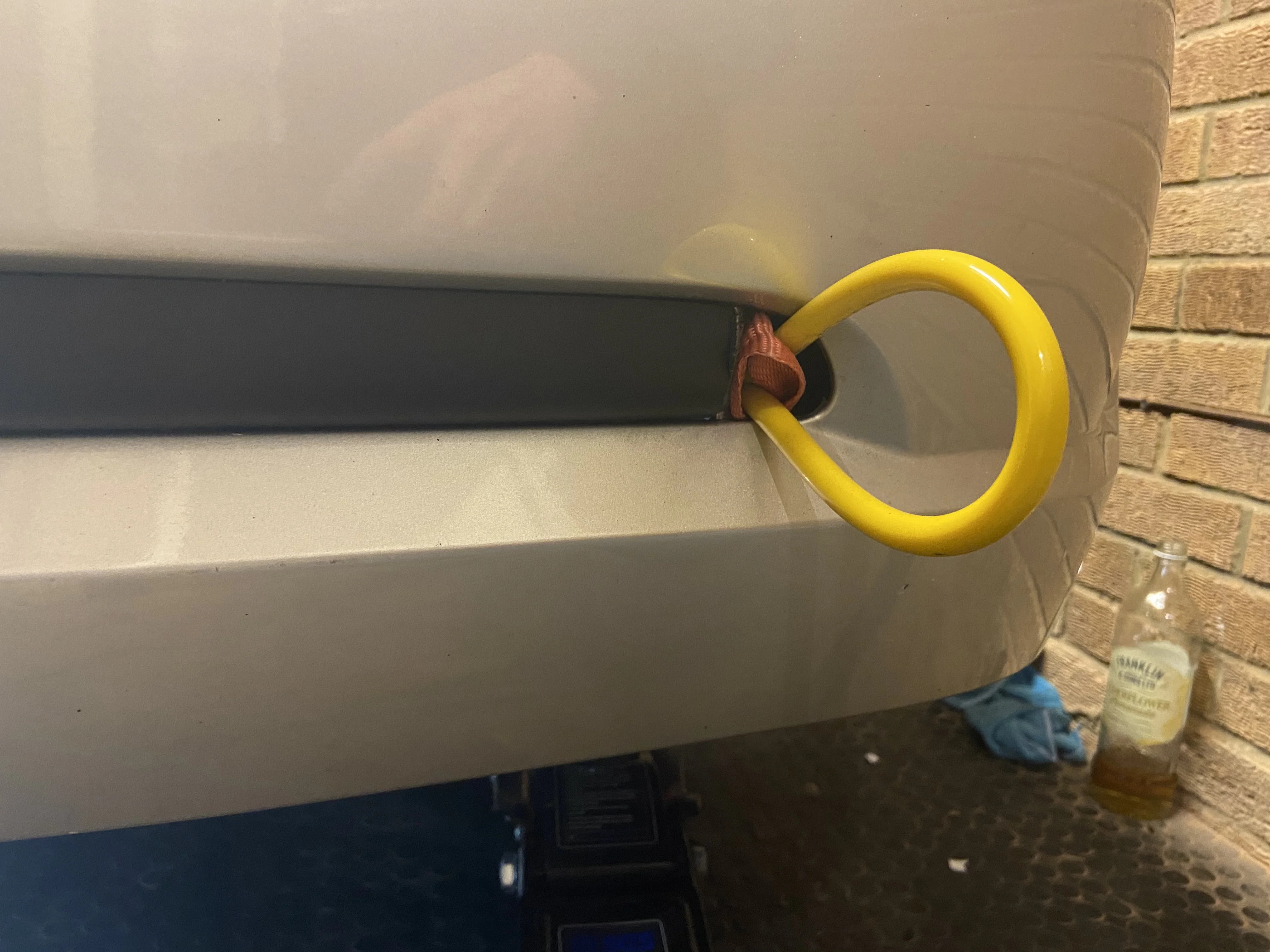

Don’t know if this is an option. I only had to cut a couple of mm off of the black trim. Can always get a second piece of trim and push the tow loop through it if you don’t want to see it when it’s not in use?
Smart solution that for race series that require them.

The cup racers were like this but with a solid tow eye, the wire rope towing eyes are a neat solution also but they wreck the bumper unless you are pulling the car directly from behind when recovering.
Aren't the wire rope ones mandatory now though (for racing)?
