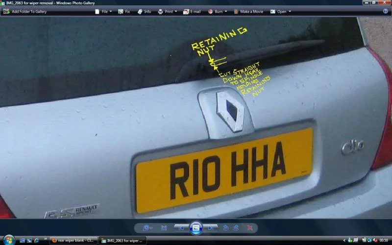

If the wiper arm won't remove cant you cut the plastic body with a hacksaw down to the spindle.
Therefore you can remove the wiper motor from removing the retaining nuts inside although the wiper arm is ready for the bin. :(
Or have a taken the problem your having the wrong way ?

I think i get what you mean (whilst trying to visualise it in my head) lol. I'll have a look at the weekend. The wiper's worn so needs sorting anyway.
cheers.
I couldn't get the text to work in paint so had to use straight lines as text.
Lol
The realised it was too small when i saved it to make out what i wrote so i had to open and zoom in then do a screen print.
I hope it makes sense.
